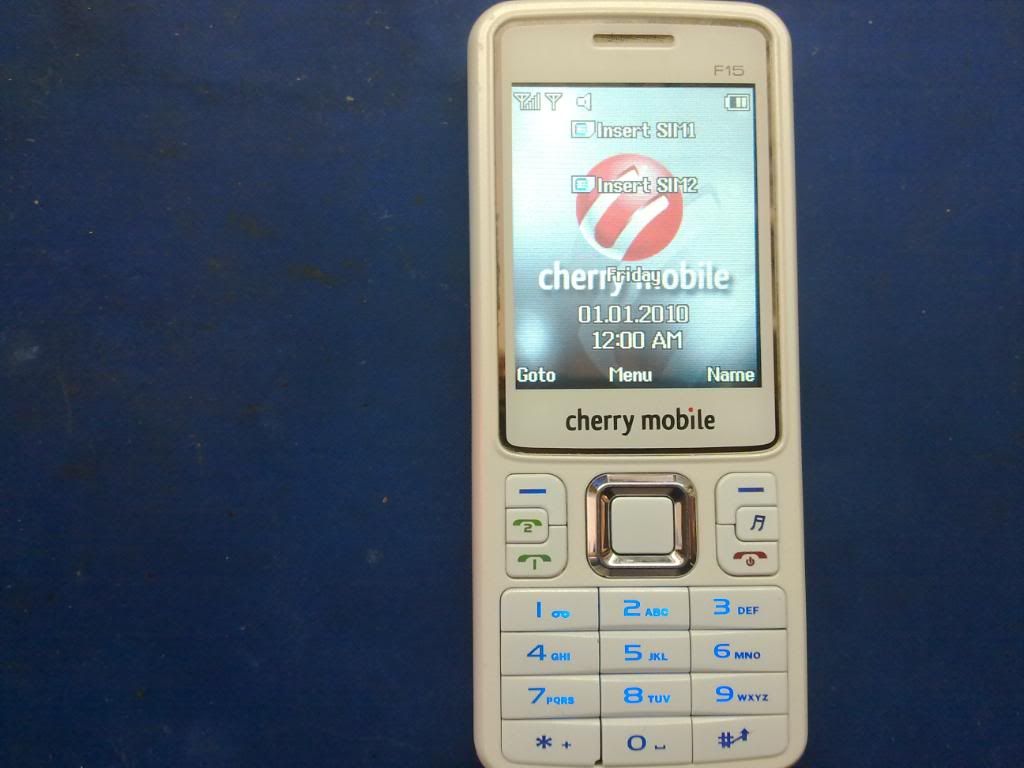

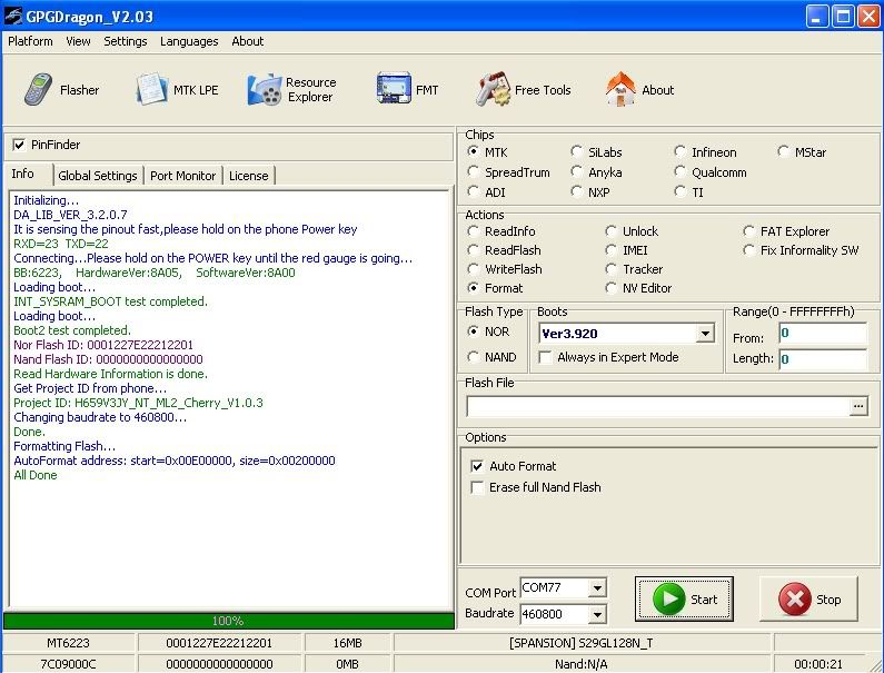

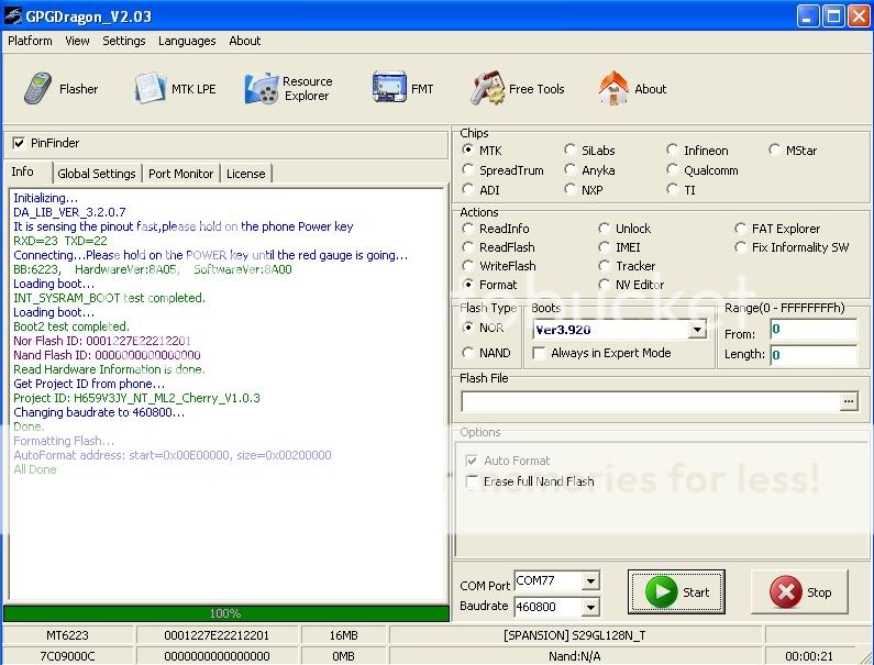

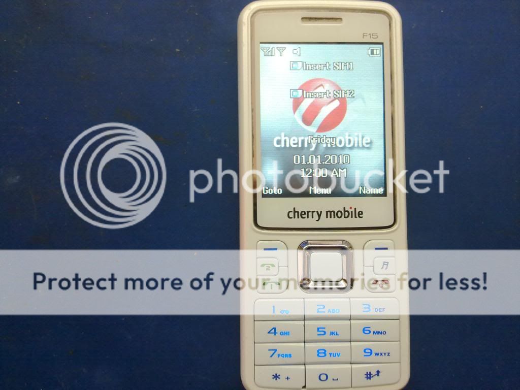

Cherry mobile [F15] MTK chip
status deadset!
Done via format:
here:
unit:
Working!

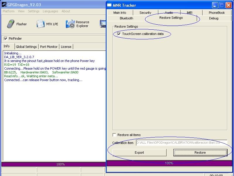

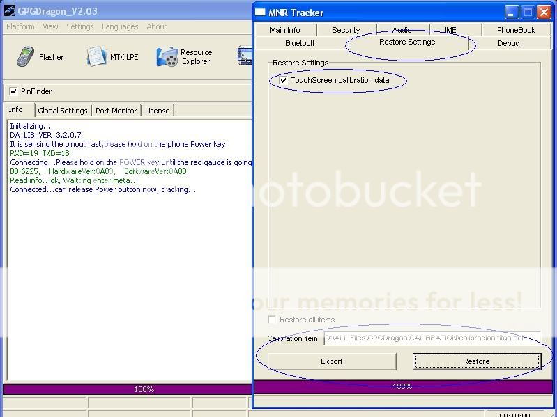

C8000+ MTK chip
Calibration on screen
Done via calibrate
Calibration manual for MTK chips
1-Make info
2-Make back-up just incase
3-Do format
4-Tracker
5-Do calibrate with provided files
6-All done
Here:
