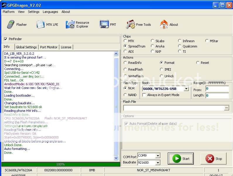

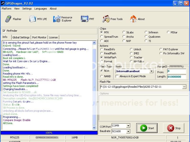

AGTEL Music player problem successfully repaired with GPG Dragon!! Spiderman had failed to format this phone.
1.Connected with the box
Uploaded with ImageShack.us
2.Read flash file.
3.formate phone with selecting auto format.

NKTEL A200 Flash Done Initializing...
DA_LIB_VER_3.2.0.2
RXD=5 TXD=10
Loading boot...
Loading boot...
Boot2 test completed.
Nor Flash ID: 0098000300000000
Get Project ID from phone...
Project ID: N66_ABROAD_2CDGB_S5_TM_V4.0.2
Done.
Analyzing the UID-Encryption info, Some file may need a long time...
Decryption complete. Key[B234D95C125E7BE4]-B9
Downloading Flash file...
All Done.

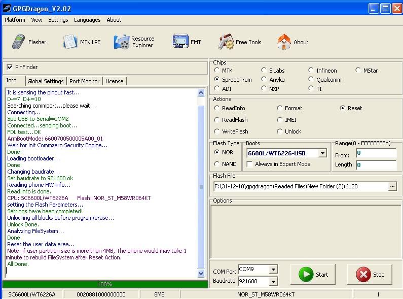

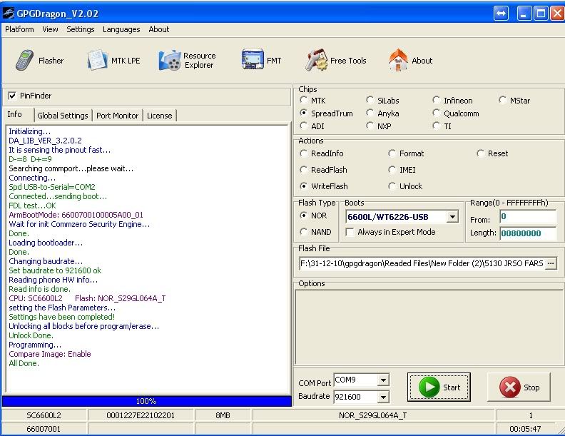

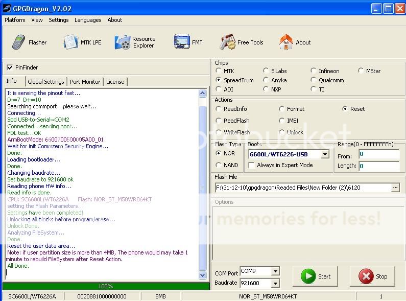

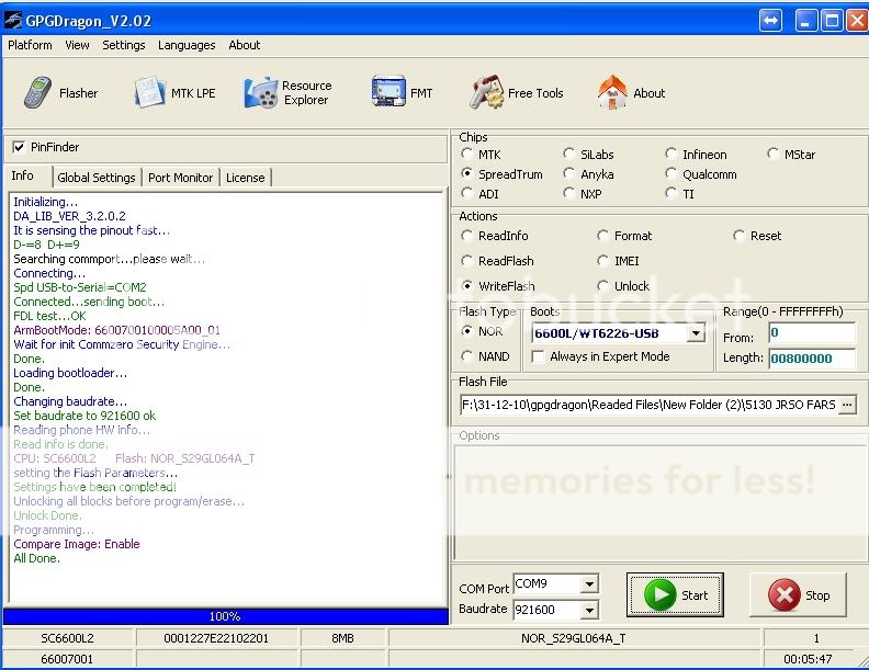

ZTC 6120 Reset
A200 Flash
5130 Flash
6120 Formate
Jonab Ru
Super Moderator
Feb 3, 2011
1,838
6
Initializing...
DA_LIB_VER_3.2.0.2
RXD=4 TXD=5
Loading boot...
Loading boot...
Project ID: B017.T3T4.GFIVE.V05.L08.02
Done.
Formatting Flash...
All Done

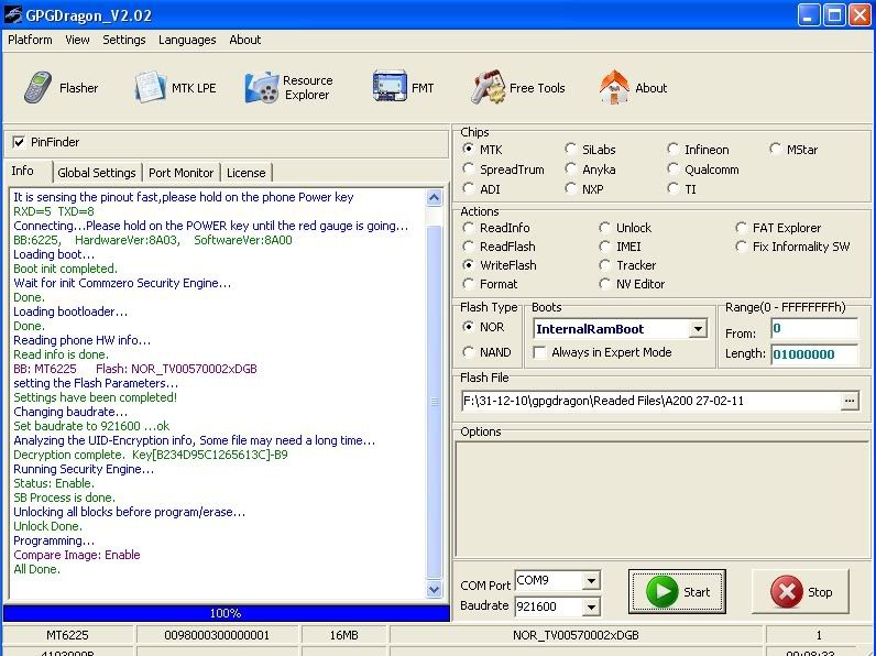

Cherry mobile, model meteor! MTK chip
Phils brand of Cellular
status can't power on
Done via Format
here:
