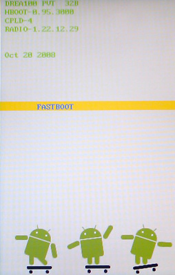

Fastboot Guide
What is Fastboot?
Fastboot is a command line tool used to directly flash the filesystem in Android devices from a host via USB. It allows flashing of unsigned partition images. It is disabled in most production devices since USB support has been disabled in the bootloader. In order to use Fastboot, you must have an unlocked bootloader or an Engineering SPL
Pre-requisites
- You must have ADB drivers installed for your device. Some devices have fastboot specific drivers too, so Google that for your device.
- Fastboot package, available [Only Registered and Activated Users Can See Links. Click Here To Register...].
Typical Partition Layout
recovery
N/A
A 'backup' kernel, initrd, and OS
for system recovery / maintenance
mtdblock1
Can flash custom recovery.img (Amon_Ra, ClockworkMod, etc).
boot
boot.img
The main kernel and ramdisk
mtdblock2
Can flash custom boot.img
system
system.img
The main OS
mtdblock3
This is the /system partition
cache
cache.img
Temp storage
mtdblock4
Unused.
userdata
data.img
User data and settings
mtdblock5
This is the /data partition
Examples
Manual Nandroid restore
Make a Nandroid backup, and copy the folder off your SD card to your desktop.
cd ~/Desktop/path/to/backup/
fastboot flash userdata data.img
fastboot flash system system.img
fastboot flash boot boot.img
fastboot reboot
Flash Custom Recovery.img
fastboot flash recovery /path/to/.img
fastboot reboot
Flash Custom boot.img
You should make a Nandroid backup first, in case you need to recover your boot.img
fastboot flash boot /path/to/.img
fastboot reboot
Development
If you are developing a kernel, you may find it helpful to delete your boot.img and recovery.img to force booting into fastboot:
fastboot erase boot
fastboot erase recovery
You can then manually boot from your custom kernel and a ramdisk:
fastboot boot
Once you have a working kernel and ramdisk, you can automagically combine them within fastboot:
fastboot flash:raw boot

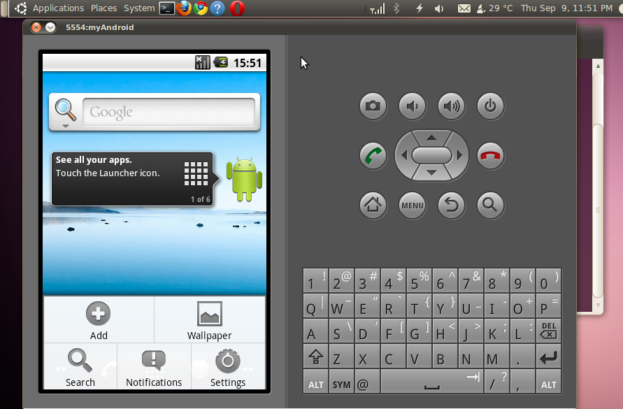

How to install and set up the Android SDK
The Android SDK (Software Developer's Kit) is a software suite intended for developing software for Android devices. The SDK, however, is not only useful for developers; it provides an easy way to access your device from a computer, and makes simple tasks such as installing applications that much simpler. In addition, it can also be used for more complex Android firmware development tasks.
To use the Android SDK, you need to install it to your computer. Below, we outline the necessary steps to install the SDK to your Linux, Mac OS-X or Windows PC.
Before you begin:
- Ensure you have the Java Development Kit (JDK)
- and that your computer meets the minimum system requirements
Download the SDK Starter Package
The Starter Package downloads the basic SDK tools necessary to download the rest of the SDK. Download it HERE.
Download Other Components
Windows: Double-click the SDK Manager.exe file at the root of the SDKdirectory
Mac/Linux: Open a terminal and navigate to the /tools directory in the SDK then execute:
./android
By default, there are two repositories of components for your SDK Repository and Third party Add-ons.
The Android Repository offers these components:
SDK Tools (pre-installed in the Android SDK starter package) - Contains tools for debugging and testing your application and other utility tools. You can access these in the /tools/ directory of your SDK and read more about them in the Tools section of the developer guide.
SDK Platform-tools — Contains tools that are required to develop and debug your application, but which are developed alongside the Android platform in order to support the latest features. These tools are typically updated only when a new platform becomes available. You can access these in the /platform-tools/ directory. Read more about them in the Tools section of the developer guide.
Android platforms — An SDK platform is available for every production Android platform deployable to Android-powered devices. Each platform component includes a fully compliant Android library and system image, sample code, emulator skins, and any version specific tools. For detailed information about each platform, see the overview documents available under the section "Downloadable SDK Components," at left.
USB Driver for Windows (Windows only) — Contains driver files that you can install on your Windows computer, so that you can run and debug your applications on an actual device. You do not need the USB driver unless you plan to debug your application on an actual Android-powered device. If you develop on Mac OS X or Linux, you do not need a special driver to debug your application on an Android-powered device. (See Developing on a Device for more information about developing on a real device.)
Samples — Contains the sample code and apps available for each Android development platform. If you are just getting started with Android development, make sure to download the samples to your SDK.

How to take Screenshots through the Android SDK
Pre-requisites
- Ensure you have set up the Android SDK. If you haven't done so already, use our guide entitled "How to install and set up the Android SDK"
- Ensure you have the correct ADB drivers installed for your phone (Windows)
The procedure
1. Ensure USB debugging is enabled on your phone (Settings>applications>development), and connect it to your computer
2. Locate the folder you unzipped the Android SDK in, open the Platform-Tools (Could just be tools, depending on version) folder and double-click ddms.bat (it might be titled just ddms if you don’t show extensions).
3. The first time you open DDMS, you’ll be prompted with a window (see below) asking if you’re willing to send usage statistics to Google. Click the Proceed button to finish opening DDMS.
4. Next, the Dalvik Debug Monitor will open. Make sure your device is listed in the upper-left window, and select it by clicking on it once to highlight it (see below).
5. Now, to take a screenshot, go to Device (at the top), then Screen Capture (see below)
6. The Device Screen Capture window will open and show you whatever is currently on your phone screen. Simply navigate on your phone to the screen you want to take the screenshot of, and then press REFRESH.
7. Once you're happy with the image being shown to you in the Screen Capture window, press SAVE, and name it!
Now... take as many as you like by repeating steps 6 and 7!

How to Flash an RUU (HTC)
Method 1, using an .EXE file:
Most HTC devices will have an executable RUU file which will do all the flashing work for you. If not then you need to use method 2.
1. Go to Shipped ROMs and select your device.
2. Download the file which is relevant to your device, ie; if you want to stock Gingerbread on the Nexus one then you would pick -
PASSIMG_Passion_Google_WWE_3.10.1700.1_GRJ22_relea se_signed.zip
(Note this isn't an .EXE file but as the Nexus One doesn't make use of them, pay attention only to the file name.)
WWE - World Wide English, this tells us it is meant for devices all over the world and is a generic update.
3.10.1700.1 - This is the radio version,
GRJ22 - This build is the build ID, GRJ tells us it's Gingerbread.
3. Once the file has finished downloading, connect your device via USB and double-click on the .EXE file you downloaded.
4. The program will check your device's compatibility and if all is well, it will start the update procedure.
NOTE: If you are using a stock ROM and you are using the RUU to downgrade, you will first need to create a goldcard.
Method 2, using a .ZIP or .IMG file:
3. Copy the file to the root of your sd card (IMPORTANT!)
4. Reboot into the bootloader using the button combo for your device or using ADB type, "adb reboot bootloader"
5. Wait a few seconds for the device to detect the update file.
