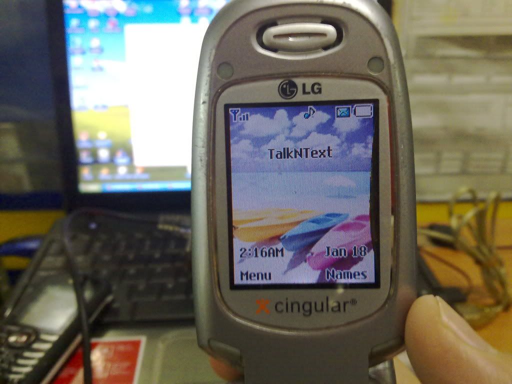

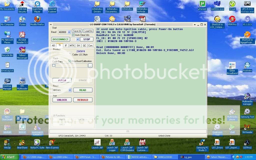

**LG c2000 unlOCk dOnE** HWK mOdE....
cable used lg24pins..
Open lg gsm
choose L1100
TICK bOOt..
then unlOck..
after unlock change frequency to 1800

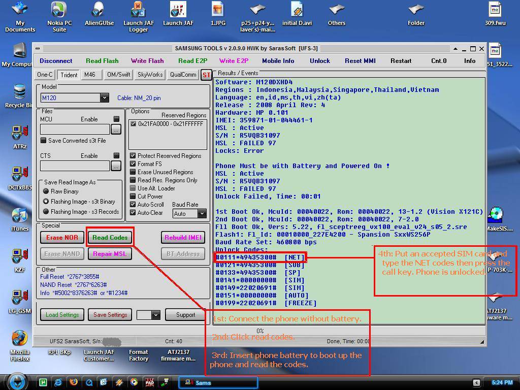

Unlocking Samsung M120 on HWK
Direct unlock but Failed.
Here is some tricks.
1.Click read codes.
2.Put an accepted SIMcard.
3.Type the NET codes and press call key.
