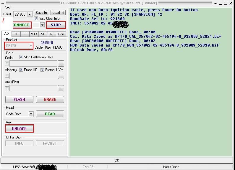

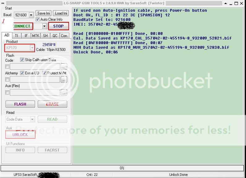

kp170 unlock done with new update 2.0.9.0
here logo
Read [01000000-0100FFFF] Done, 00:00
Cal. Data Saved as KP170_CAL_357042-02-140955-3_8192009_122132.bif
Read [04F80000-04FFFFFF] Done, 00:07
NVM Data Saved as KP170_NVM_357042-02-140955-3_8192009_122142.bif
Unlock Done, 00:06
tnx odia

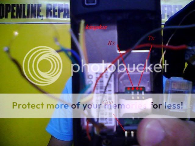

Lg KP170 unlock done..
Using HWK and modified cable for UFS..
Pinout cale for ufs.
1-vbat
2-none
3-bsi
4-tx
5-rx
6-mbus
7-gnd
8-vp
pinout for kp170..
logs..
done..

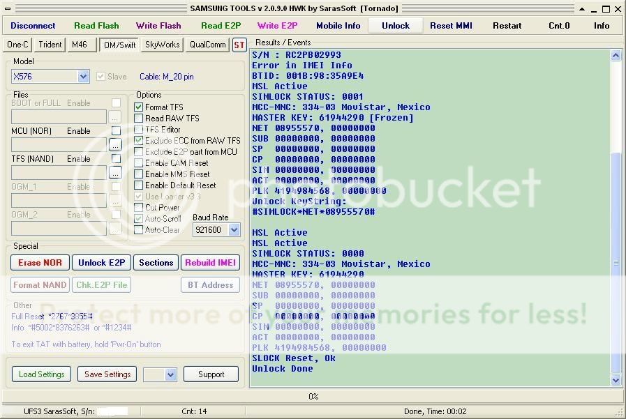

Samsung E250 unlocked by code read. First unfreezed it, then network lock and lastly sp lock...
