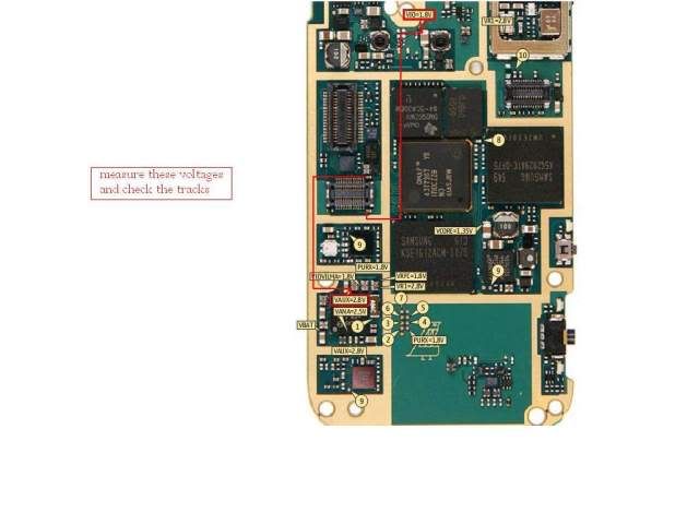

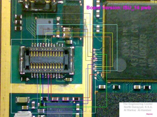

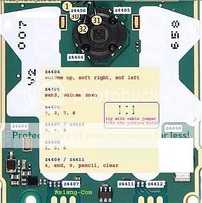

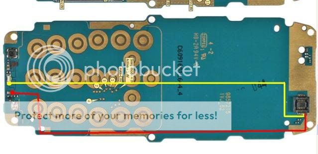

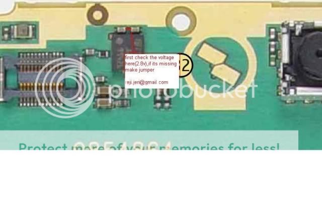

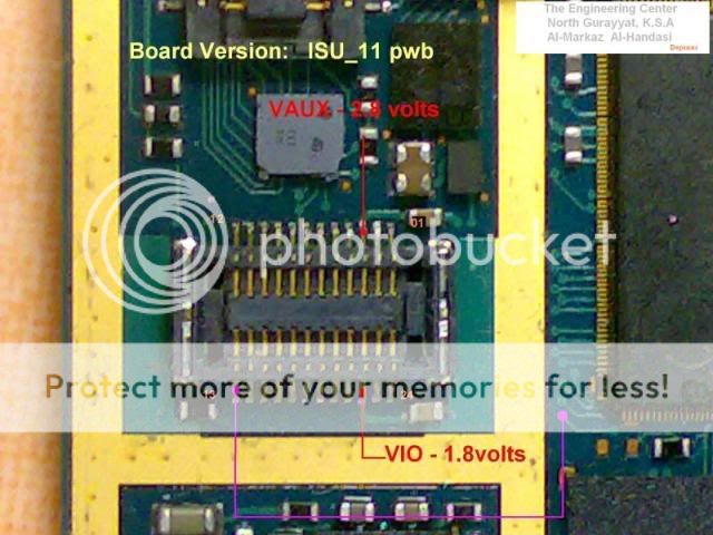

N91 keypad not working,,,,
remove esd filter then make jumber like this picture
post result

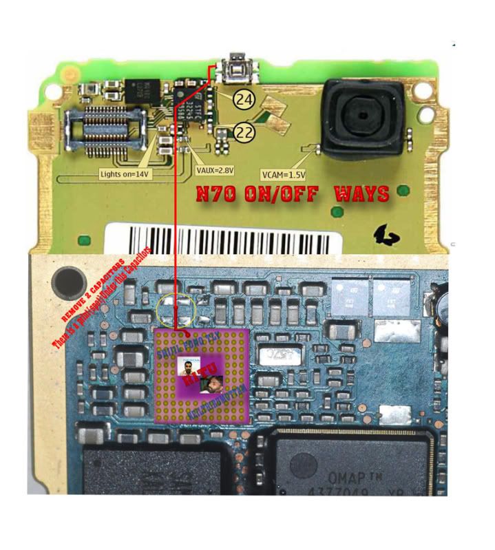

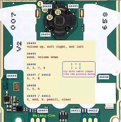

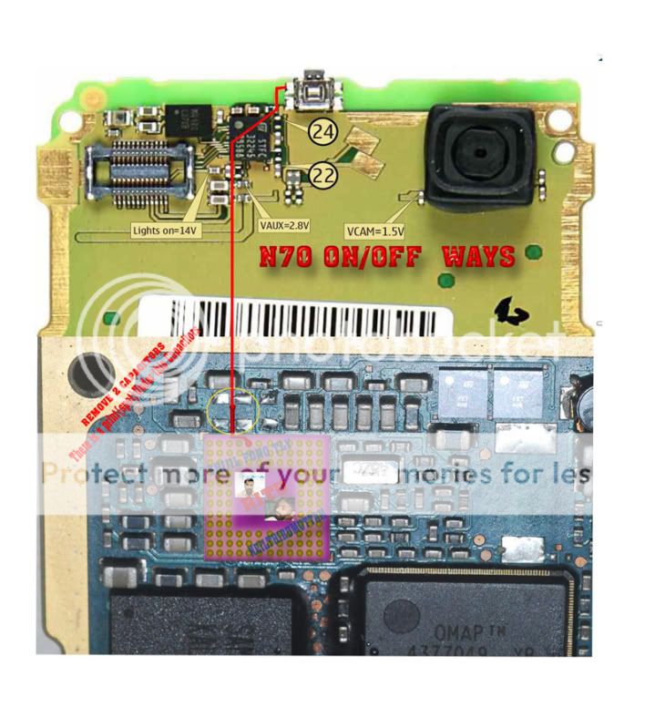

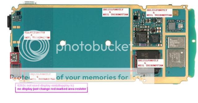

NOKIA LASTEST MODEL 6208c_6202c_RM-458
KEYPAD AND ON/OFF
DISPLAY

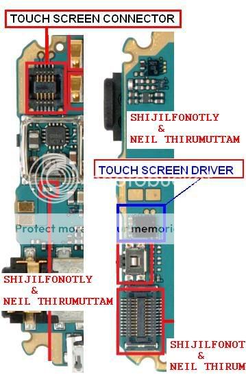

TOUCH SCREEN
MMC

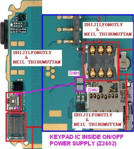

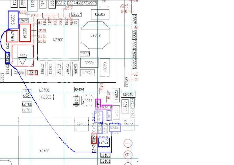

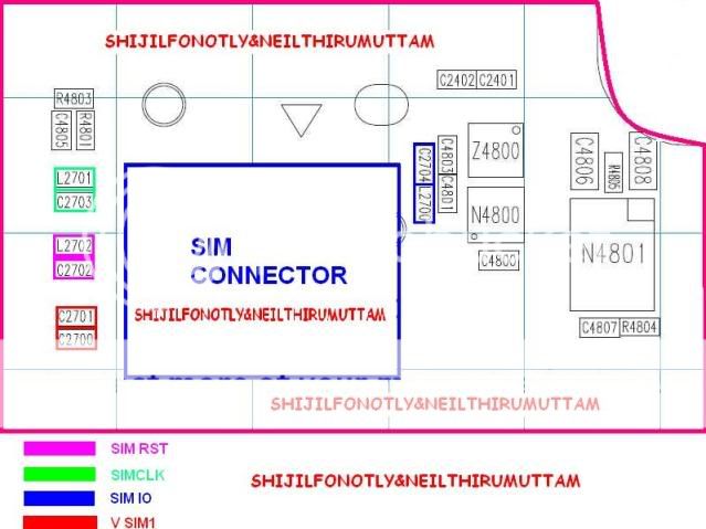

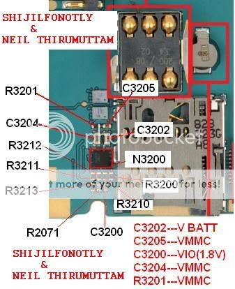

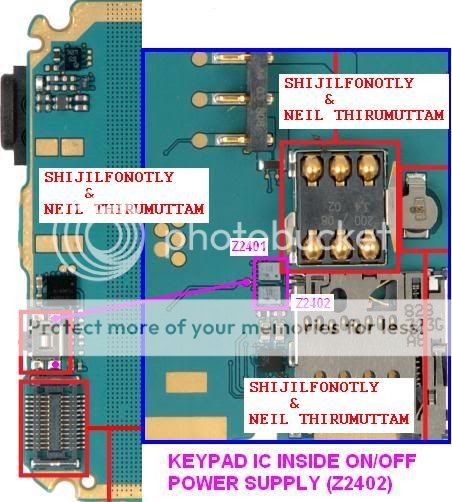

6500s Insert sim problem..
SIM RALATED COIL OR CAPACITOR INSIDE THIS TRAY
CHECK THIS PICTURE

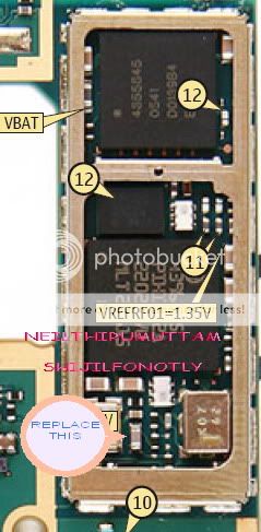

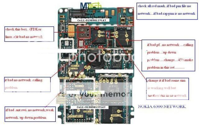

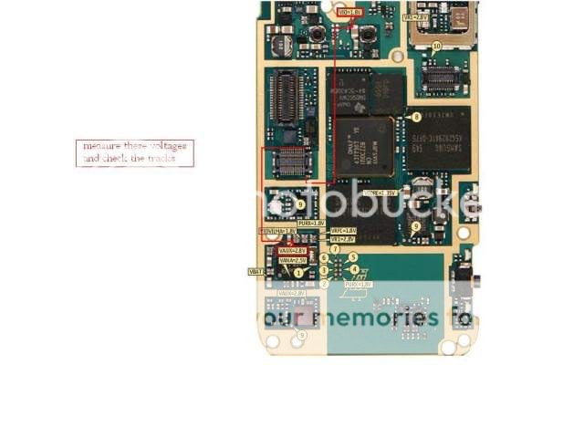

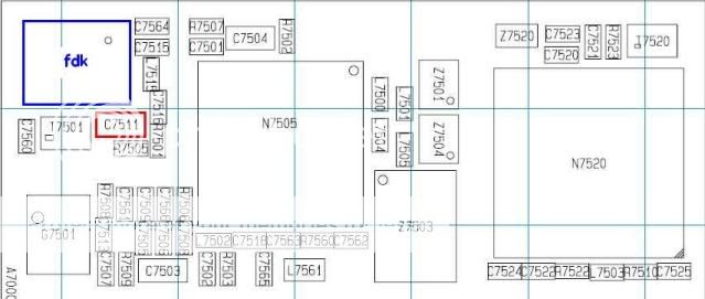

3110c and 6300 both are net work problems some times signal drop and some ttimes out of coverage and some times call ok ,two sets same problems give me solution,
first try to change that capacitor red marked
problem not solved try this

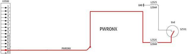

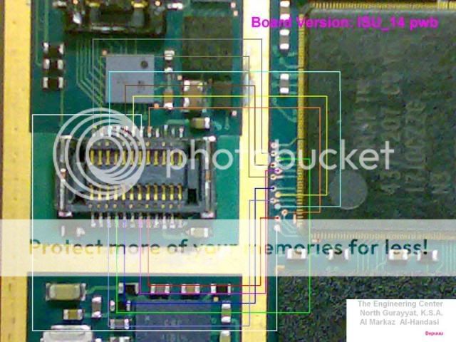

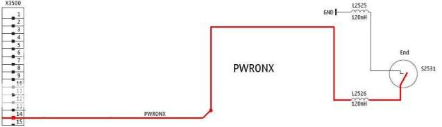

SOLUTION STEP BY STEP
1)CHECK OR CHANGE STRIP
2)CLEAN PROPERLY X3500 MAIN STRIP CONNECTOR
3)CHECK PWRONX CONNECTION PIN NUMBER 14 AND RESOLDRING
4)CHANGE TOP PWD(ON/OFF PAD)
5)LAST CHECK AVLIMA PIN NUMBER D9
Nokia N73 Blue Display. its incoming and out going calls r ok.

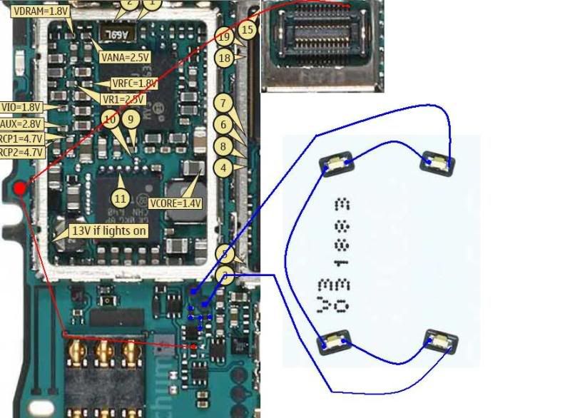

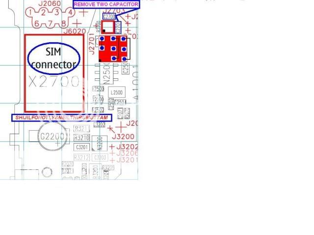

6280 and 6300 in same problem
insert sim card i change sim ic and also make jumper
6300@REMOVE C2700 VSIM RELATED CAPACITOR
BECOZ THIS CAPACITOR LEAKAGE TIME VSIM VOLT DROPED
THIS TIME PHONE SIM NOT TAKEN
SAME METHODE TRY 6280
6280
6300
