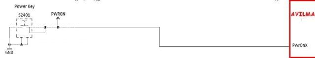

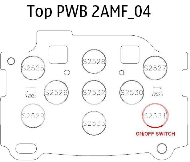

Nokia 6233 on/off switch jumper
ON/OFF SWITCH WAYS

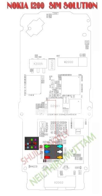

1200 insert sim;change sim ic in again again
check vsim ways

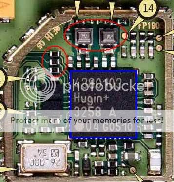

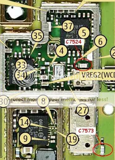

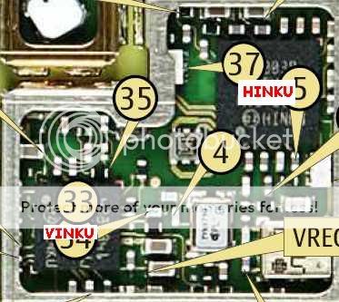

N70,N72 NO OPERATOR FOUND SOLUTION REPAIRING STEP BY STEP
1)PUT SIM THEN GO MENU+TOOL+SETTING+NETWORKSETTINGS
CHANGE THIS MODE GSM
THEN CHECK PHONE NETWORK STATUS SAME NET WORK PROBLEM???
2)(A)GO MENU+TOOL+SETTING+NETWORKSETTINGS
CHANGE OPERATOR SELECTION
AUTOMATIC TO MANUUL MODE
THIS TIME PHONE GOING TO SHOT SEARCH?THEN SHOW NO OPERATOR FOUND MESSAGE?
CHECK AN****A PAD OR AN****A PAD INTERFACE
40%AN****A SWITCH PROBLEM CHNAGE (AN****A SWITCH)

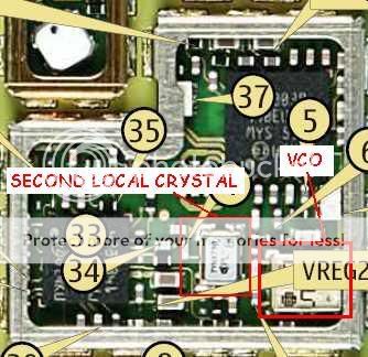

2)(B)MANNUL SEARCHING TIME PHONE GOING TO LONG SEARCH?
FIRST CHANGE, C7524 OR C7573 CAPACITOR
AFTER CHANGE THIS CAPACITOR SAME CONDITION UR PHONE?
SECOND CHECK OR CHNAGE G7500 VCO OR SECOND LOCAL CRYSTAL(38.4Mhz)
NOT SOLVED UR PROBLEM?
REBALL OR CHANGE VINKU

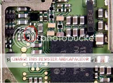

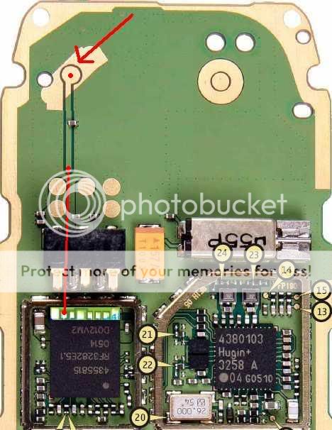

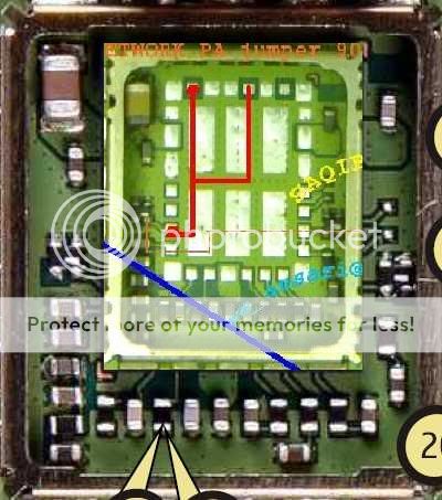

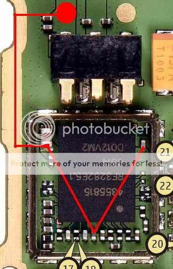

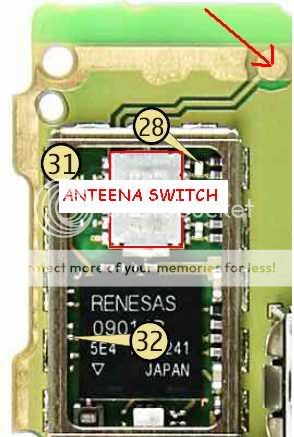

1600 with no network
1)CHECK AN****A
2)CHECK OR CLEAN AN****A CONNECTOR
3)CHECK PA POWER INPUT WAYS
4)REMOVE PA THEN MAKE JUMBER LIKE THIS PICTURE
AFTER FIX THIS JUMBER!PHONE SHOW SAME NET NO ACCESS PROBLEM?
5)JUST CHANGE RED MARKED RX FILTER OR RESISTER(TX CONTROLL)
LAST TRY TO CHANGE RF IC
ONE THINK UEM OR UPP MAKE NET WORK PROBLEM
65%PROBLEM SOLVED THIS METHODE
20M
15%UPP
FRIENDS PA JUMBER NOT PERMENT SOLUTION CHANGING IS BATTER

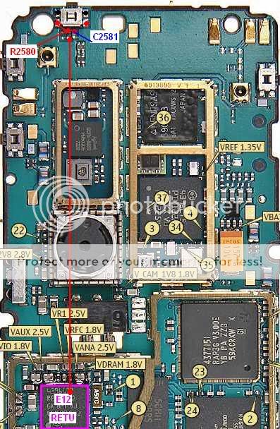

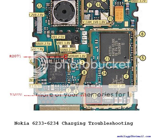

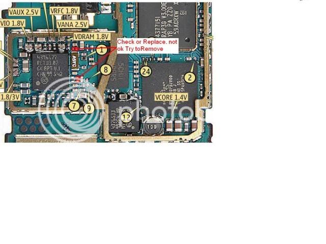

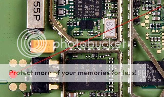

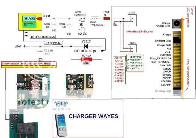

power key dont work in 6500
charger insert time phone show charging
change strip then check this parts in front pannel
here this picture

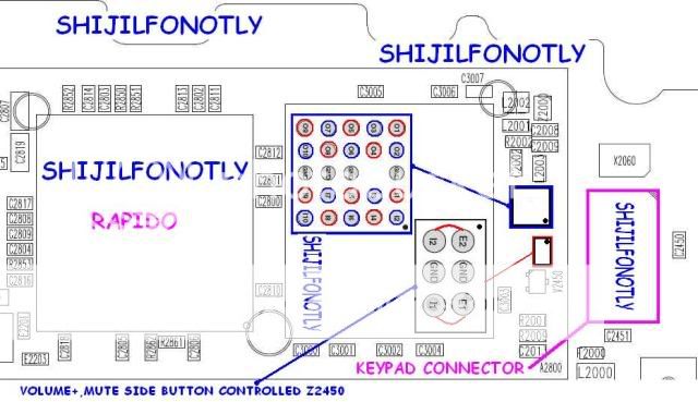

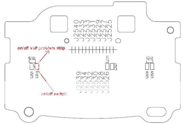

need 6120 power switch
6120C NO JUNCTION ON/OFF WAYS
U MUST DRAG PCB IN VOLT AREA
BROKEN PRINT ARAE SURELY INSIDE CONNECTION JUST TRY
NO OTHER WAY
CHECK THIS PICTURE

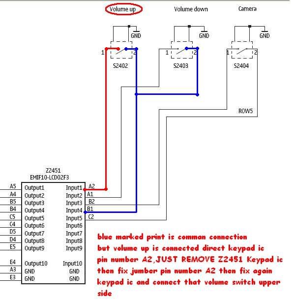

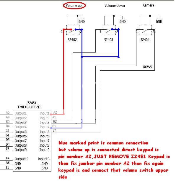

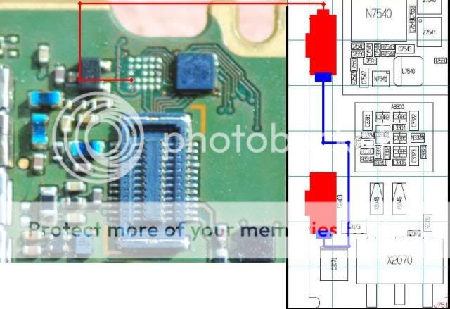

6120c about volume up , i miss one connector at left on pcb
POST RESULT
1. BSI line is not connected properly in connector -> Check cable, also for 3.3k resistor in serial with bsi line.
2.UEM damaged -> replace UEM.
THIS ERROR MAINLY BSI LINE RELATED PROBLEM
