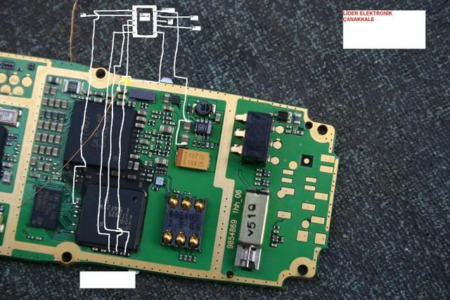

NOKIA 2600 DISPLAY WAYS HERE
AFTER CHECKING WAYS?
WAYS R 100% OK BUT NO DISPLAY REMOVE OR CHANGE DISPLAY WAYS REALERTED COMPONTENT

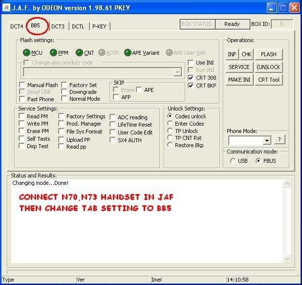

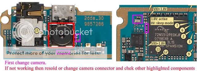

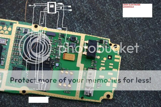

n73. problem is when i switch on the phone its automaticly switch on the back camera.

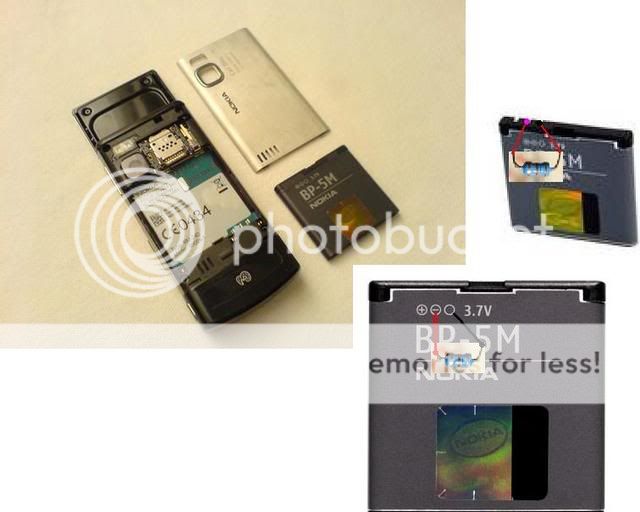

MY OTHER TECHNICS WITH NOKIA 6500S,5610 ETC.....RESTART SOLVED WITH OUT FLASHING

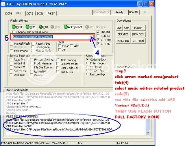

MANY NOKIA BB5 PHONES SHOW RESTART,NOKIA LOGO ONLY,TIME AND DATE FIXING TIME RESTARTED,HAND SHAKE TIME RESTARTED ETC............
HOW TO SOLVED THIS PROBLEM VIA JAF WITH OUT FLASHING
STEP1-REMOVE BACK COVER AND BATTERY
SETP2-FIX 7.1 RESISTER LIKE THIS PICTURE
(BSI TO GND FIX THIS 7.1 RESISTER WITH BATTERY)
STEP3-INSERT BATTERY WITH HANDSET
STEP4-POWER ON THE PHONE
STEP5-THIS TIME PHONE SHOW LOCAL MODE
STEP6-CONNECT USB CABLE
STEP7-OPEN JAF SOFTWARSTEP8-SELECT COMMUNICATION MODE TO USB
STEP9-USE FULL FACTORY RESET(FACTORY RESET DONE)
STEP10-DISCONNECT PHONE THEN POWER ON WITH OUT SIM
STEP11-GO PHONE SETTINGS RESET COMPLETE PHONE
UR PROBLEM SOLVED 100%.............
TESTED BY ME ABOVE 1000 PHONES

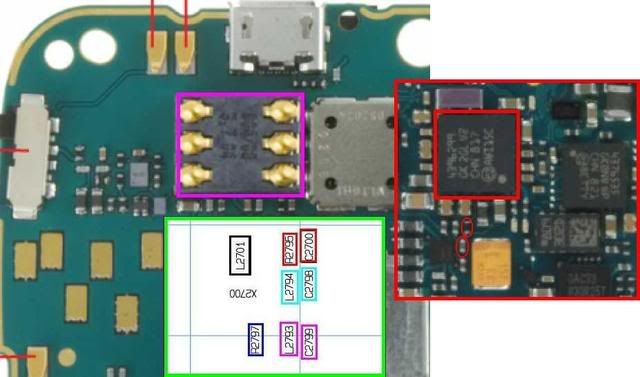

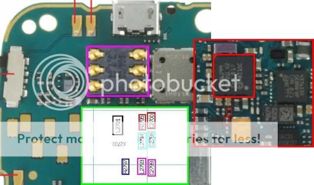

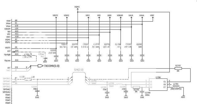

n79i insrt sim
remove sim tray then check inside compontent marked resister,coil,capacitor etc..............

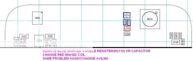

nokia n70 no network
FIRST CHANGE THIS CAPACITOR LIKE THIS PICTURE
SAME NO ACCESS PROBLEM FACED CHANGE PA

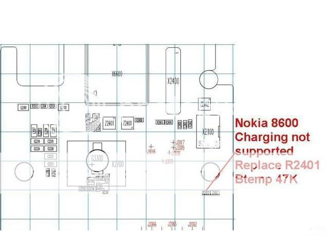

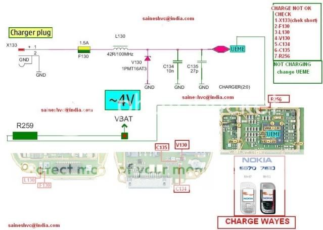

nokia 8600 charger not supported solution via pm
here solution

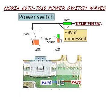

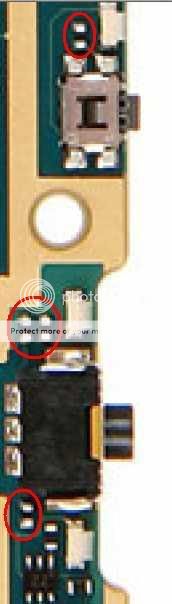

7610 that's button on/off automaticly pressed.
1)remove on/off switch
then insert battery this time phone trun on automatically?
try to removed R430 veriable resister
same again?remove UEM then check on/off ways shot to gnd
no shot 100%UEM fault this
some times inside pc layer shotage phone show this problem
post result

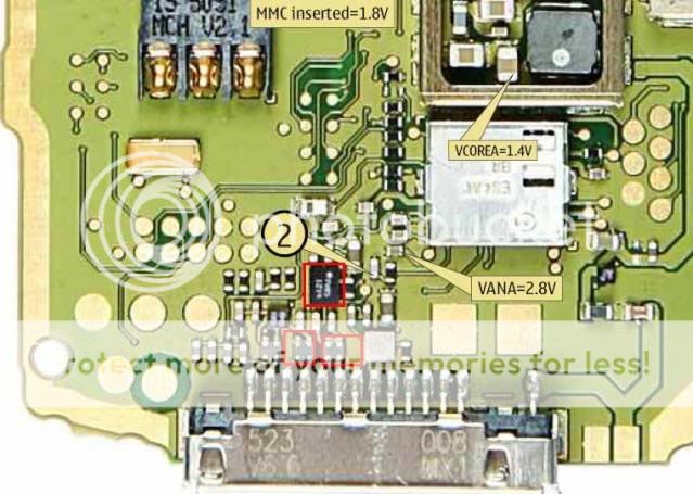

nokia 3250 sel hang or sometimes nokia logo standby problem.
NORMALY SMPS GENARATED VCORE VOLT 1.4
BUT 3250,6300,3110C ETC.............THIS VOLT GENERATED BY TAHVO
TAHVO NOT GENARATED THIS VOLT PROPERLY PHONE SHOW THIS PROBLEM.
THIS SAME CAUSE 6300 SIDE BLUE LIGHT BLINKING 50%SOLVED VIO TO VCORE SHOTING.
JUST TRY THIS SAME METHODE 3250 NON BOOTING PROBLEM.
APE OR CMT FLASH INCLUDING ONE CHIP(COMBO MEMORY)
AFTER MAKE THIS JUMBER PHONE SHOW SAME PROBLEMS
U MUST CHECK TAHVO OR COMBO MEMORY
POST RESULT

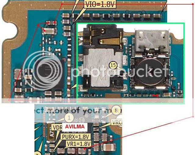

n70 handsfree not working jack is already ok what is solution

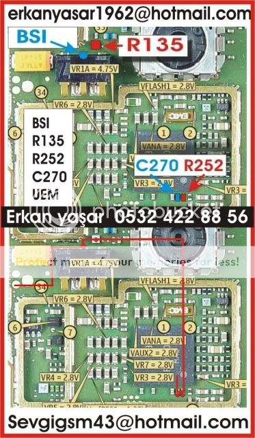

7610 not charge and give 6.6 volt
here not charging solution

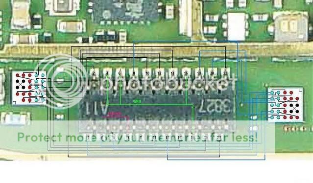

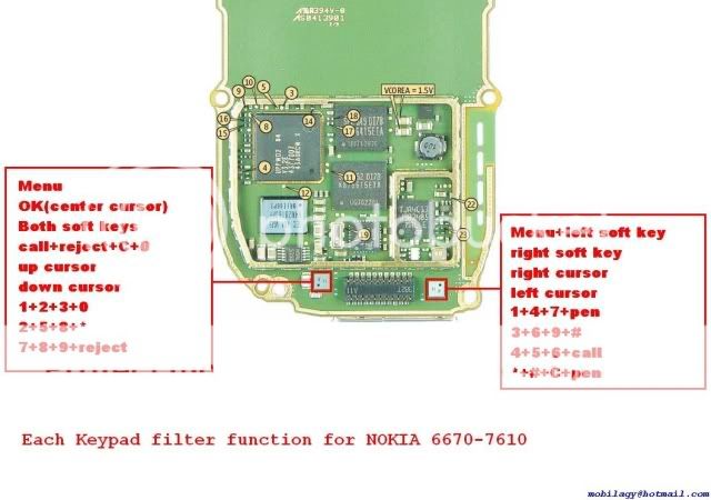

here keypad complete ways
