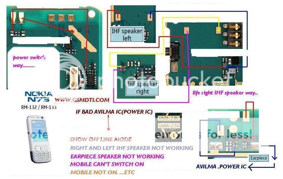

N NANAIU Well-known Member Joined Oct 15, 2010 Posts 2,734 Likes 63 Location BD Oct 15, 2010 #92 N73 solution

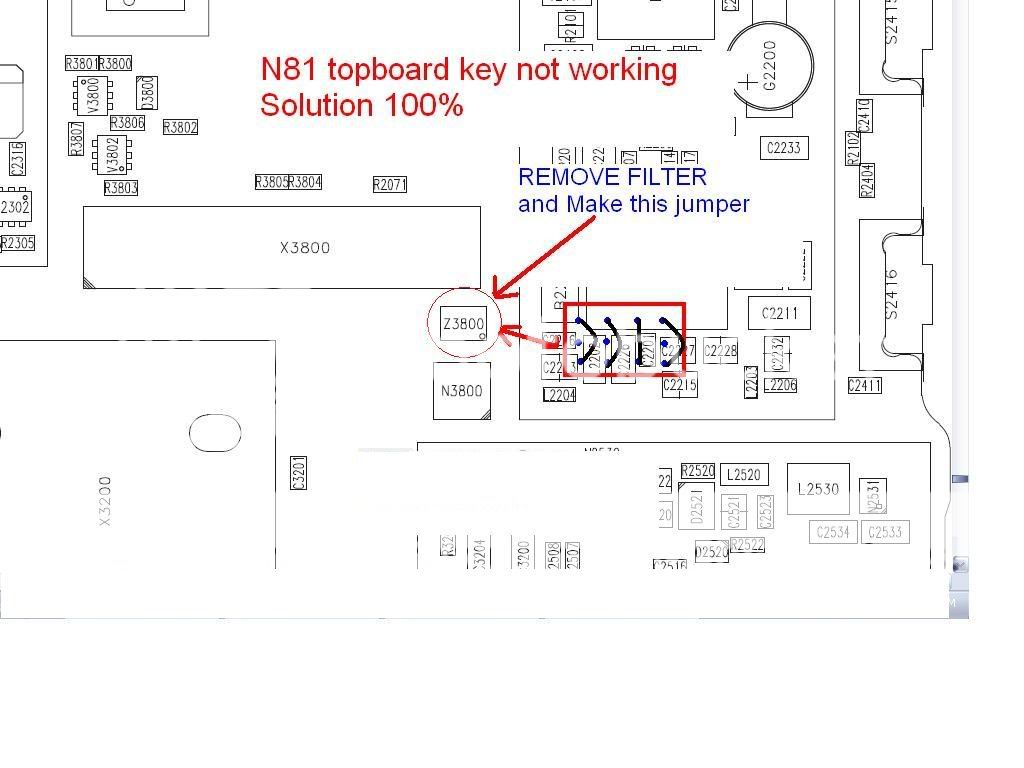

N NANAIU Well-known Member Joined Oct 15, 2010 Posts 2,734 Likes 63 Location BD Oct 15, 2010 #100 N81 Top Board key problem solution

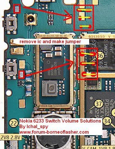

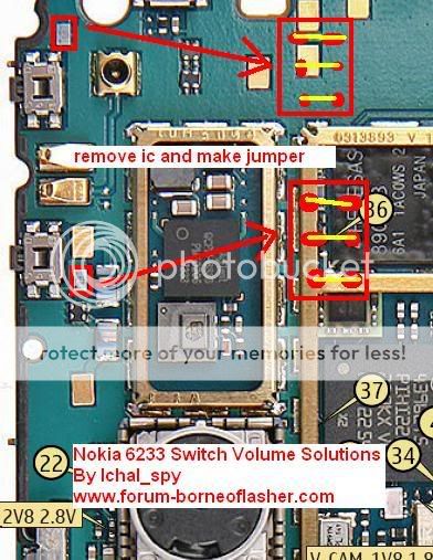

N NANAIU Well-known Member Joined Oct 15, 2010 Posts 2,734 Likes 63 Location BD Oct 15, 2010 #101 Nokia 6233 switch Volume Solution

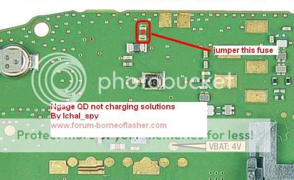

N NANAIU Well-known Member Joined Oct 15, 2010 Posts 2,734 Likes 63 Location BD Oct 15, 2010 #102 Ngage QD Charging solutions

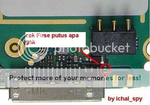

N NANAIU Well-known Member Joined Oct 15, 2010 Posts 2,734 Likes 63 Location BD Oct 15, 2010 #103 3230 charging solutions.....

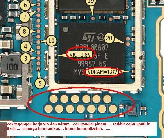

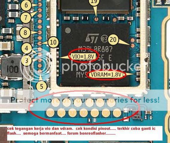

N NANAIU Well-known Member Joined Oct 15, 2010 Posts 2,734 Likes 63 Location BD Oct 15, 2010 #104 5300 cmt error sollution

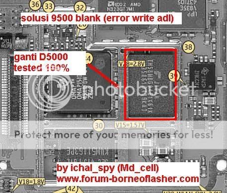

N NANAIU Well-known Member Joined Oct 15, 2010 Posts 2,734 Likes 63 Location BD Oct 15, 2010 #105 Nokia 9500 Blanks solutios (error when write adl)
