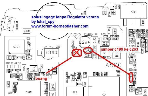

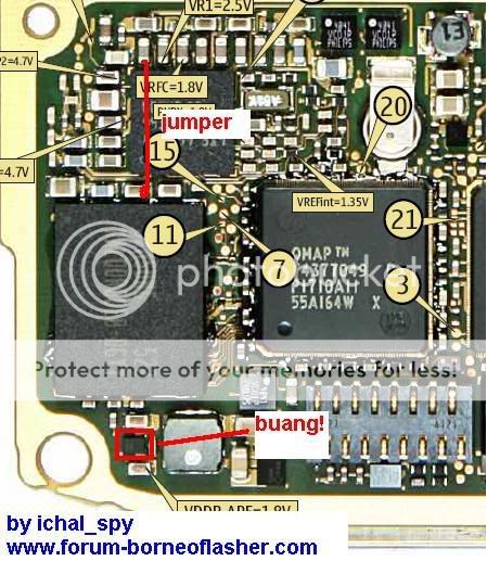

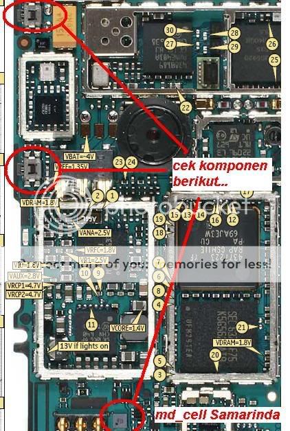

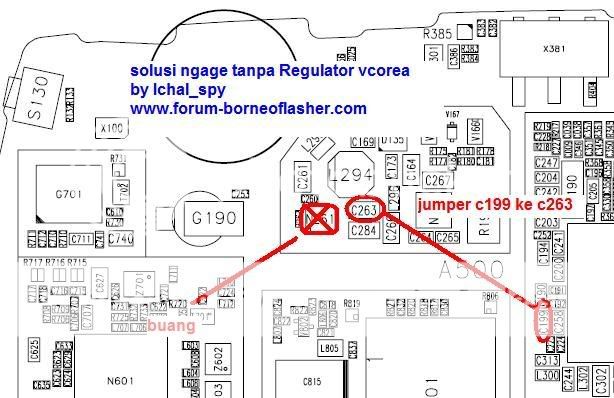

N NANAIU Well-known Member Joined Oct 15, 2010 Posts 2,734 Likes 63 Location BD Oct 15, 2010 #106 N70 Ape 2nd boot error... remove ape regulator and make this jumping

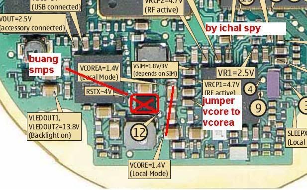

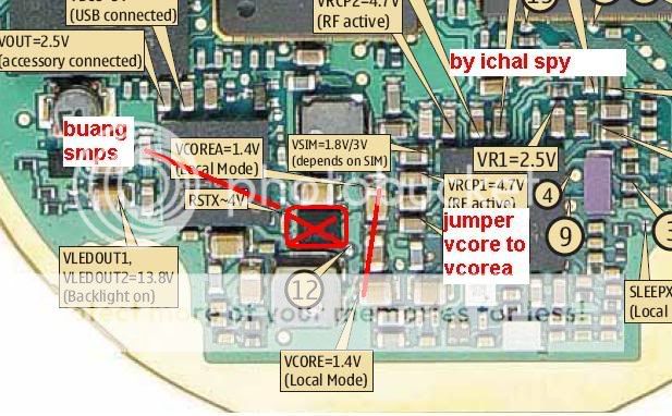

N NANAIU Well-known Member Joined Oct 15, 2010 Posts 2,734 Likes 63 Location BD Oct 15, 2010 #107 6630 missmatch solutions.... remove smps then make this jumper

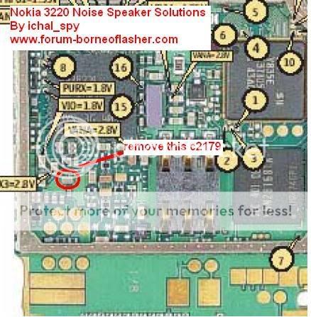

N NANAIU Well-known Member Joined Oct 15, 2010 Posts 2,734 Likes 63 Location BD Oct 15, 2010 #109 3220 no speaker

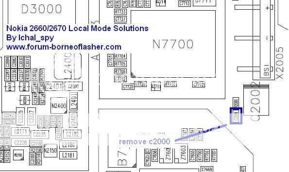

N NANAIU Well-known Member Joined Oct 15, 2010 Posts 2,734 Likes 63 Location BD Oct 15, 2010 #110 Nokia 2760 Local Mode Solutions

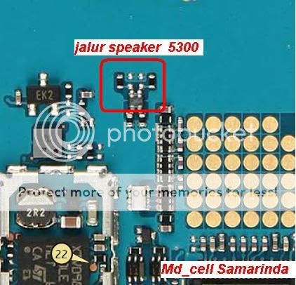

N NANAIU Well-known Member Joined Oct 15, 2010 Posts 2,734 Likes 63 Location BD Oct 15, 2010 #112 5300 noice speaker... remove the capasitor

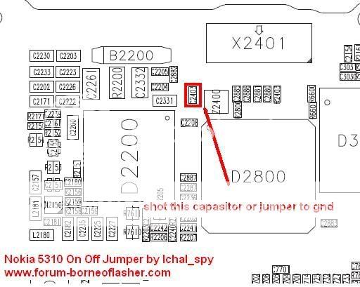

N NANAIU Well-known Member Joined Oct 15, 2010 Posts 2,734 Likes 63 Location BD Oct 15, 2010 #113 5310 on off jumper....

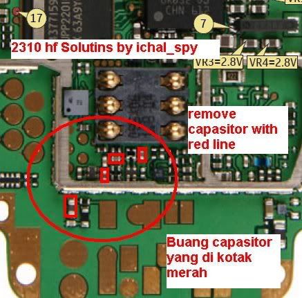

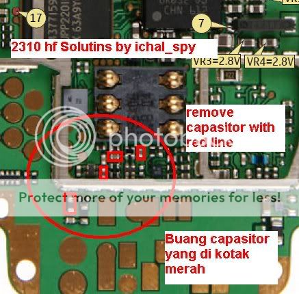

N NANAIU Well-known Member Joined Oct 15, 2010 Posts 2,734 Likes 63 Location BD Oct 15, 2010 #115 Nokia 2310 Hansfree solutions

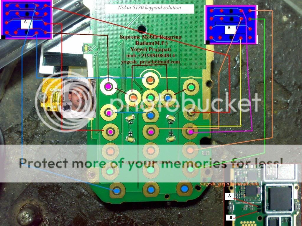

N NANAIU Well-known Member Joined Oct 15, 2010 Posts 2,734 Likes 63 Location BD Oct 15, 2010 #118 Nokia 5130c Keypad solution
