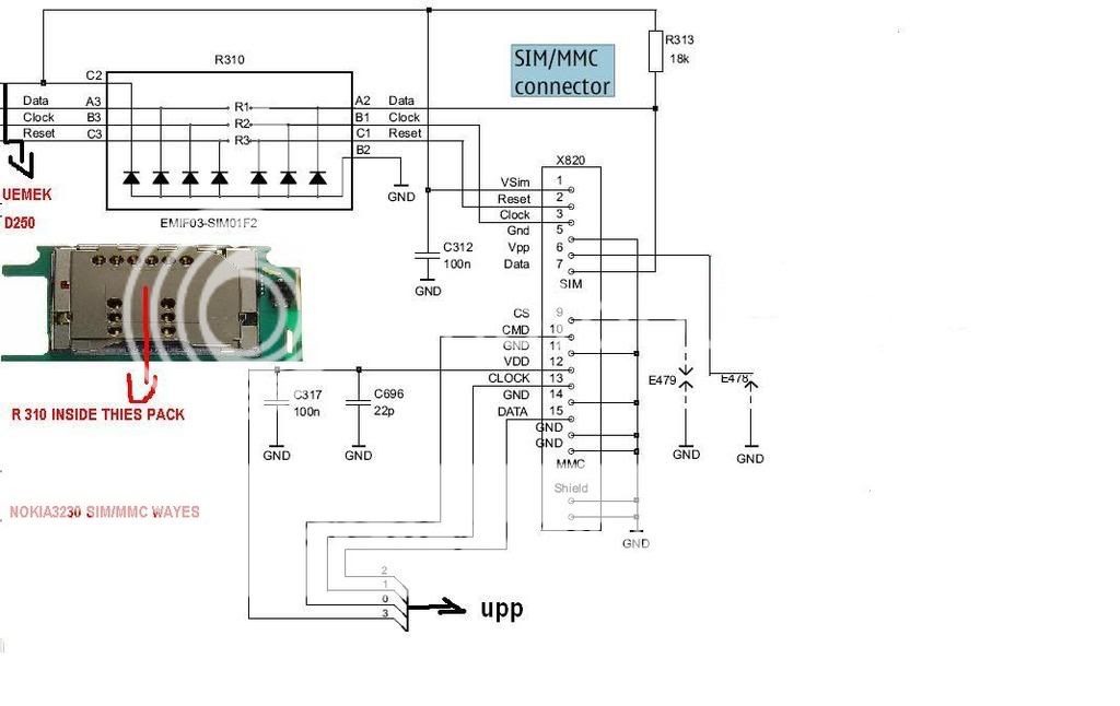

N NANAIU Well-known Member Joined Oct 15, 2010 Posts 2,734 Likes 63 Location BD Oct 15, 2010 #61 3230 sim & mmc way

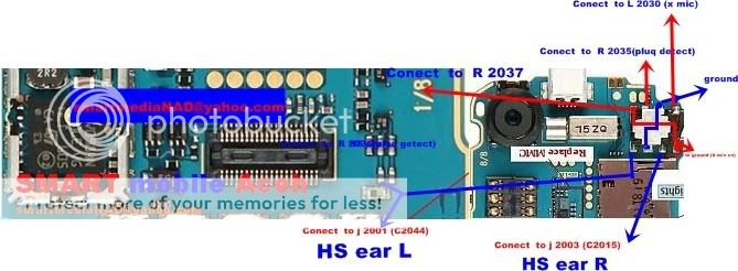

N NANAIU Well-known Member Joined Oct 15, 2010 Posts 2,734 Likes 63 Location BD Oct 15, 2010 #62 2760 mic solution

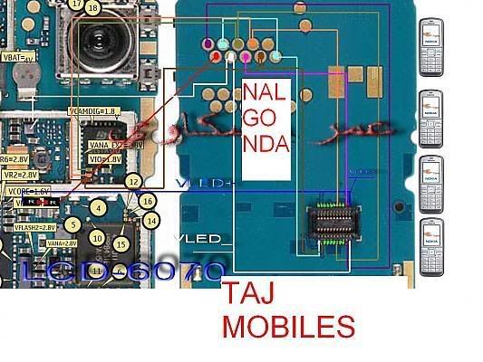

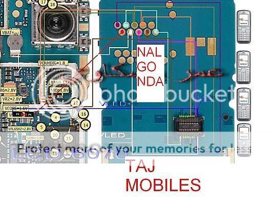

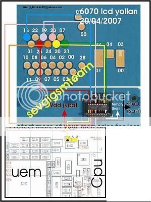

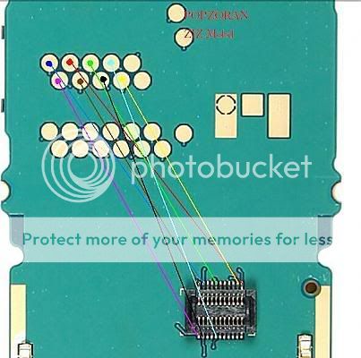

N NANAIU Well-known Member Joined Oct 15, 2010 Posts 2,734 Likes 63 Location BD Oct 15, 2010 #63 6070 display jumper

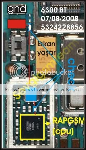

N NANAIU Well-known Member Joined Oct 15, 2010 Posts 2,734 Likes 63 Location BD Oct 15, 2010 #64 6300 Bluethooth solution

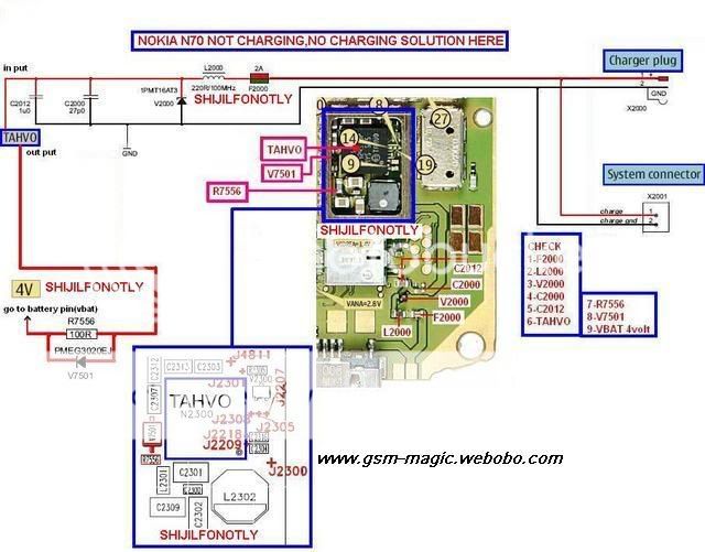

N NANAIU Well-known Member Joined Oct 15, 2010 Posts 2,734 Likes 63 Location BD Oct 15, 2010 #66 N-70 Not charging

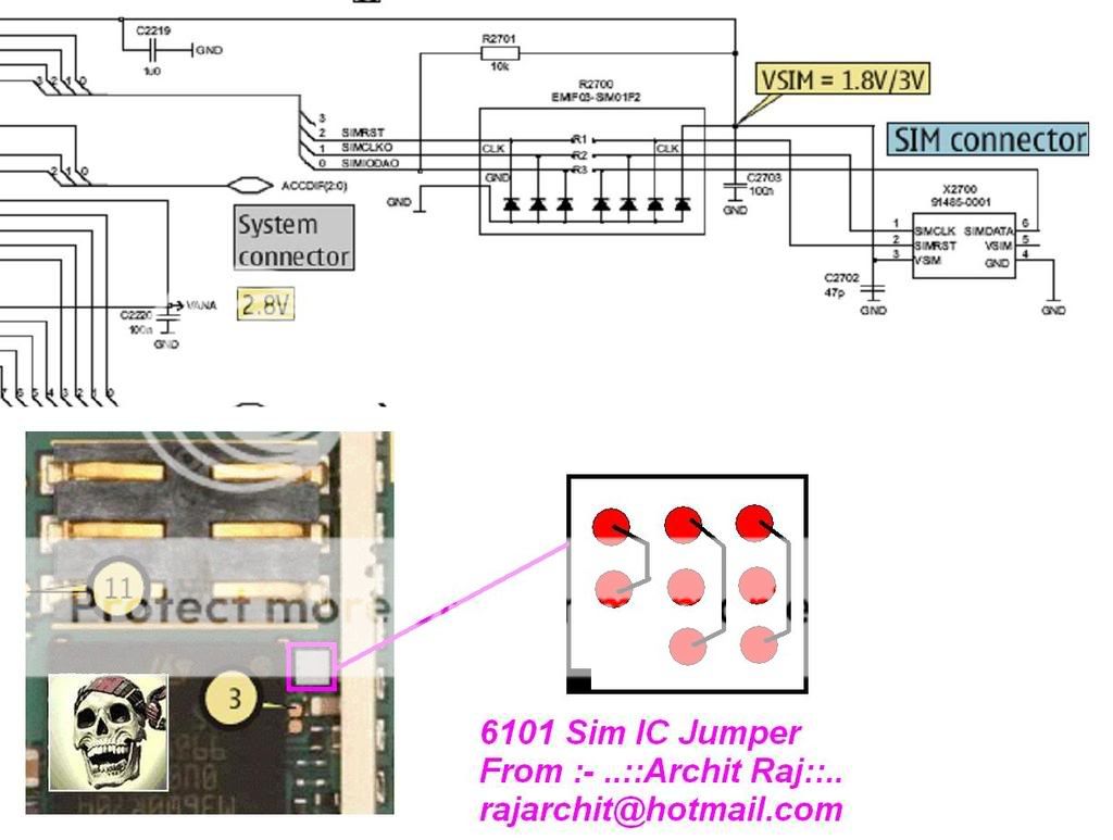

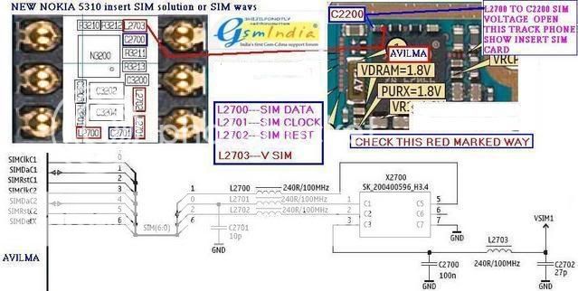

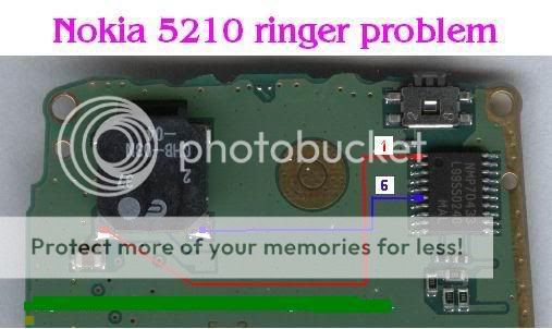

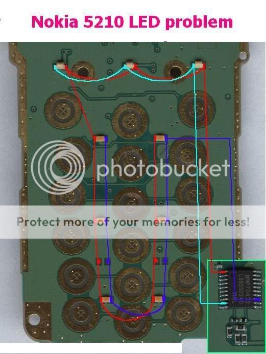

N NANAIU Well-known Member Joined Oct 15, 2010 Posts 2,734 Likes 63 Location BD Oct 15, 2010 #67 Nolia 6101 Light problem & Sim ic jumper

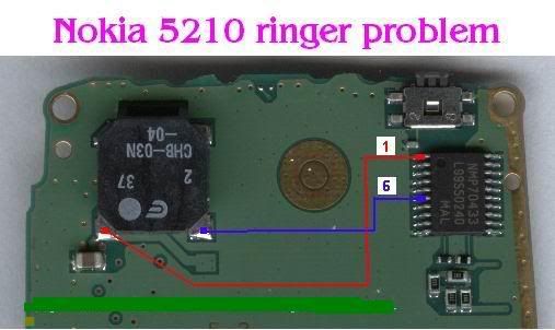

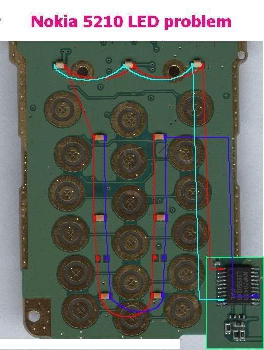

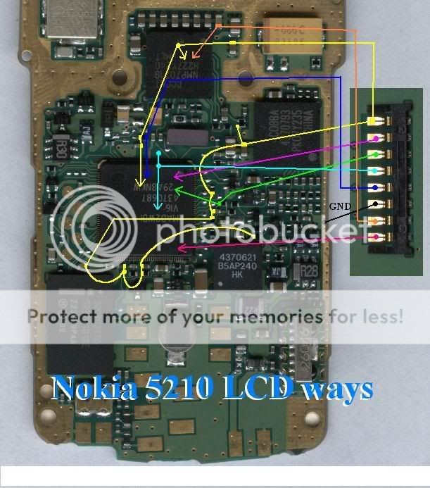

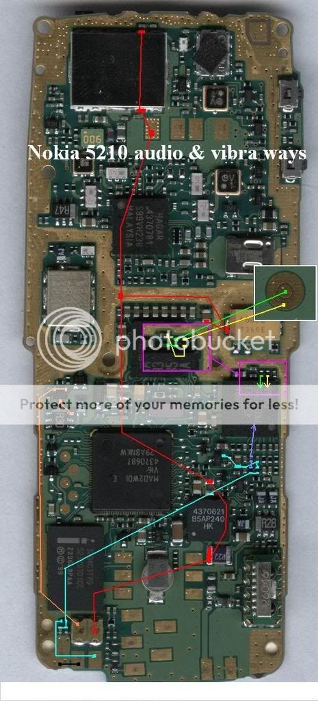

N NANAIU Well-known Member Joined Oct 15, 2010 Posts 2,734 Likes 63 Location BD Oct 15, 2010 #68 Nokia 5210 some solution

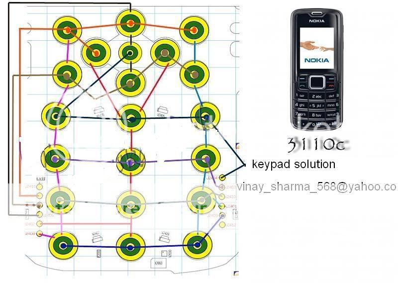

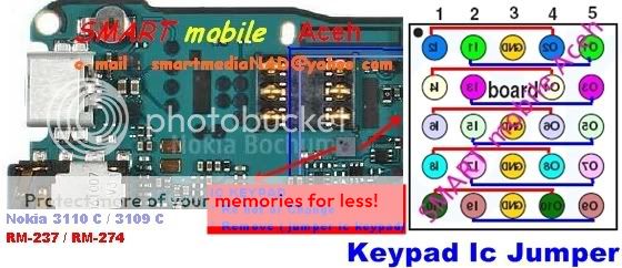

N NANAIU Well-known Member Joined Oct 15, 2010 Posts 2,734 Likes 63 Location BD Oct 15, 2010 #72 3110 keypad solution

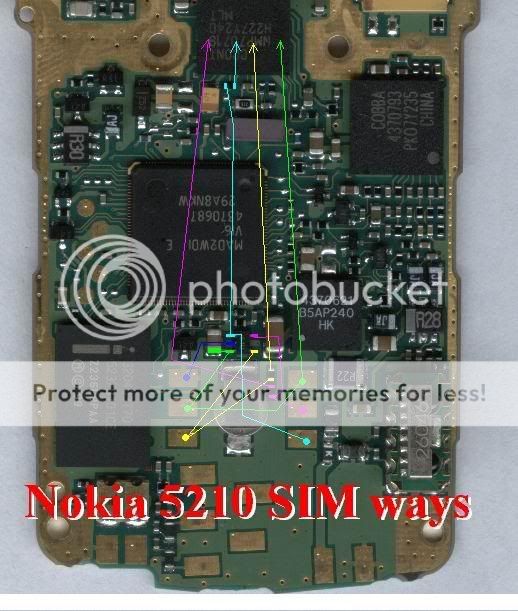

N NANAIU Well-known Member Joined Oct 15, 2010 Posts 2,734 Likes 63 Location BD Oct 15, 2010 #74 5310 Sim Way

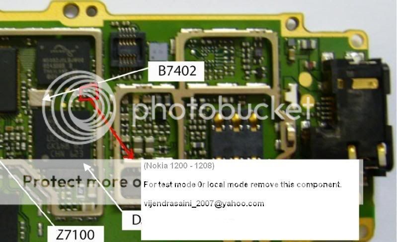

N NANAIU Well-known Member Joined Oct 15, 2010 Posts 2,734 Likes 63 Location BD Oct 15, 2010 #75 1200 , 1208 , 1650 testmode solution
