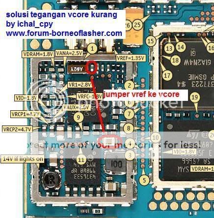

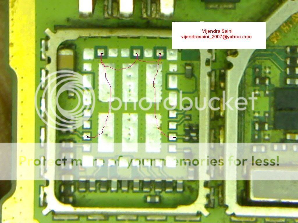

N NANAIU Well-known Member Joined Oct 15, 2010 Posts 2,734 Likes 63 Location BD Oct 15, 2010 #31 new power full jumper 1110 1600 2310 2610 2626 6030 network problem

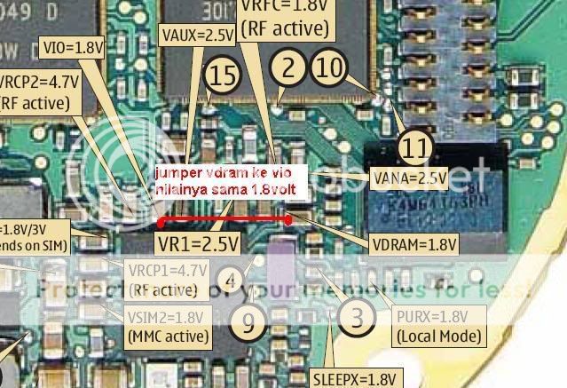

N NANAIU Well-known Member Joined Oct 15, 2010 Posts 2,734 Likes 63 Location BD Oct 15, 2010 #32 6120 local mode

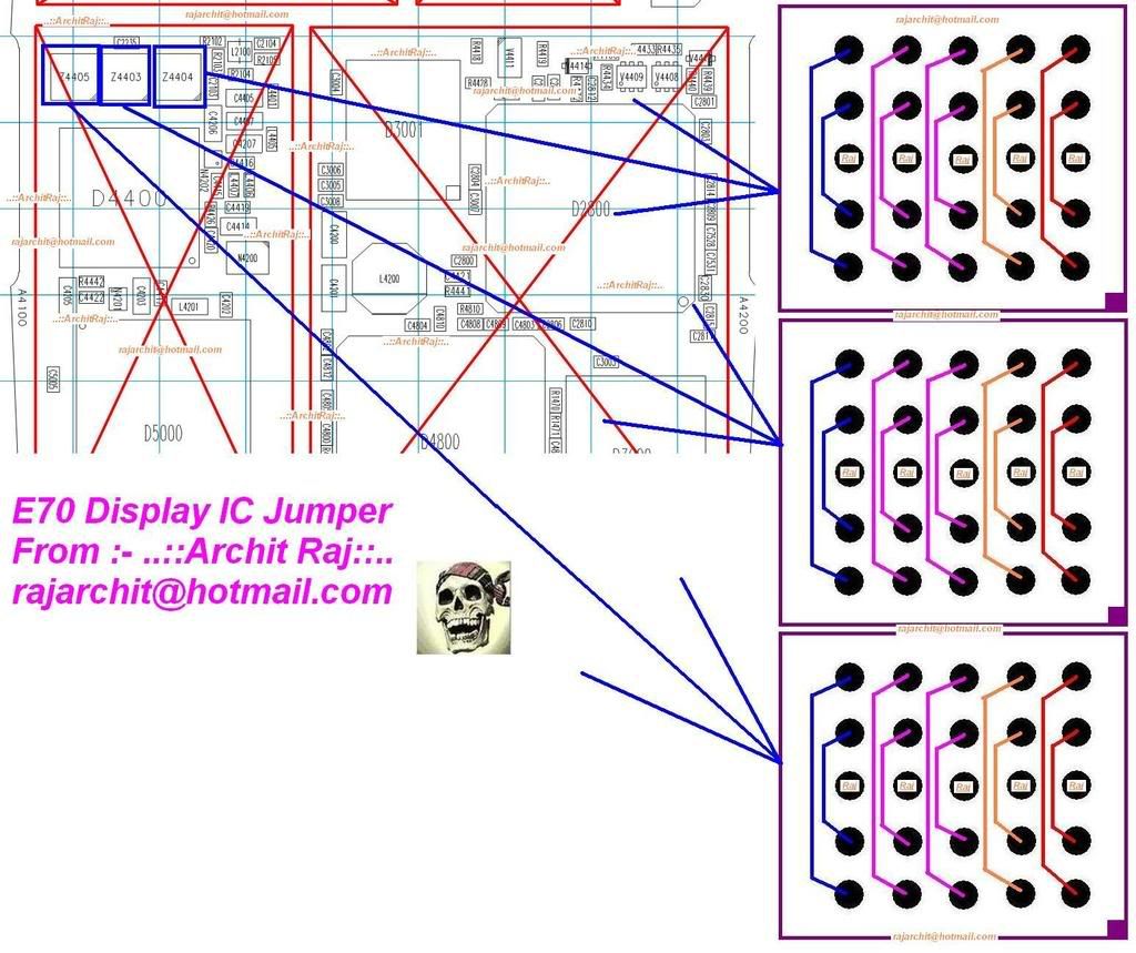

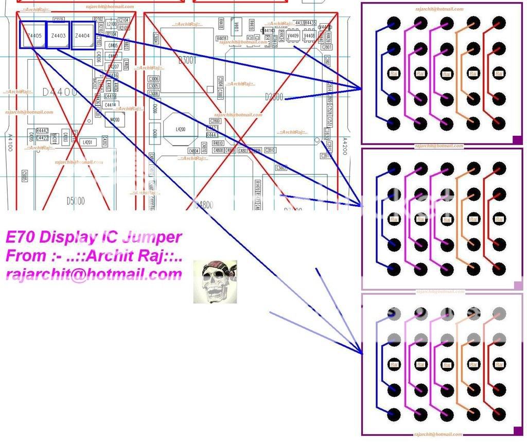

N NANAIU Well-known Member Joined Oct 15, 2010 Posts 2,734 Likes 63 Location BD Oct 15, 2010 #33 E70 Display IC Jumper

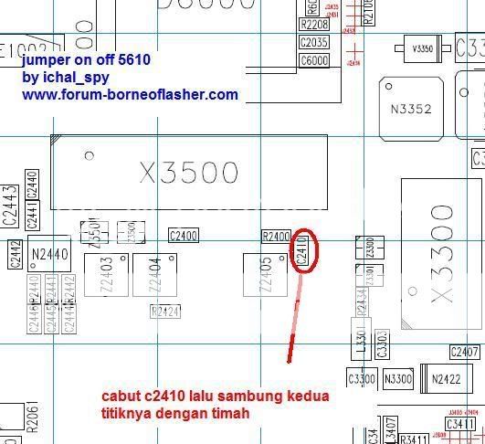

N NANAIU Well-known Member Joined Oct 15, 2010 Posts 2,734 Likes 63 Location BD Oct 15, 2010 #36 5610 on off jumper... jumper capasitor to ground

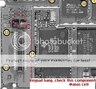

N NANAIU Well-known Member Joined Oct 15, 2010 Posts 2,734 Likes 63 Location BD Oct 15, 2010 #38 9500_keypad_hang

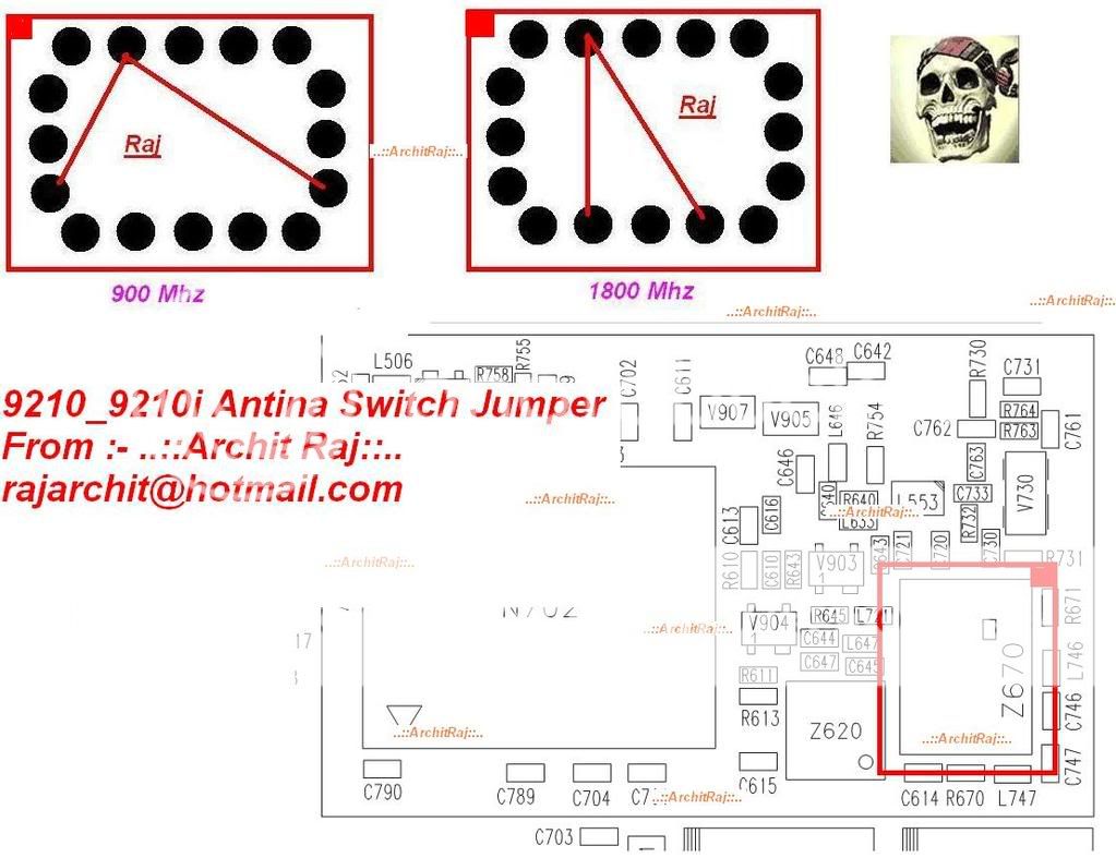

N NANAIU Well-known Member Joined Oct 15, 2010 Posts 2,734 Likes 63 Location BD Oct 15, 2010 #41 9210_9210i Antina Switch Jumper

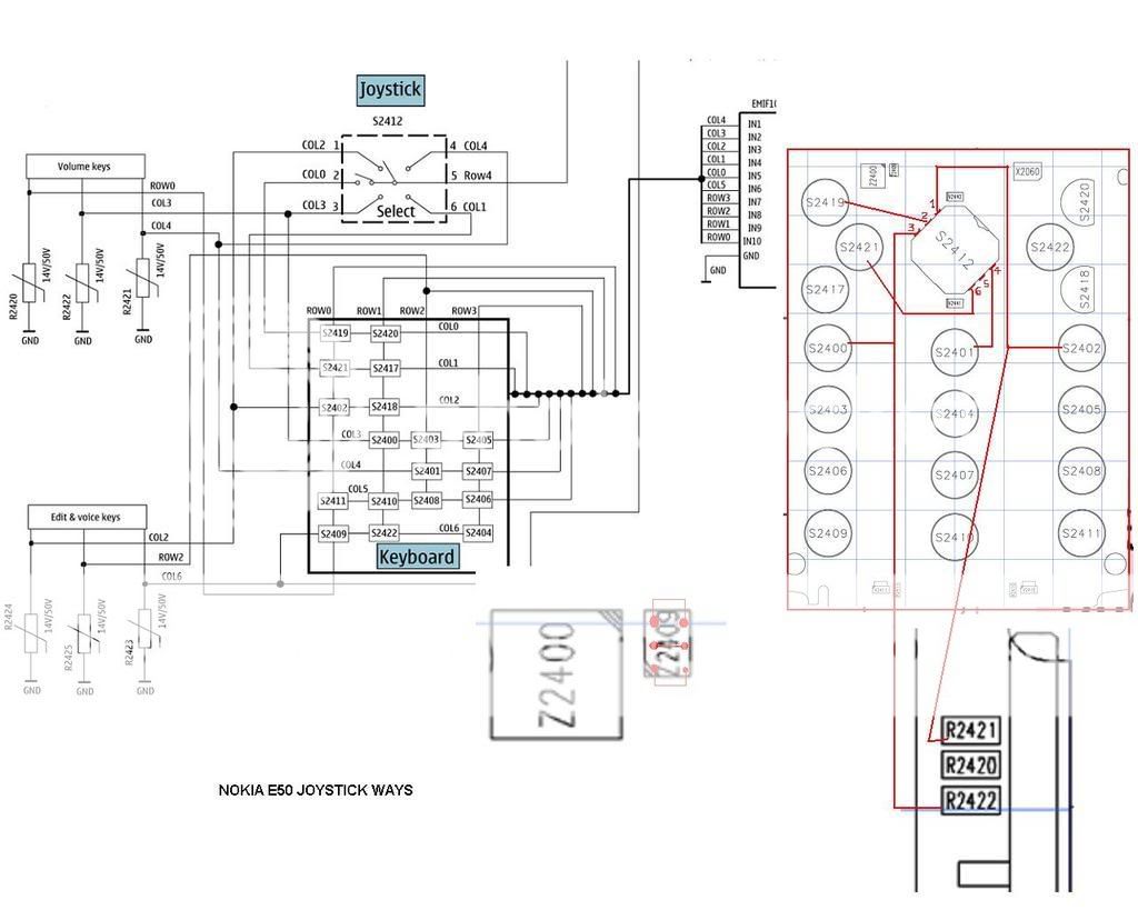

N NANAIU Well-known Member Joined Oct 15, 2010 Posts 2,734 Likes 63 Location BD Oct 15, 2010 #42 e50 joystick way

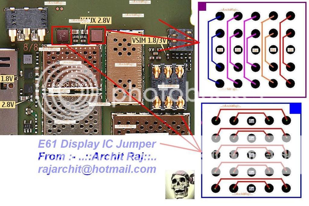

N NANAIU Well-known Member Joined Oct 15, 2010 Posts 2,734 Likes 63 Location BD Oct 15, 2010 #43 E61 Display IC Jumper

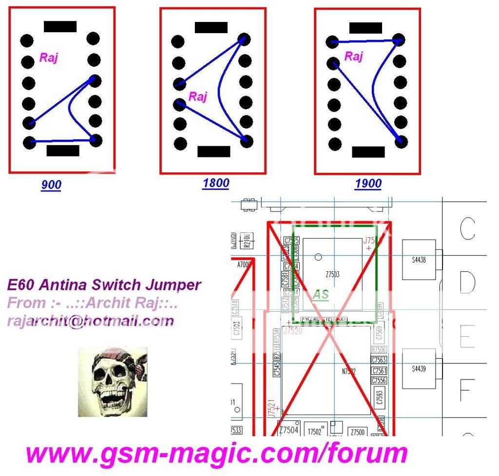

N NANAIU Well-known Member Joined Oct 15, 2010 Posts 2,734 Likes 63 Location BD Oct 15, 2010 #44 E60_Antina_Switch_Jumper

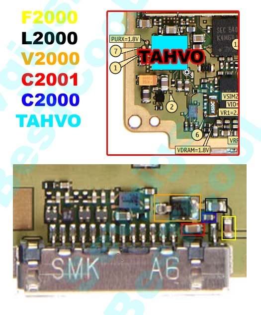

N NANAIU Well-known Member Joined Oct 15, 2010 Posts 2,734 Likes 63 Location BD Oct 15, 2010 #45 E60 charge ways
