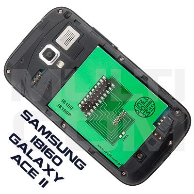

JTAG Samsung i8160/i8160P (Galaxy Ace 2)
Link to product: JTAG Samsung i8160/i8160P (Galaxy Ace 2)
Link to YouTube movie from repair process usign JIG: Samsung i8160/i8160P (Galaxy Ace 2) - JTAG/RIFF connection unbrick (repair dead boot) - YouTube

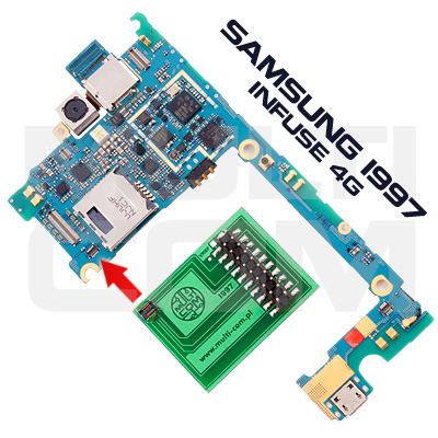

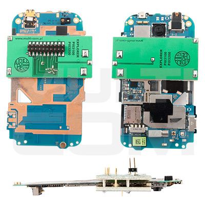

JTAG Samsung I997 (Infuse 4G)

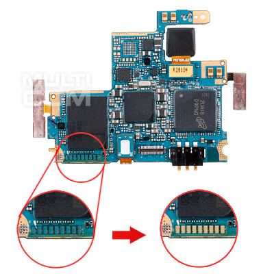

NOKOUT:
Adapter need to connect to molex connector on phone board - in 90% of cases PCB don't have this connector installed so you need to solder as on shown picture special 12 pin molex into it. It's quite simple and for sure simpler that soldering wries - after this you can install JTAG adapter to repair as shown on video. You can buy additional molex connectors in future
Link to product: JTAG Samsung I997 (Infuse 4G)
Link to YouTube movie from repair process usign JIG: Samsung I997 (Infuse 4G) - JTAG/RIFF connection unbrick (repair dead boot) - YouTube

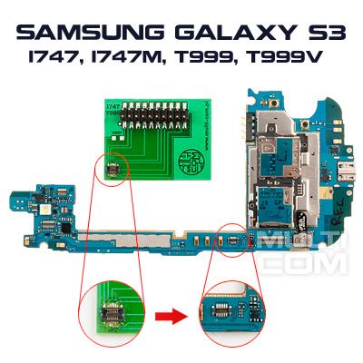

JTAG Samsung I747/I747M/T999/T999V (Galaxy S3)
Link to product: JTAG Samsung I747/I747M/T999/T999V (Galaxy S3)
Link to YouTube movie from repair process usign JIG: Samsung I747/I747M/T999/T999V (Galaxy S3) - JTAG/RIFF connection unbrick (repair dead boot) - YouTube
NOKOUT:
Adapter need to connect to molex connector on phone board - in 90% of cases PCB don't have this connector installed so you need to solder as on shown picture special 20 pin molex into it. It's quite simple and for sure simpler that soldering wries - after this you can install JTAG adapter to repair as shown on video. You can buy additional molex connectors in future
