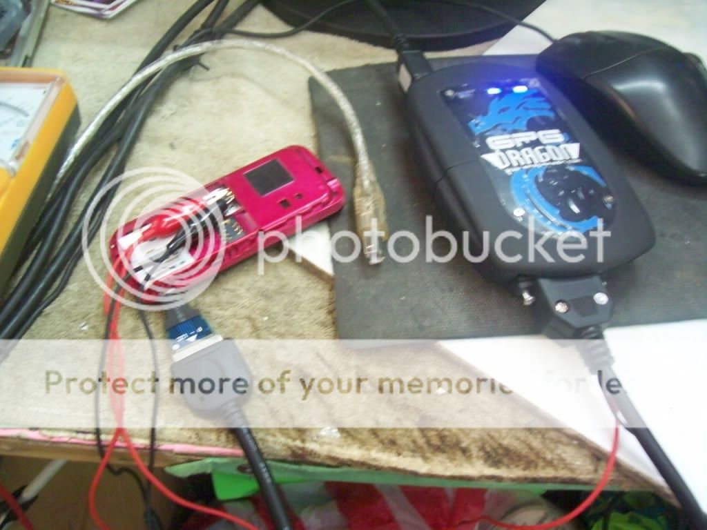

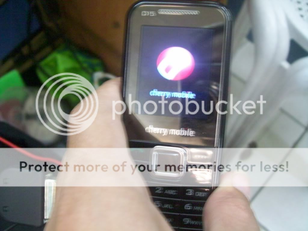

I IM SECOND, CHERRY MOBILE M33 PHONE LOCK DONE
SEE SOME TIPS

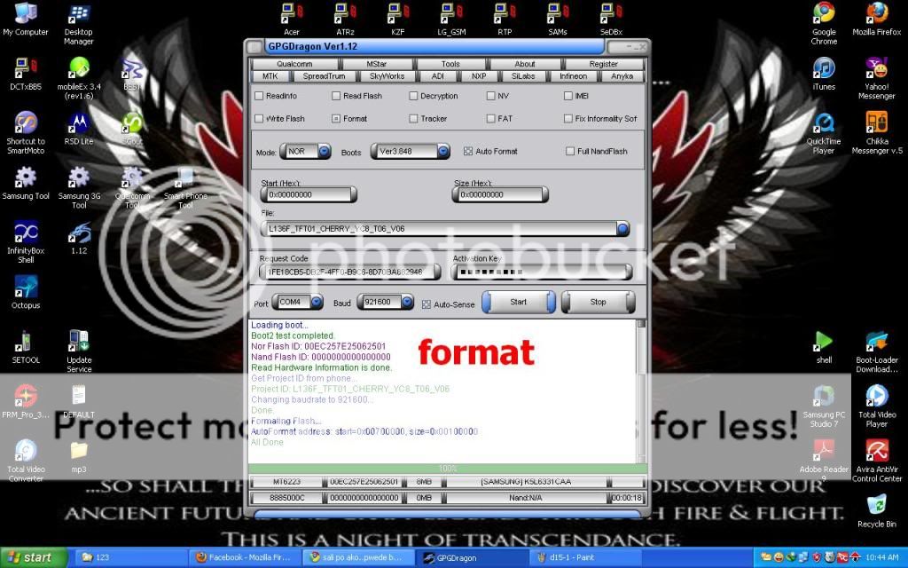

boot 3.8 says
Initializing...
DA_LIB_VER_2.5.1.2
RXD=6 TXD=8
BB:6253, HardwareVer:8A00, SoftwareVer:8A02
Unsupport CPU, Please select another boot and retry again!
used 3.10 but slow.
read; use intRAM
track code
Jonab Ru
Super Moderator
Feb 3, 2011
1,838
6
nitializing...
DA_LIB_VER_2.5.1.2
RXD=4 TXD=5
Loading boot...
Loading boot...
Boot2 test completed.
Nor Flash ID: 00EC257E25082501
Get Project ID from phone...
Project ID: M5171_ZHH_NOKIA_NOTOUCH_KEY55_EN+FR+AR+TU+BO+SP+PO _23QVGA_A02
Done.
Formating Flash...
All Done

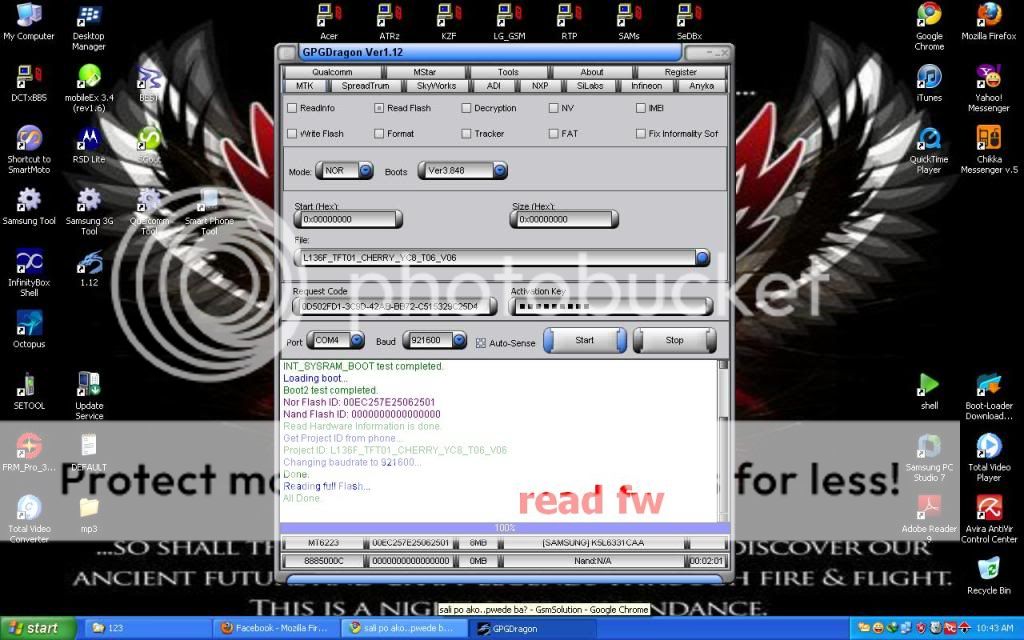

read full flash here..
Initializing...
DA_LIB_VER_2.5.1.2
RXD=5 TXD=8
Connecting...
Connected...sending boot...
FDL test...OK
ArmBootMode: 6600700000020000_01
Done.
Loading bootloader...
Done.
Changing baudrate...
Set baudrate to 921600 ok
Reading phone HW info...
Read info is done.
CPU: SC6600L/WT6226A Flash: NOR_TV00570002xDGB
Set FLASH Parameters...
Settings have been completed!
Reading Flash...
All Done.
