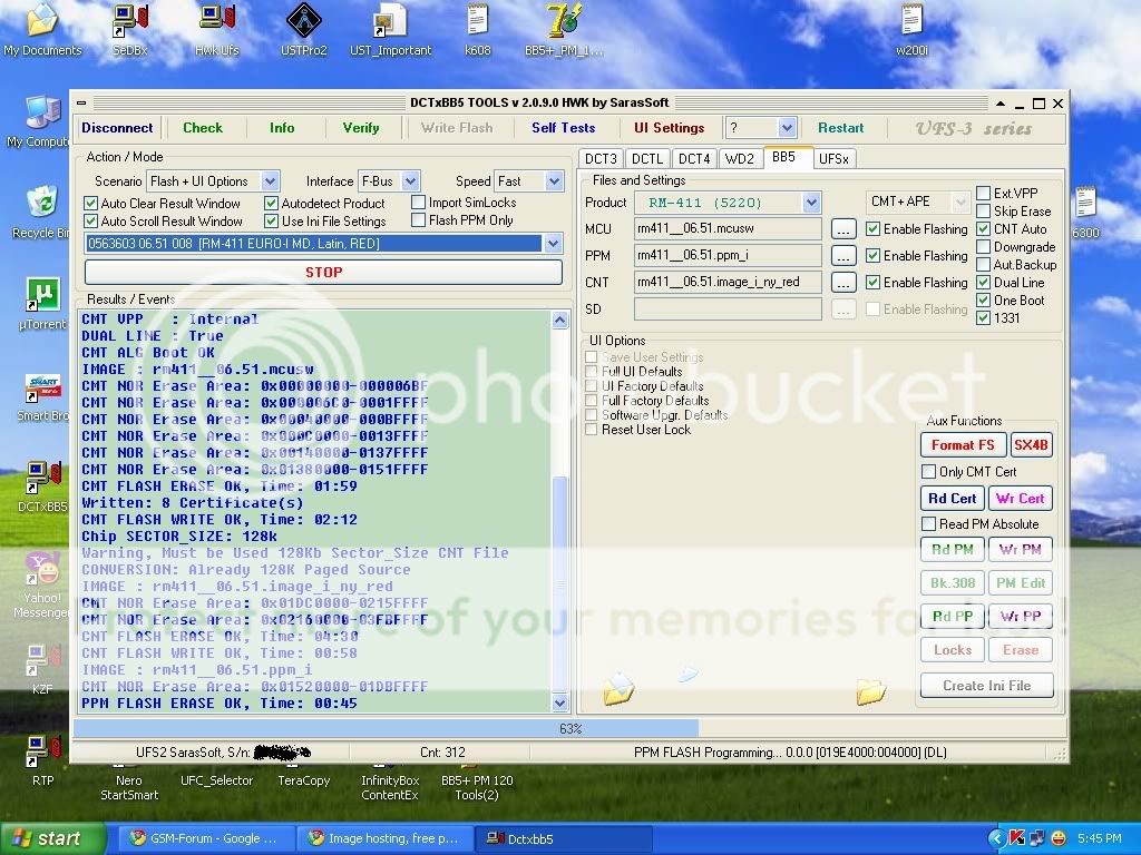

5220 nokia logo successfully done via flashing by hwkhere in successfully done by hwk via flashing
1ST BOOT : C0,07 [Rm-411] [2.0.9.0]
RAPx ID : 000000010000022600010006030C192101033000
EM 1 ID : 00000295
EM 2 ID : 00000B22
RAPx PBID : 14A00219E0990254E37252593773D6EE1B64B8E0
RAPx MODE : 00
RAPx HASH : 9DDBFCFE6E73CED7D8C6268C8EB85723
RAPx ROID : 273F6D55DFAAF68F
CMT 1ST Boot OK
CMT FLID0 : 00898982-00008A31, Int NU48F512
CMT MCID0 : FFFF0000-00000000
CMT 2ND Boot OK
CMT KSIG0 : D93826B23E9B093BE4DD7304FBAA6778996AE60B
CMT VPP : Internal
DUAL LINE : True
CMT ALG Boot OK
IMAGE : rm411__06.51.mcusw
CMT NOR Erase Area: 0x00140000-0137FFFF
CMT NOR Erase Area: 0x01380000-0151FFFF
CMT FLASH ERASE OK, Time: 01:59
Written: 8 Certificate(s)
CMT FLASH WRITE OK, Time: 02:12
Chip SECTOR_SIZE: 128k
IMAGE : rm411__06.51.image_i_ny_red
CMT NOR Erase Area: 0x01DC0000-0215FFFF
CMT NOR Erase Area: 0x02160000-03FBFFFF
CNT FLASH ERASE OK, Time: 04:30
CNT FLASH WRITE OK, Time: 00:58
IMAGE : rm411__06.51.ppm_i
CMT NOR Erase Area: 0x01520000-01DBFFFF
PPM FLASH ERASE OK, Time: 00:45
PPM FLASH WRITE OK, Time: 00:49
MCU SW : V 06.51 23-03-09 RM-411 (c) Nokia
PPM SW : V 06.51 23-03-09 RM-411 (c) Nokia I
Prd.Code: 0563658
Bpr.Code: 0554881
Prod.Sn : DTB859457
HW Vers : 1000
EM VILMA: 15
EM BETTY: 22
RFIC Ver: 064c0601
DSP Vers: ICPR72_08w48
LCD Type: SHARP
IMEI : 353662-*********
SL Serv : SIMLOCK SERVER
SL Conf : 244-07-00000000000
SL Prof : 0000000000000000
SL Count: 00 00
Provider: Nokia Test;Finland
UI Defaults Ok, Time: 00:11
This image has been resized. Click this bar to view the full image. The original image is sized 1024x768.

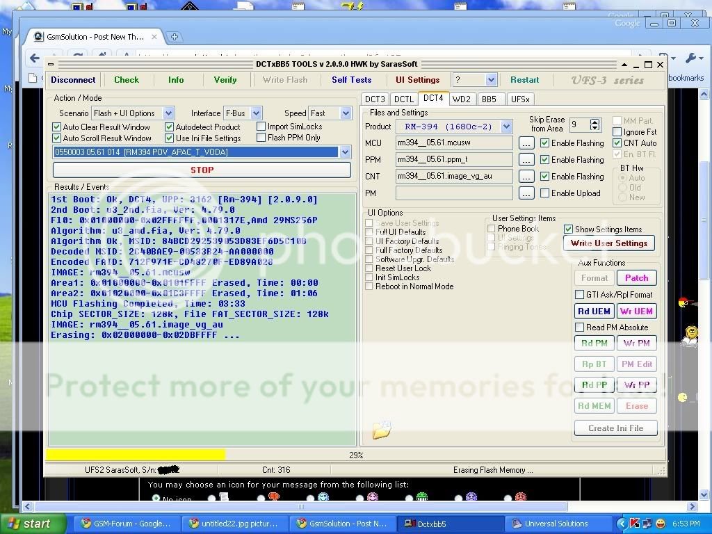

answer: Successfully Unlocked / Flashed Phones By hwk
1680c white screen successfully done via flashing
1st Boot: Ok, DCT4, UPP: 3162 [Rm-394] [2.0.9.0]
Fl0: 0x01000000-0x02FFFFFF,0001317E,Amd 29NS256P
Algorithm Ok, MSID: 84BCD292539053D83EF6D5C10B
Decoded MSID: 2C40BAE9-00533B24-AA000000
Encoded FAID: 712F971E-CD48270F-ED89A028
IMAGE: rm394__05.61.mcusw
Area2: 0x01020000-0x01C3FFFF Erased, Time: 01:06
MCU Flashing Completed, Time: 03:33
IMAGE: rm394__05.61.image_vg_au
Area1: 0x02000000-0x02DBFFFF Erased, Time: 01:27
Area2: 0x02DC0000-0x02F9FFFF Erased, Time: 00:12
CNT Flashing Completed, Time: 01:34
Running: Nokia File Server
Contents Package Extracting Ok, Time: 00:08
Algorithm Ok, MSID: 842327E0FCD91518AEB3F3E655
Decoded MSID: 3E4EBAE9-00533B24-A9000000
Encoded FAID: 72135E34-B24B4383-4F32B2A3
IMAGE: rm394__05.61.ppm_af
Area1: 0x01C40000-0x01FFFFFF Erased, Time: 00:21
PPM Flashing Completed, Time: 01:06
MCU SW : V 05.61 18-04-08 RM-394 (c) Nokia
PPM SW : V 05.61 18-04-08 RM-394 (c) Nokia AF
Prd.Code: 0566420
Bpr.Code: 0556746
Prod.Sn : HAA249837
HW Vers : 1000
UEM : 1328
UPP : 12642 [3162]
RFIC Ver: 0500
DSP Vers: P06w45.v48
LCD Type: SUEZ
IMEI : 353527-02*********
SL Conf : 555-55-55555555555
SL Prof : 555555555501555-5
SL Var : 00553535270213152400
SL Aux : 000B5555
HW Sig : 9488EEC88566855F
Box Id : FFFFFFFFFFFFFFFF
SL Data Corrupted
Provider: Not Found
IMEI: 353527-02-********, ASIC: 11
FILE: rm394__05.61.mcusw
PAT Flashing Completed, Time: 00:02
IMEI: 353527-02**********, ASIC: 11
UNP Flashing Completed, Time: 00:05
SimLocks Initialized, Time: 00:50
Prd.Code: 0566420
Bpr.Code: 0556746
Prod.Sn : HAA249837
HW Vers : 1000
UEM : 1328
UPP : 12642 [3162]
RFIC Ver: 0500
LCD Type: SUEZ
IMEI : 353527-************
SL Conf : 001-01-00000000000
SL Prof : 800000000001000-B
SL Aux : 000B5555
Provider: GSM Test Equipment
and SL data repair
