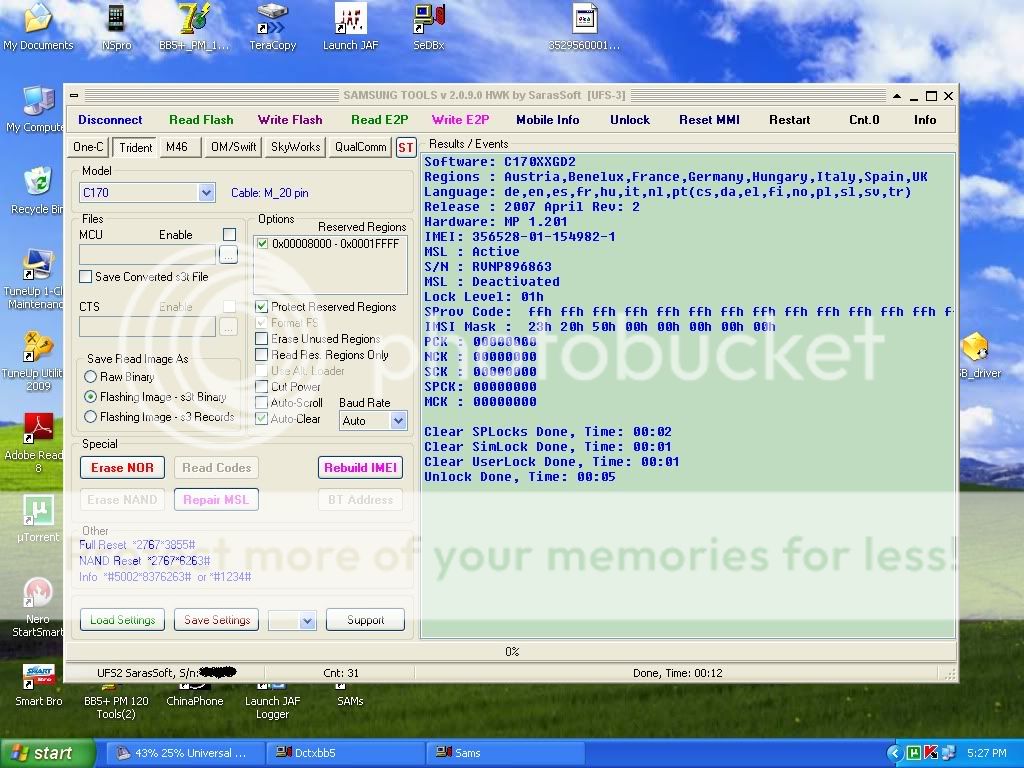

answer: Successfully Unlocked / Flashed Phones By hwk
C170 SAMSUNG UNLOCK SUCCESSFULLY 5000 pecies
Software: C170XXGD2
Regions : Austria,Benelux,France,Germany,Hungary,Italy,Spain ,UK
Language: de,en,es,fr,hu,it,nl,pt(cs,da,el,fi,no,pl,sl,sv,tr )
Release : 2007 April Rev: 2
Hardware: MP 1.201
IMEI: 356528-01***********
MSL : Active
S/N : RVNP896863
MSL : Deactivated
Lock Level: 01h
SProv Code: ffh ffh ffh ffh ffh ffh ffh ffh ffh ffh ffh ffh ffh ffh ffh ffh ffh ffh ffh ffh
IMSI Mask : 23h 20h 50h 00h 00h 00h 00h 00h
PCK : 00000000
NCK : 00000000
SCK : 00000000
SPCK: 00000000
MCK : 00000000
Clear SPLocks Done, Time: 00:02
Clear SimLock Done, Time: 00:01
Clear UserLock Done, Time: 00:01
Unlock Done, Time: 00:05
This image has been resized. Click this bar to view the full image. The original image is sized 1024x768.
