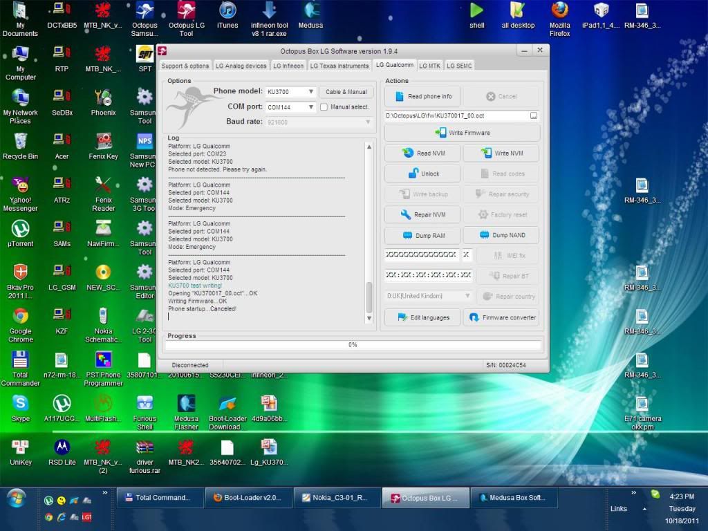

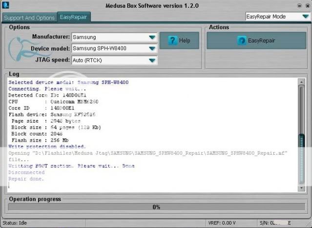

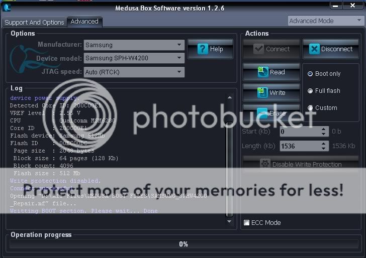

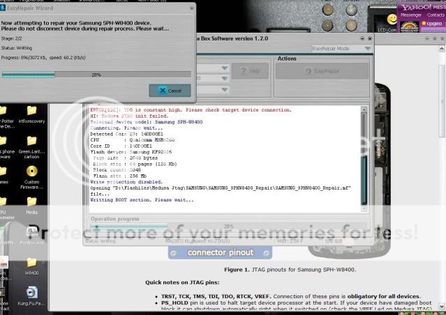

Repair Dead Boot Samsung Anycall W8400 done..

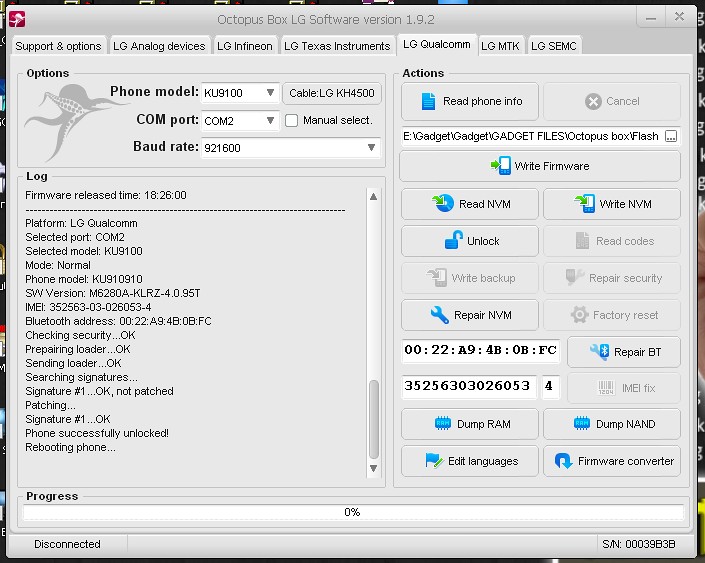

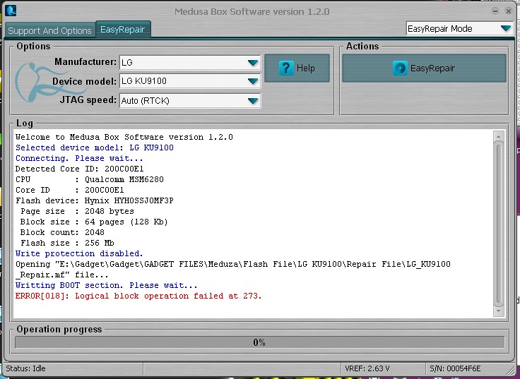

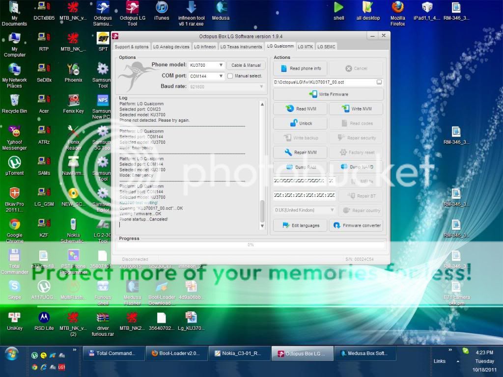

LG Cyon KU9100 Deadboot [Solve]
Tool's;

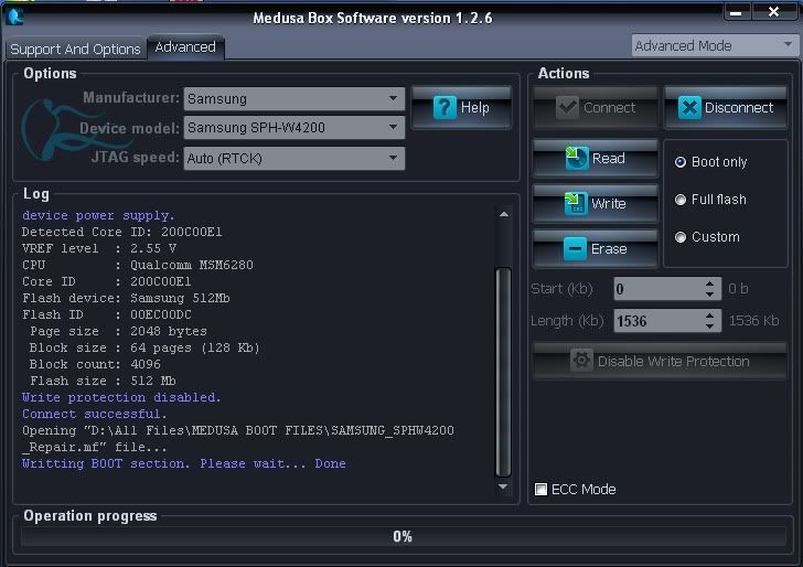

-Mebusa Box
-Octopus Box
Procedure;

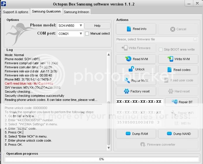

-Repair In Medusa Box First
-Reflash In Octopus Box

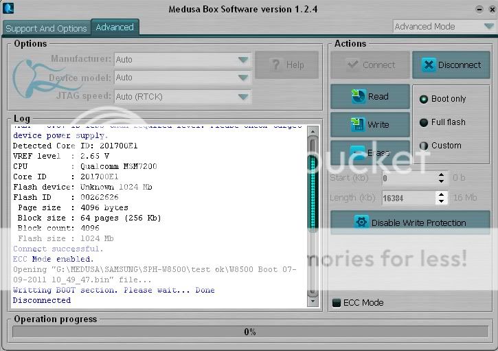

Wella;

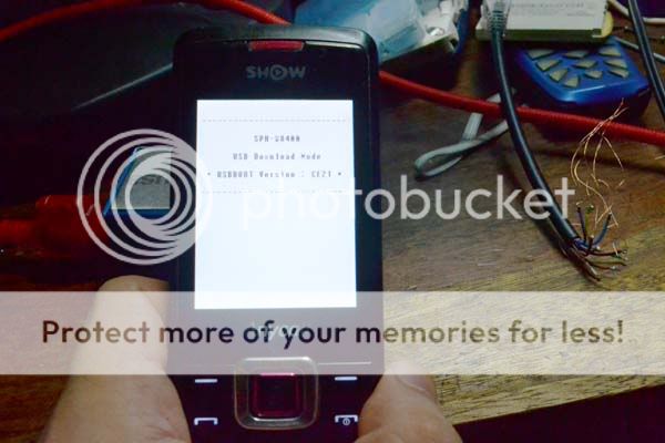

Success repair boot SPH-W2400 by Medusa Box
1. Select SCh-W240 after repair boot enter then flash full file from Backup
Selected device model: Samsung SCH-W240
Connecting. Please wait...
MI: RTCK reaction time 126 ns.
Detected Core ID: 300600E1
VREF level : 2.73 V
CPU : Qualcomm MSM6275
Core ID : 300600E1
MI: Loading server.
MI: Starting server.
MI: Received status 0x0000F00F, cycle 0.
MI: Received server capabilities 0x00000035.
MI: Detailed server caps: FLASH, ECC, WDOG, DWP
MI: Watchdog are preconfigured.
MI: Server init.
MI: Received flash ID 0x0000EC71.
MI: Flash geometry set.
MI: Recheking settings... ok
Server caps : 00000035
Flash device: Samsung KBE00S00AM
Flash ID : 0000EC71
Page size : 512 bytes
Block size : 32 pages (16 Kb)
Block count: 16384
Flash size : 256 Mb
Connect successful.
ECC Mode enabled.
Opening "E:\1_FW\RepairBoot\Medusa\SPH-W2400\SPH-W2400\Samsung SPH-W2400 FullFlash 13-09-2011 12_14_35.bin" file...
Writting BOOT section. Please wait... Done
Writting FIRMWARE section. Please wait... Done
Boot file only download below
Samsung SPH-W2400 Boot 13-09-2011 13_10_28.rar

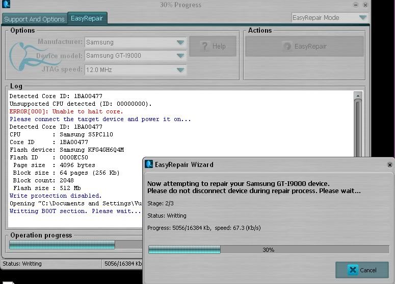

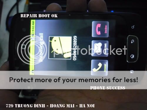

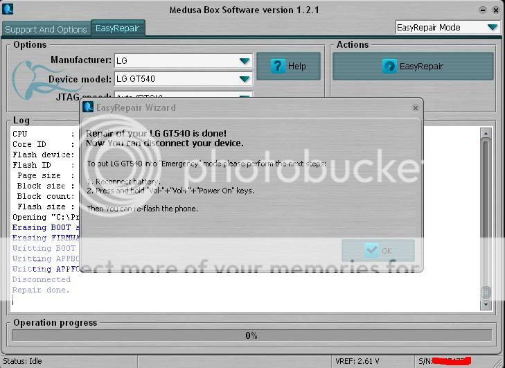

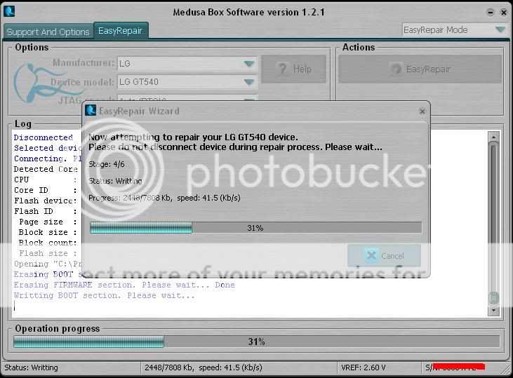

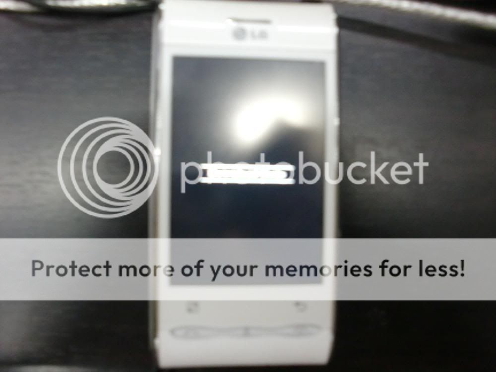

LG GT540 Dead Boot Success

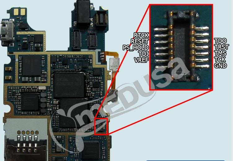

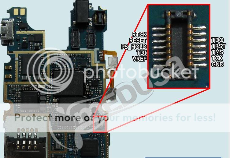

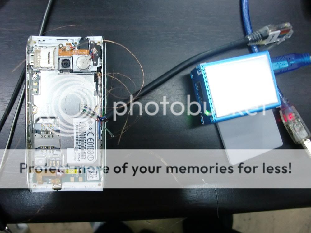

Procedure:
Connect Pins to PCB
Use Easy Repair Mode
Click Flash Boot
Wait until finish writing Boot
Flashing boot
Flash boot Done

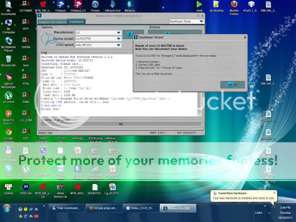

Ku3700 korea repair boot ok by medusa.
Flash phone ok by octopus.
phone ok all.

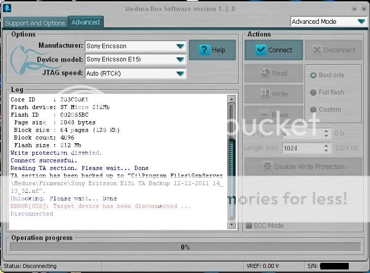

Xperia E15a Unlock OK
Bienvenido en Medusa Box Software versi?n 1.2.5
Modelo del dispositivo seleccionado: Sony Ericsson E15a
Conexion...
Insuficiente nivel de voltaje VREF = 0.0 ?. Por favor, chequee el estado de alimentaci?n del dispositivo.
Detected Core ID: 203C00E1
Nivel de VREF : 2.61 V
Tipo del n?cleo : Qualcomm MSM7227
ID del nucleo: 203C00E1
Tipo de la flash: Micron 512Mb
ID de la flash: 00002CBC
Tama?o de la pagina: 2048 bytes
Tama?o del bloque: 64 p?ginas (128 Kb)
Cantidad de los bloques : 4096
Tamaño total de la flash : 512 Mb
L a protecci?n contra escritura est? desactivada.
Conexion exitosa
Lectura de la secci?n TA. Por favor, espere... Terminado
TA section has been backed up to "C:\Archivos de programa\GsmServer\Medusa\Firmware\Sony Ericsson E15a TA Backup 16-11-2011 09_32_27.mf".
Unlocking. Please wait... Terminado
Desconectado.
