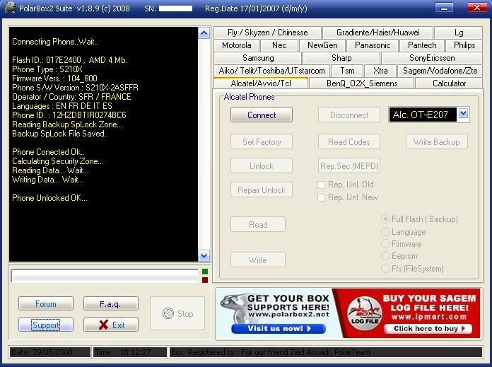

S210 unlocked OK

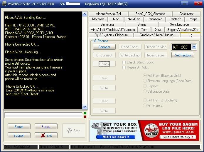

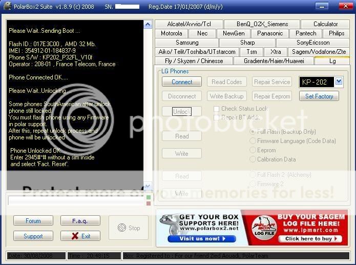

LG KP202 UNLOCKED OK

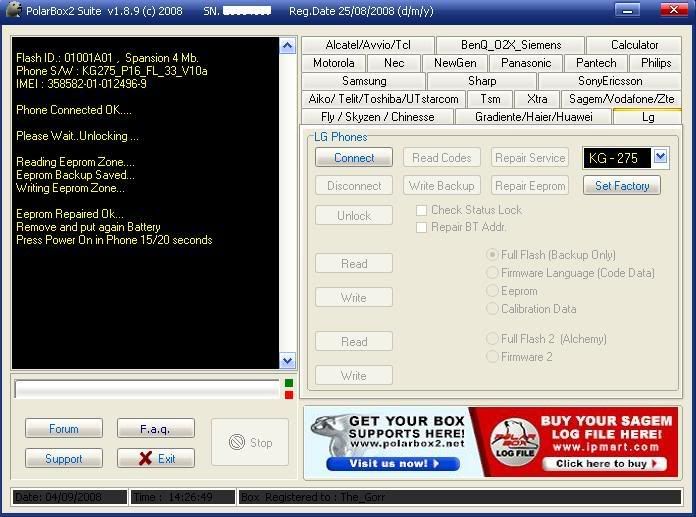

Lg KG 275 damaged eeprom by other box and repaired/unlocked success with polar

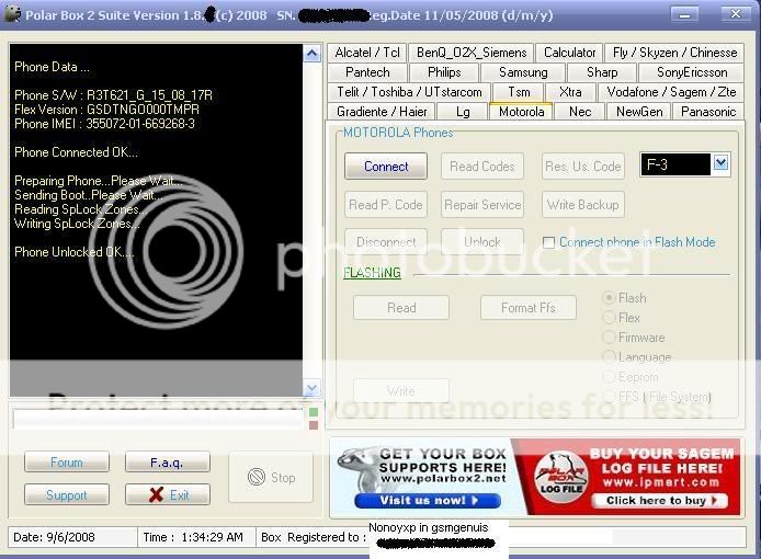

tested F3 lock in t-mobile

KG-290
Please Wait..Sending Boot ...
Flash ID.: 89160101 , Intel 32 Mb.
IMEI : 357456-01-222xxx-1
Phone S/W : KG290_P40FL_V10c
Phone Connected OK....
Please Wait..Unlocking ...
Some phones SouthAmerican after unlock
phone still locked.
You must flash phone using any Firmware
in polar support.
After this, repeat unlock process and
phone will be unlocked
Phone Unlocked OK....
Enter 2945***** without a sim inside
and select 'Fact. Reset'.

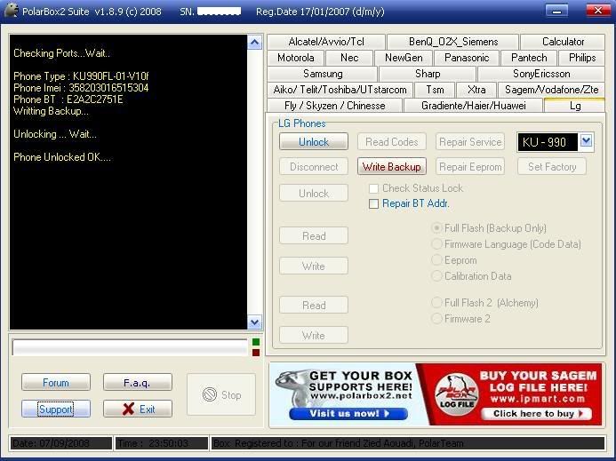

lg ku990 v10f unlocked OK

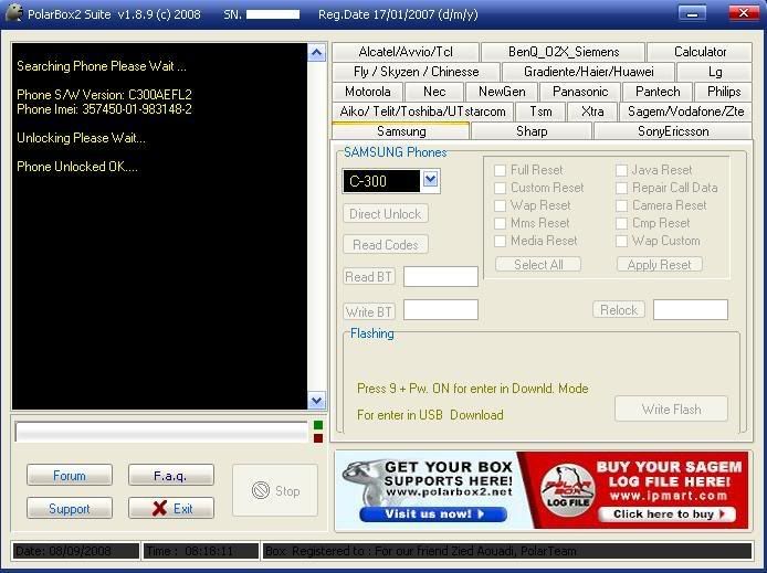

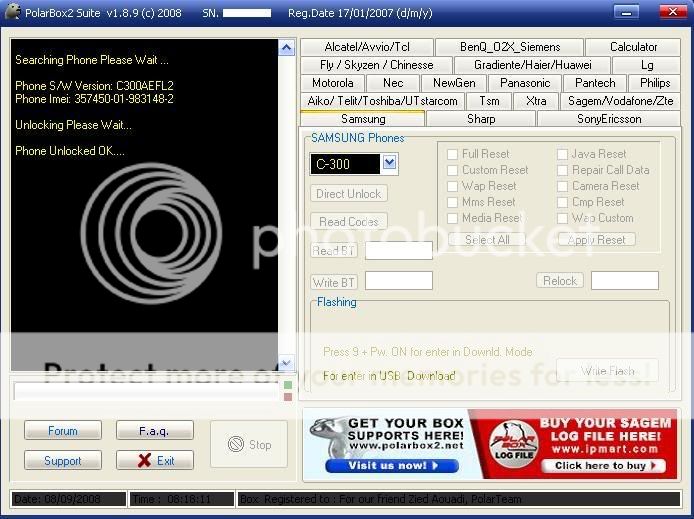

SAMSUNG C300 UNLOCK OK

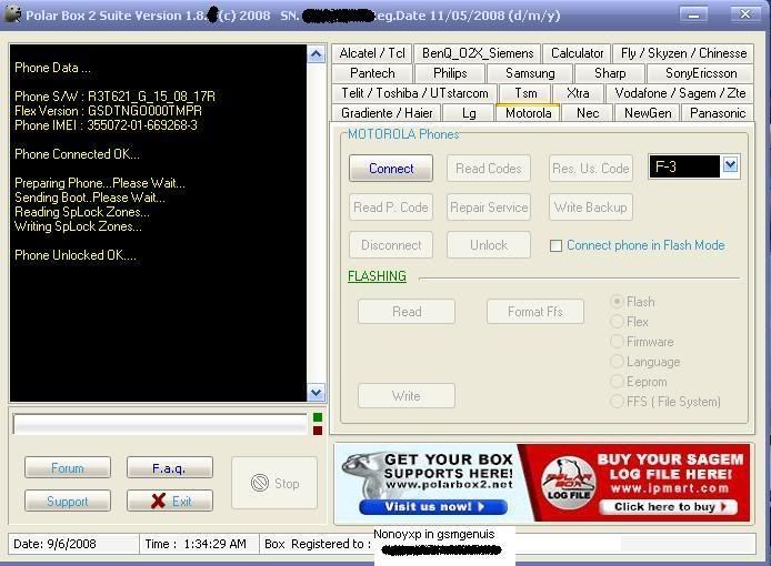

Motorola w205 unlocked ok
Connecting ...
Flash ID.: 89740100 , Intel 16 Mb.
Phone IMEI : 35***********
Phone Type : MOTOROLA_H85
Phone S/W : SW_W205_0_2_73
Phone Flex : FLEX_W205_BF_006_105
Phone L/P : LP_W205_0273_T03
Making Eeprom Backup......OK
Writing SpLock zone......OK

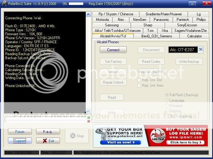

Alcatel E207x unlock ok.
Connecting Phone..Wait..
Flash ID.: 017E2400 , AMD 4 Mb.
Phone Type : E207X
Firmware Vers. : 301_100
Phone S/W Version : E207X-2ASFFR
Operator / Country: SFR / FRANCE
Languages : EN FR DE IT ES
Phone ID. : 13HZ8BQPQA736EB6
Phone Conected Ok..
Calculating Security Zone...
Reading Data... Wait...
Writing Data... Wait...
Laruae
Oct 15, 2010
2,351
30
Motorola W205 unlock ok.
Connecting ...
With Polar suite 1.8.9
