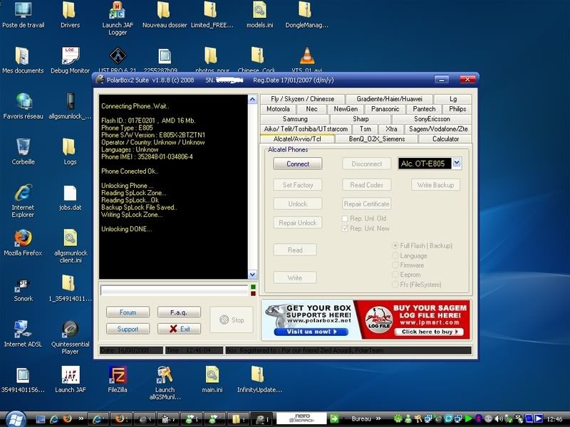

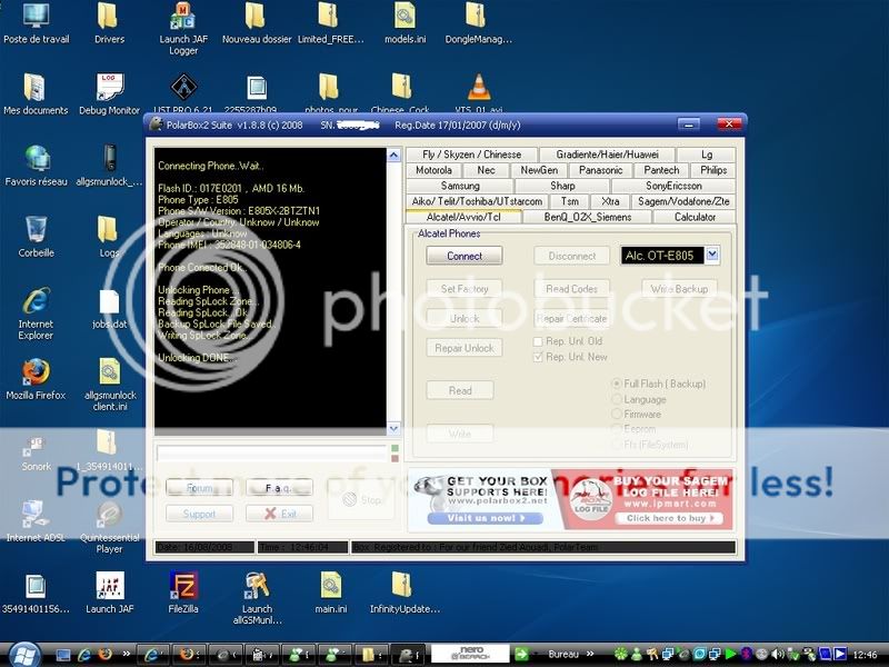

Alcatel E805 unlock ok
This image has been resized. Click this bar to view the full image. The original image is sized 800x600.

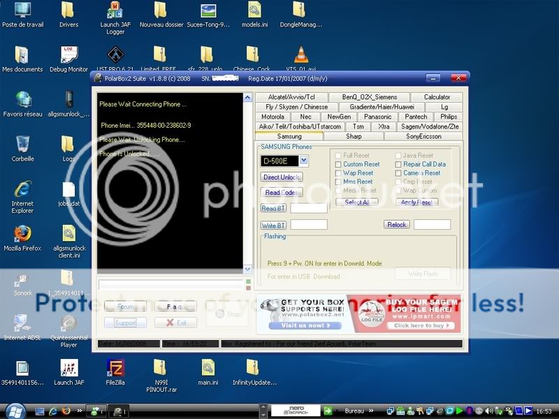

samsung D500E unlock OK

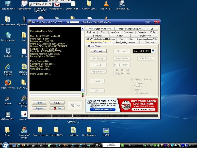

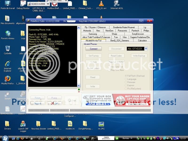

E221 unlocked OK
