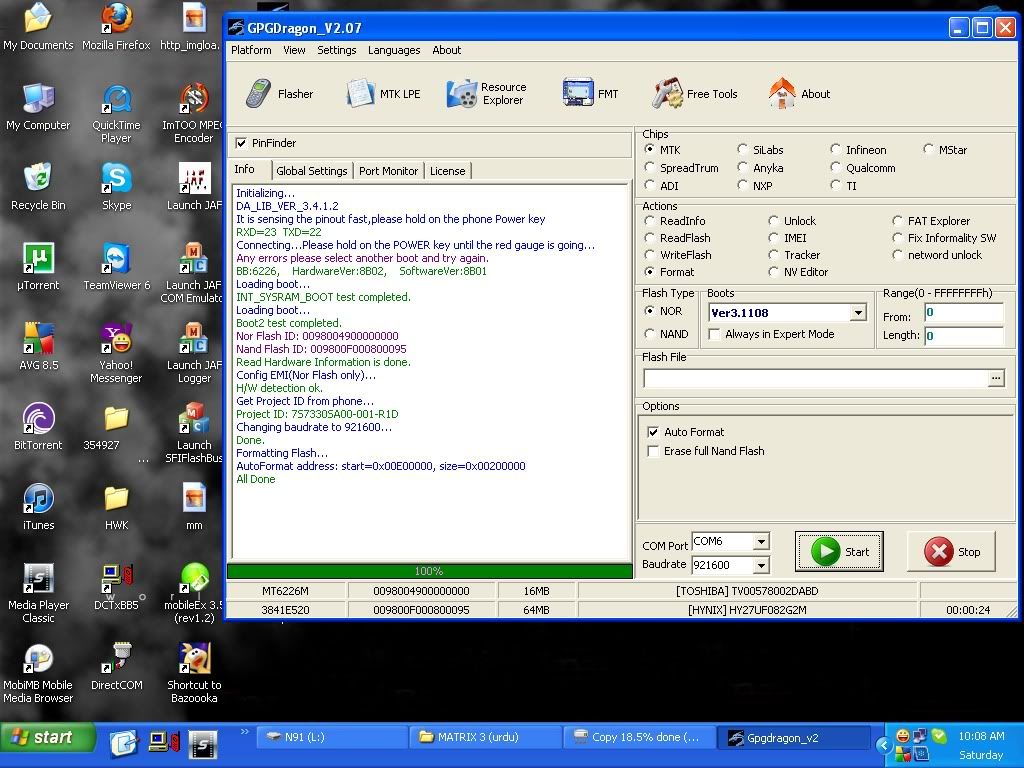

It is sensing the pinout fast
RXD=4 TXD=3
Connecting
Connected...sending boot...
FDL test...OK
ArmBootMode
: 6600700100026A00_01
Wait
for init Commzero Security Engine...
Done.
Loading bootloader...
Done.
Changing baudrate...
Set baudrate to 921600 ok
Reading phone HW info
Read info is done.
CPU: SC6600L2 Flash: NOR_K5L2731CAM
setting the Flash Parameters
Settings have been completed!
Unlock Done.
Programming...
Compare Image: Enable
All Done

lephone u505 flashed
Initializing...
DA_LIB_VER_3.4.1.2
D-=9 D+=11
Connecting...
Spd USB-to-Serial=COM17
FDL test...OK
ArmBootMode: 6600700100005A00_01
Done.
Done.
Reading phone HW info...
Read info is done.
CPU: SC6600L2 Flash: NOR_ST_M58WR064KT
setting the Flash Parameters...
Reading FileSystem info...
FileSystem Version: 0A
Start=0x007B0000, Size=0x00040000
Unlock Done.
Auto formatting...
Done.

Q10 CPU 6253 Format done Initializing...
DA_LIB_VER_3.4.1.2
RXD=9 TXD=7
Any errors please select another boot and try again.
BB:6253, HardwareVer:8A00, SoftwareVer:8A04
Loading boot...
Loading boot...
Boot2 test completed.
Nor Flash ID: 00EC240400000000
Config EMI(Nor Flash only)...
H/W detection ok.
Get Project ID from phone...
Project ID: C100A3PLUS.Q10.06.110425.01
Done.
Formatting Flash...
All Done
