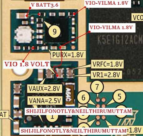

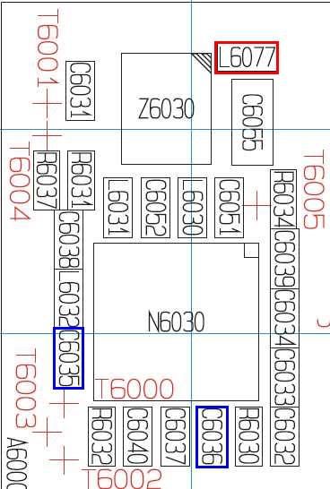

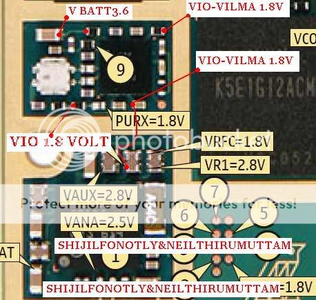

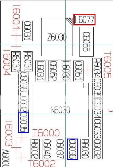

CHECK L6077-VBATT 3.6VOLT
R6030,C6035-VIO 1.8VOLT

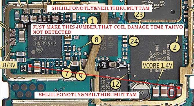

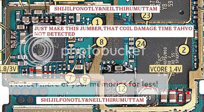

nokia 6233 CMT FLASH NOT DETECTED
FIRST TRY THIS BECOZ TAHVO RUNING VOLTAGE BREAKED THAT COIL DAMAGING......
