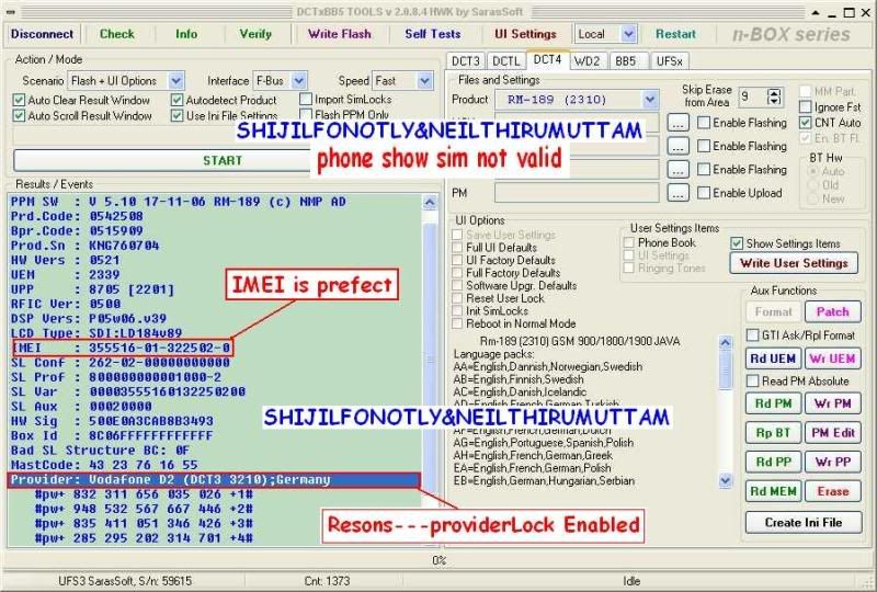

3110c and 6300 both are net work problems some times signal drop and some ttimes out of coverage and some times call ok soloution

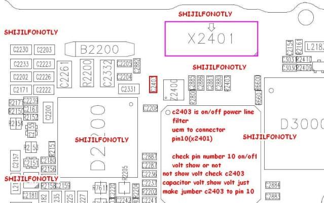

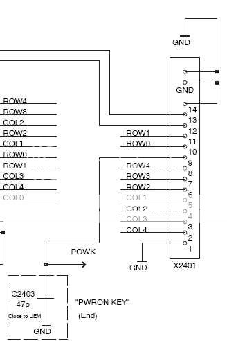

first try to change that capacitor red marked
problem not solved try this

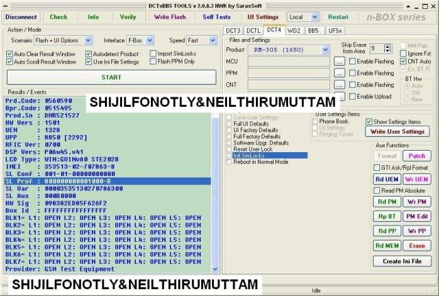

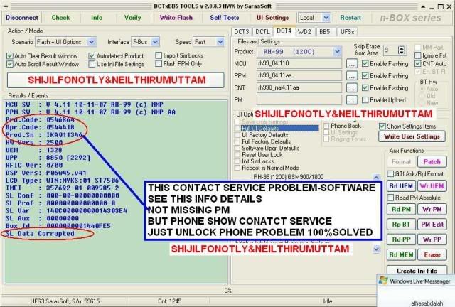

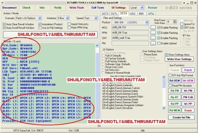

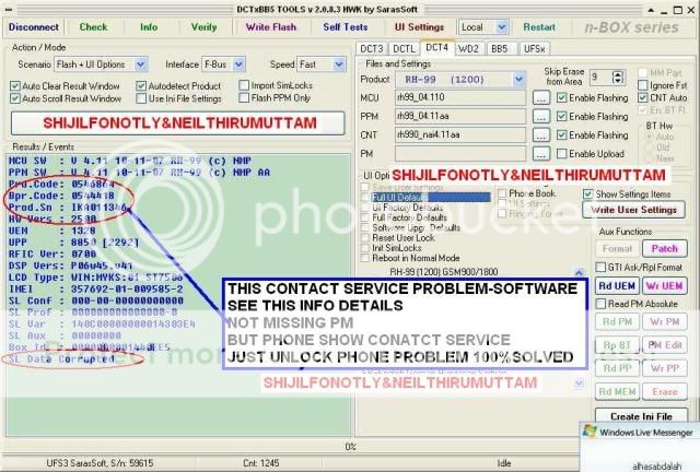

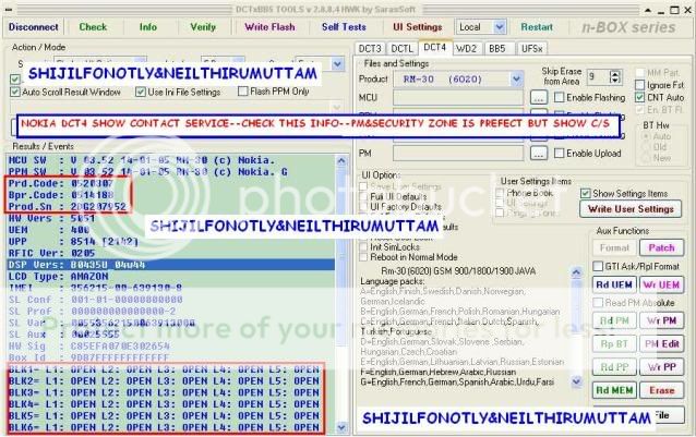

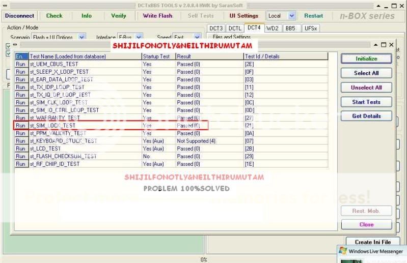

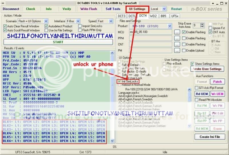

NOKIA DCT4 CONTACT SERVICE HARDWARE OR SOFTWARE EASY TO FIND WITH UFS+HWK
1)CONNECT UFS+HWK
2)SELECT DCT4 TAB
3)USE INFO BUTTON(SOME TIMES PHONE NOT ENTER LOCAL MODE JUST LONG PRESS POWER BUTTON

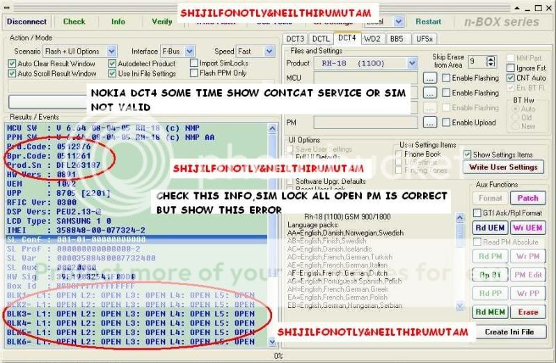

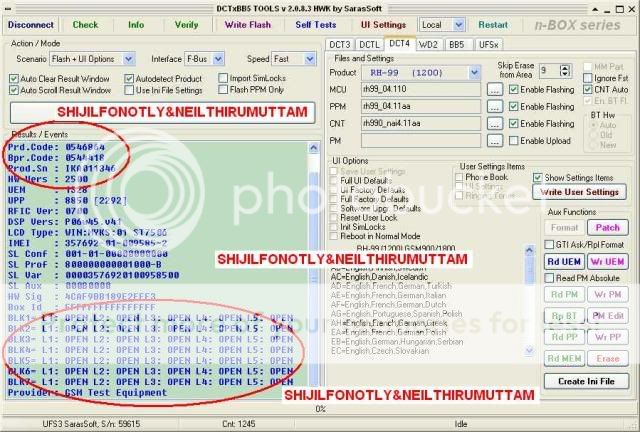

4)CHECK INFO DETAILS
5)SL DATA CORRUPTED(MEANS SIMLOCK ENABLED)
6)JUST UNLOCK PHONE

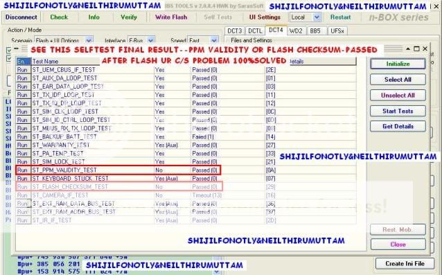

SEE SECOND PICTURE INFO DETAILS 100%DONE.BUT PHONE STILL SHOW CONTACT SERVICE

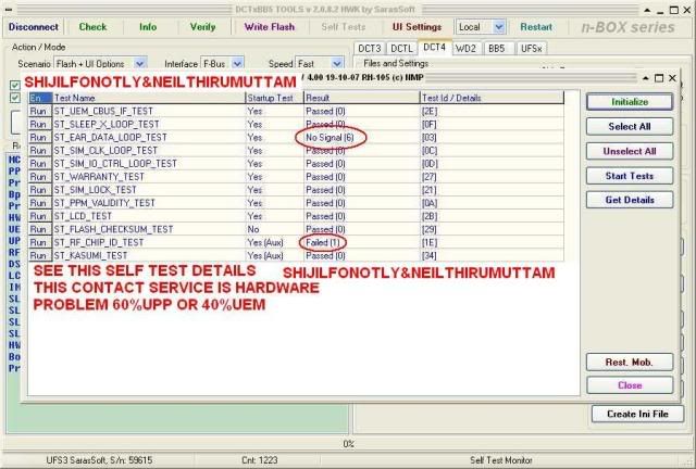

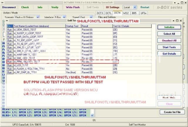

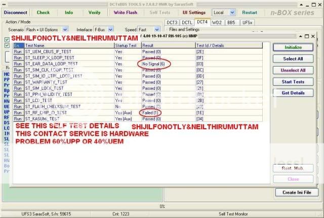

7)CONNECT SET

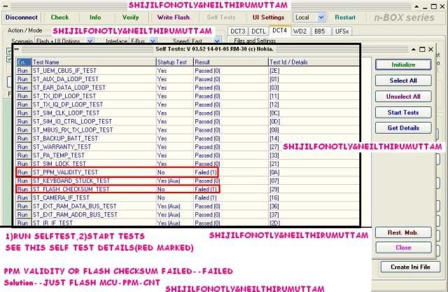

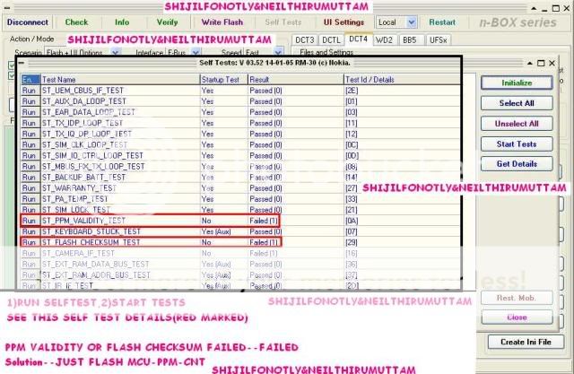

8)RUN SELF TEST
SEE THIS SELF TEST DEIALS

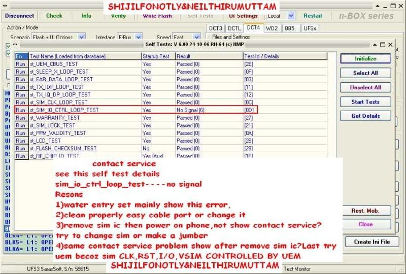

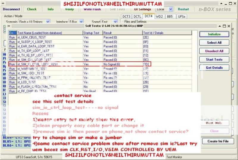

EAR _CLK_LOOP TEST----------NO SIGNAL
RF CHIP ID TEST---------------FAILED
THIS CONTCAT SERVICE HARDWARE PROBLEM
HARDWARE CHANCE
60%UPP
30M
10%OTHERS LIKE BSI ETC...........

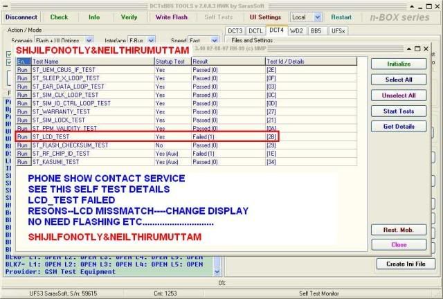

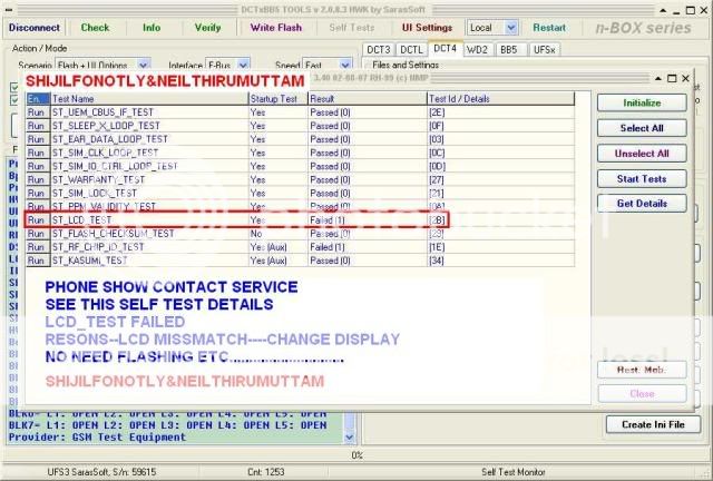

SEE ANOTHER SELF TEST DETAILS
LCD TEST-----------FAILED
RESONS LCD MISSMATCHED
JUST CHANGE DISPLAY NO NEED TO FLASH&UNLOCK ETC.............

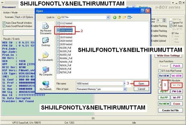

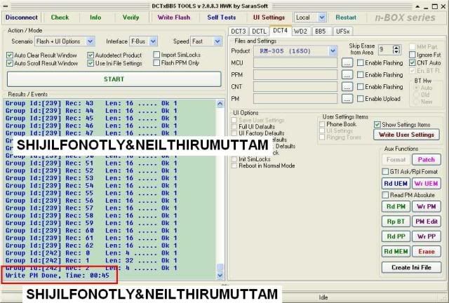

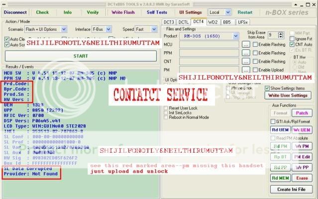

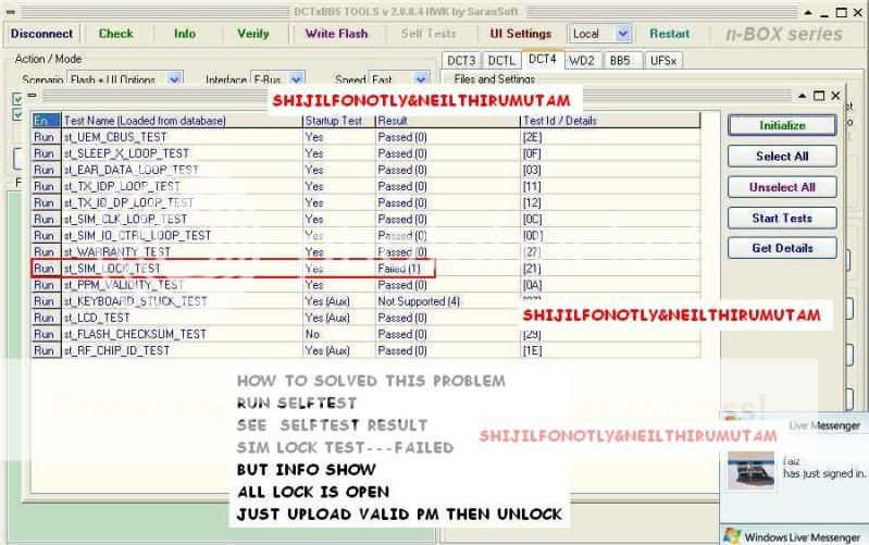

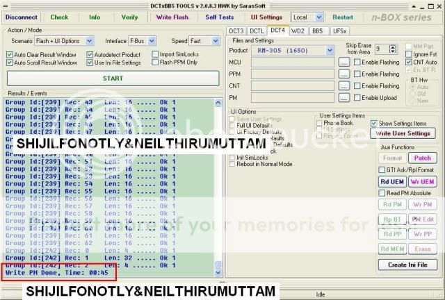

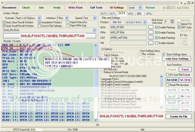

1)CONNECT UFS+HWK
2)USE INFO BUTTON
SEE THIS SCREEN SHOT
SEE THIS RED MARKED AREA.CONTCAT SERVICE RESONS LOST PM FILE

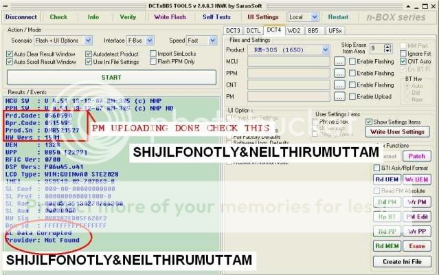

1)UPLOAD PM
UPLOAD DONE!!!

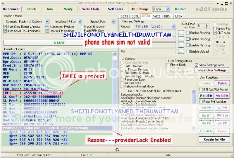

SL DATA CORRUPTED
PROVIDER NOT FOUND
MEANS SIM LOCK ENABLED

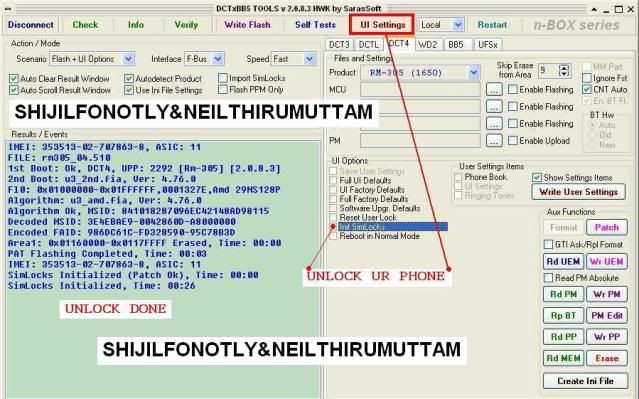

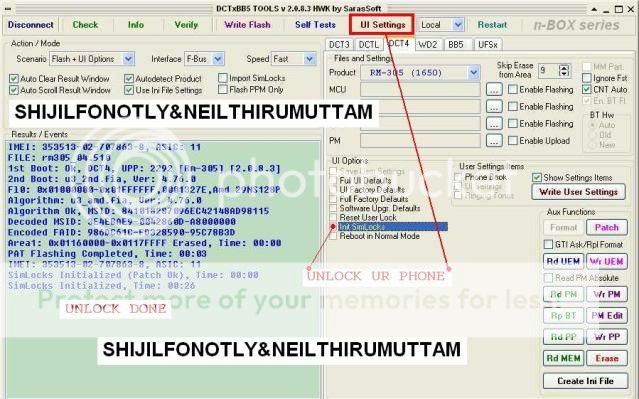

UNLOCK UR PHONE
UNLOCK DONE CONTACT SERVICE PROBLEM SOLVED

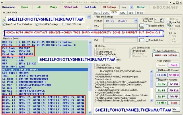

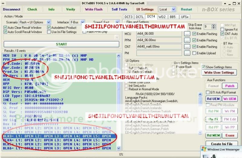

MCU SW : V 5.80 14-11-08 RM-305 (c) NMP
PPM SW : V 5.80 14-11-08 RM-305 (c) NMP AE
Prd.Code: 0547535
Bpr.Code: 0515495
Prod.Sn : DMR262460
HW Vers : 1501
UEM : 1328
UPP : 8850 [2292]
RFIC Ver: 0700
DSP Vers: ICPR62_08w31_UPP
LCD Type: UNKWN: IDs: 00:ff:00
IMEI : 356859-
SL Conf : 000-00-00000000000
SL Prof : 000000000001000-0
SL Var : 00003568590260216300
SL Aux : 000B0000
HW Sig : 86A3608B879651FD
Box Id : FFFFFFFFFFFFFFFF
SL Data Corrupted
Provider: Not Found
for solve contact service need to change lcd and unlock the phone
Nokia 1208 contact service problem here i post selftest screen shot

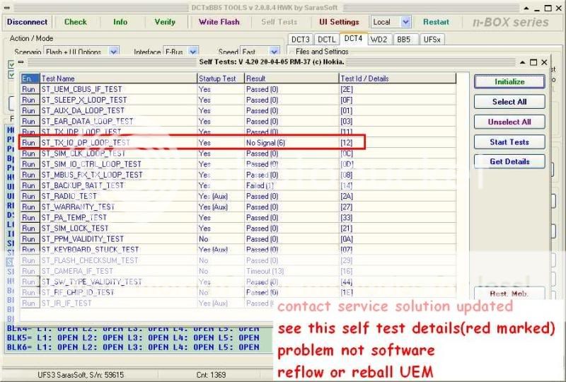

this is not software problems 100%hardware problem
reflow or reball
UEM
nokia 2630 its normal water damage area near uem and keypad connector check set is not on but when plug the charging pin then show charging but not power on soloution is here
