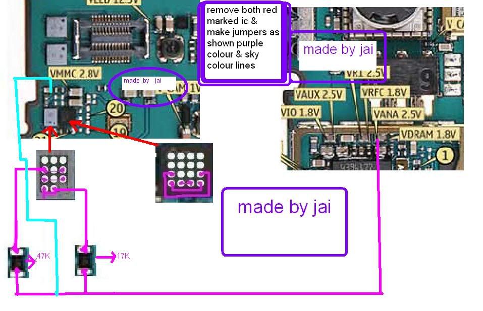

I INSP DDK Well-known Member Joined Sep 7, 2010 Posts 1,638 Likes 28 Mar 10, 2011 #78 6233 mmc solution

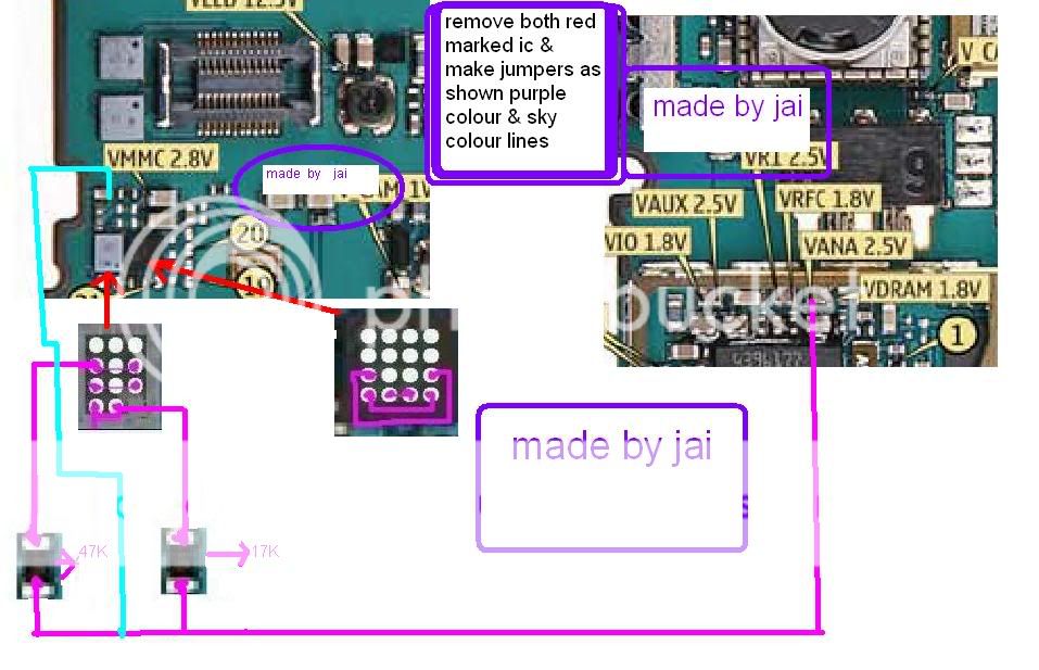

I INSP DDK Well-known Member Joined Sep 7, 2010 Posts 1,638 Likes 28 Mar 10, 2011 #81 c5 mmc solution

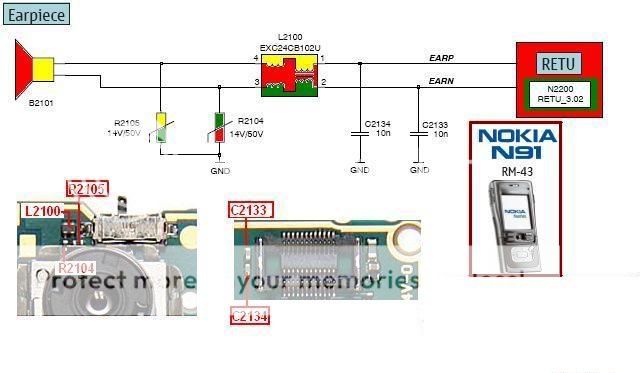

I INSP DDK Well-known Member Joined Sep 7, 2010 Posts 1,638 Likes 28 Mar 10, 2011 #83 n91 speaker ways

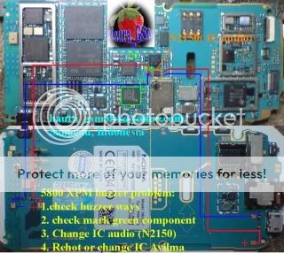

I INSP DDK Well-known Member Joined Sep 7, 2010 Posts 1,638 Likes 28 Mar 10, 2011 #88 5800 XPM audio problem

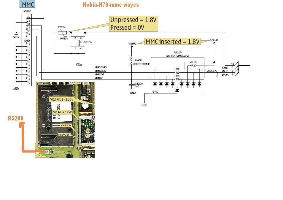

I INSP DDK Well-known Member Joined Sep 7, 2010 Posts 1,638 Likes 28 Mar 10, 2011 #89 n70 handsfree mode

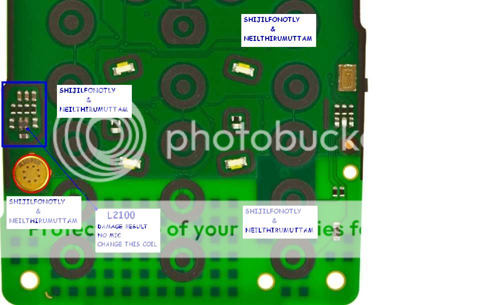

I INSP DDK Well-known Member Joined Sep 7, 2010 Posts 1,638 Likes 28 Mar 10, 2011 #90 Nokia x2 mic Solution
