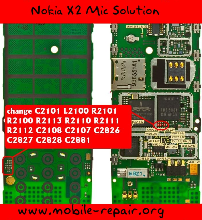

I INSP DDK Well-known Member Joined Sep 7, 2010 Posts 1,638 Likes 28 Mar 10, 2011 #19 X2 Mic problem Click this bar to view the full image.

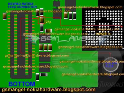

I INSP DDK Well-known Member Joined Sep 7, 2010 Posts 1,638 Likes 28 Mar 10, 2011 #21 Nokia 6233/34 mic ways here Click this bar to view the full image.

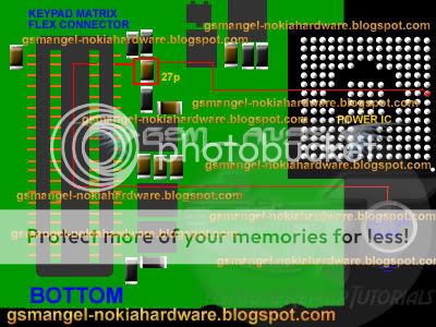

I INSP DDK Well-known Member Joined Sep 7, 2010 Posts 1,638 Likes 28 Mar 10, 2011 #22 e55 mmc solution here Click this bar to view the full image.

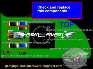

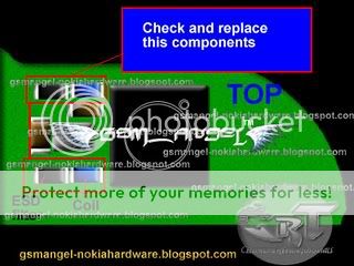

I INSP DDK Well-known Member Joined Sep 7, 2010 Posts 1,638 Likes 28 Mar 10, 2011 #23 210c mic Click this bar to view the full image. Click this bar to view the full image.

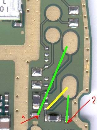

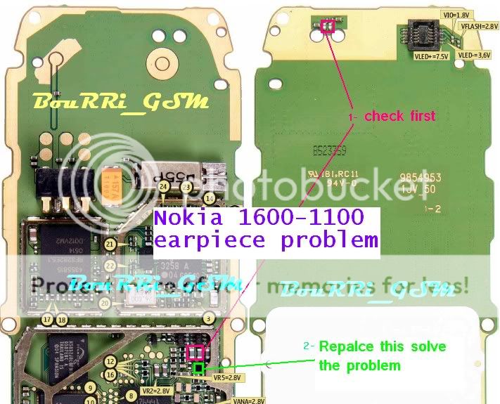

I INSP DDK Well-known Member Joined Sep 7, 2010 Posts 1,638 Likes 28 Mar 10, 2011 #27 1600-1100 earpiece problem Click this bar to view the full image.

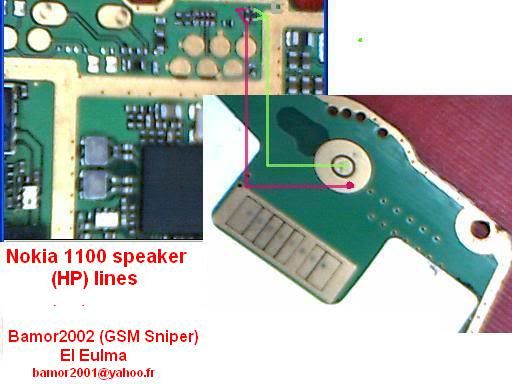

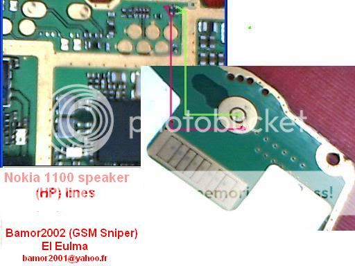

I INSP DDK Well-known Member Joined Sep 7, 2010 Posts 1,638 Likes 28 Mar 10, 2011 #28 1100 HP speaker Click this bar to view the full image.

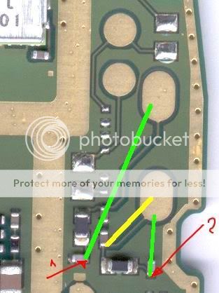

I INSP DDK Well-known Member Joined Sep 7, 2010 Posts 1,638 Likes 28 Mar 10, 2011 #29 1100 ringer track

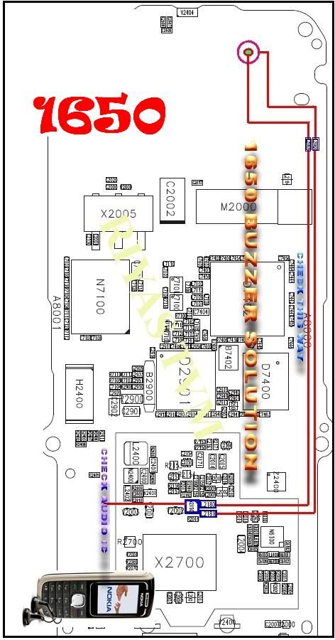

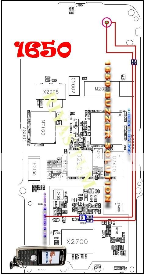

I INSP DDK Well-known Member Joined Sep 7, 2010 Posts 1,638 Likes 28 Mar 10, 2011 #30 1650 buzzer solution
