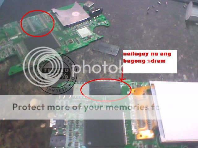

Action taken: Changed 64mb SDRAM (54 pins)

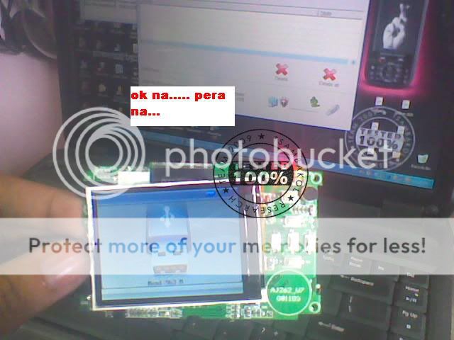

> Look for bootmode and long press bootmode then plug USB cable, "error USB not recognized"....

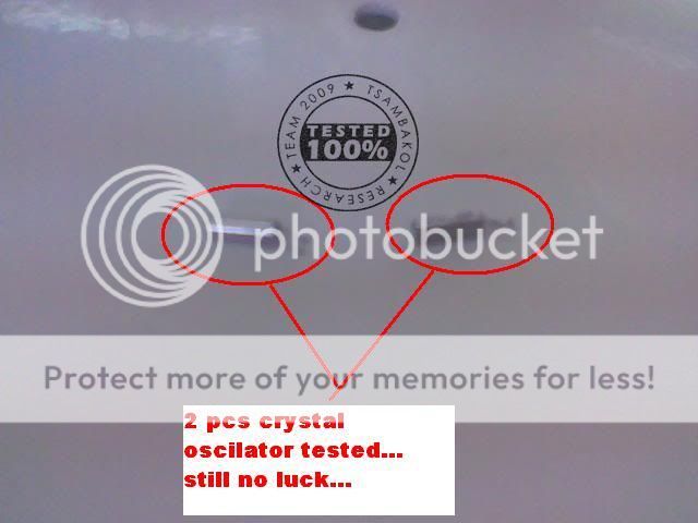

> First, change crystal oscilator twice, no luck, still the same problem...
> Last tricks, resolder 54 pins ng SDRAM... still the same...
> Take note: all mp5 repaired done by just resoldering of SDRAM, base on my experience...
> Final last trick, change SDRAM to be sure that there will be no back-job... and check & detected already to program...see the pics...

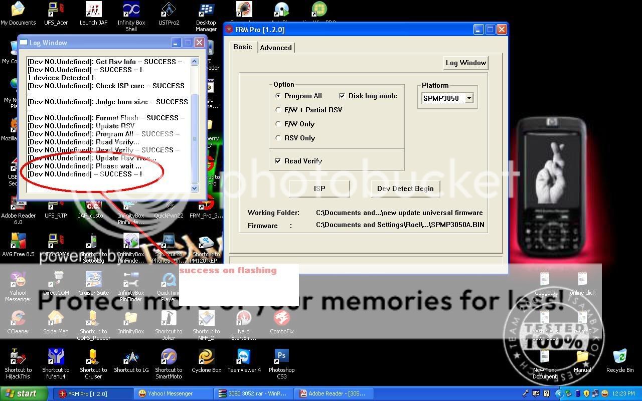

> So, I set LCD id & cam ID in the verifier and click save & exit
> Flash mp5 using FRM Pro

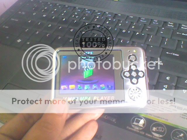

> Done all working...

SDRAM Replacement Pics
Click this bar to view the full image.

Crystal Oscilator

USB Not Recognized
Flashing
