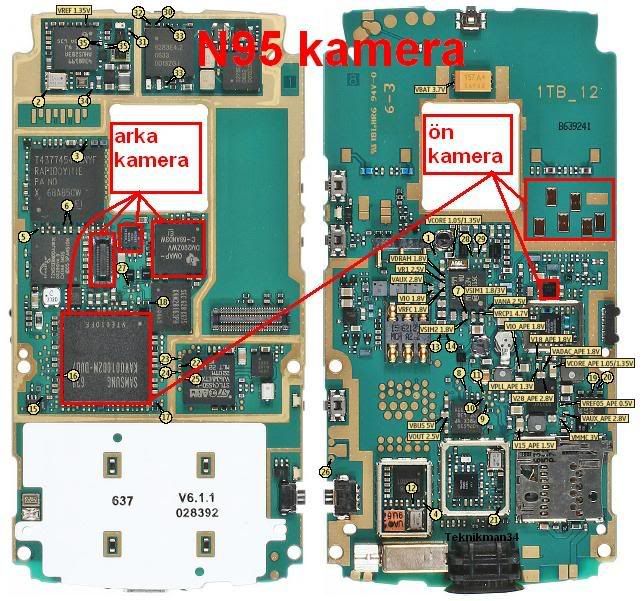

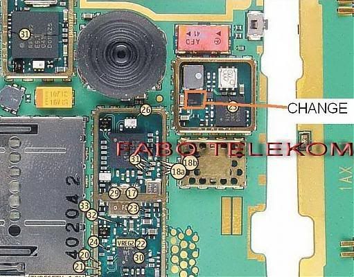

A atik_chowdhury Junior Member Joined Sep 11, 2010 Posts 97 Likes 0 Oct 1, 2010 #61 n95 camera solution if like this post USE ONLY THANKS BUTTON

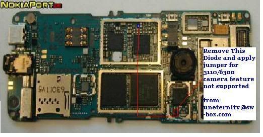

A atik_chowdhury Junior Member Joined Sep 11, 2010 Posts 97 Likes 0 Oct 1, 2010 #62 6300 camera solution if like this post USE ONLY THANKS BUTTON

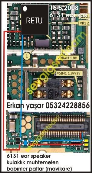

A atik_chowdhury Junior Member Joined Sep 11, 2010 Posts 97 Likes 0 Oct 1, 2010 #64 6131 ear speaker solution if like this post USE ONLY THANKS BUTTON

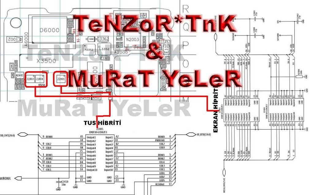

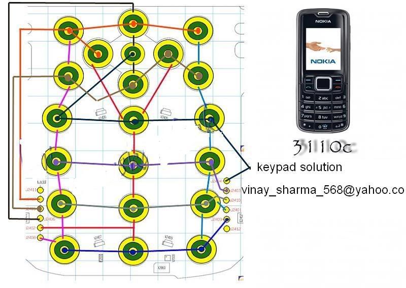

A atik_chowdhury Junior Member Joined Sep 11, 2010 Posts 97 Likes 0 Oct 1, 2010 #71 3110 keypad solution if like this post USE ONLY THANKS BUTTON

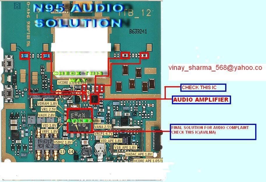

A atik_chowdhury Junior Member Joined Sep 11, 2010 Posts 97 Likes 0 Oct 1, 2010 #72 N95 Audio Way if like this post USE ONLY THANKS BUTTON
