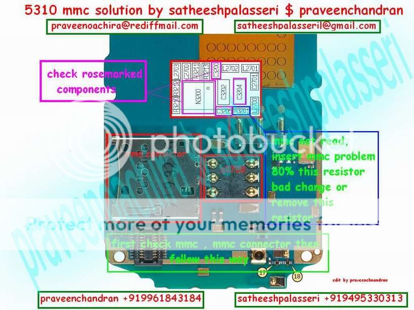

Lawra Well-known Member Staff member Joined Jul 16, 2011 Posts 1,353 Likes 7 Sep 21, 2011 #4 5310 solution

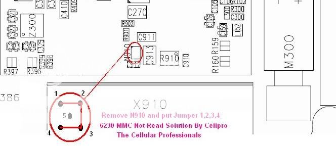

Lawra Well-known Member Staff member Joined Jul 16, 2011 Posts 1,353 Likes 7 Sep 21, 2011 #6 Another 6230 6230i solutions MMC Not Detected

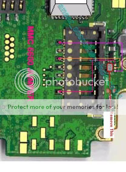

Lawra Well-known Member Staff member Joined Jul 16, 2011 Posts 1,353 Likes 7 Sep 21, 2011 #11 6600 MMC Solution

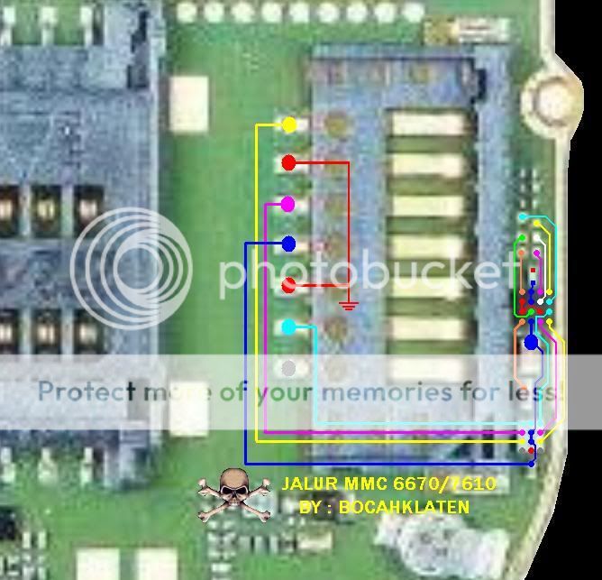

Lawra Well-known Member Staff member Joined Jul 16, 2011 Posts 1,353 Likes 7 Sep 21, 2011 #12 7610 MMC Voltages Jumper
Lawra Well-known Member Staff member Joined Jul 16, 2011 Posts 1,353 Likes 7 Sep 21, 2011 #13 7610 MMC Ways
