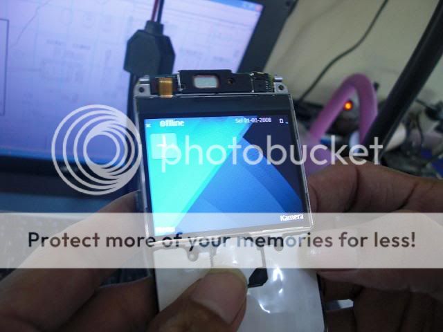

Solution Nokia E71 1st boot Error

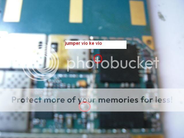

vio = 1.05v --------------> check the voltage less
check vCore = 1.39v-------------> ok
vana = 2.52v-check ok ------------->ok
check sleep_clk = 32.768khz-----> ok
check sleep_x = 1.81v-ok ---------->ok
check rf_clk = 38.4mhz-ok --------->ok
check purx = 1.8v---------------> ok
Jumper Vio To Vio.....
