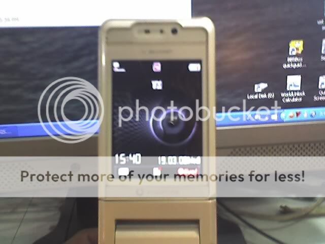

Model: Sharp 903sh
Problem: Please wait... then shut off
Action taken: flash with different flash files like; euro, jap, tw files but no good until the phone won't power on. And i'm looking for solution and i found this flash files which given by Boss Vino.
903sh FLASHFILES Credit goes to Boss Vino
Thanks for the flash file boss....
Note: You can use this files in SETool and USB-Smart
Here is the Logs in flashing

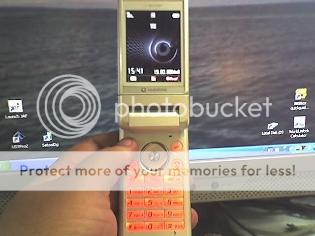

After flashing, do booting initialization by pressing #+power button, wait until it finished...
You have now the working phone....
screen shot

Elapsed: 1270 secs.
screen shot
