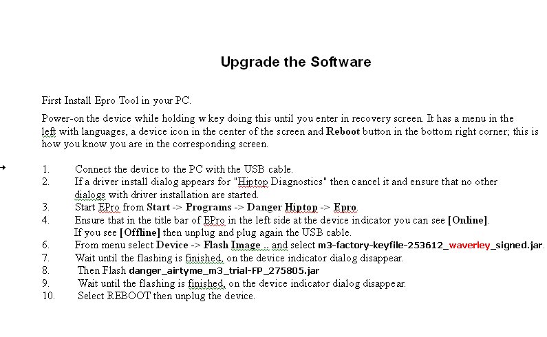

Upgrade the Software
First Install Epro Tool in your PC.
Power-on the device while holding w key doing this until you enter in recovery screen. It has a menu in the
left with languages, a device icon in the center of the screen and Reboot button in the bottom right corner; this is how you know you are in the corresponding screen.
1. Connect the device to the PC with the USB cable.
2. If a driver install dialog appears for "Hiptop Diagnostics" then cancel it and ensure that no other
dialogs with driver installation are started.
3. Start EPro from Start -> Programs -> Danger Hiptop -> Epro.
4. Ensure that in the title bar of EPro in the left side at the device indicator you can see [Online].
If you see [Offline] then unplug and plug again the USB cable.
6. From menu select Device -> Flash Image .. and select m3-factory-keyfile-253612_waverley_signed.jar.
7. Wait until the flashing is finished, on the device indicator dialog disappear.
8. Then Flash danger_airtyme_m3_trial-FP_275805.jar
9. Wait until the flashing is finished, on the device indicator dialog disappear.
10. Select REBOOT then unplug the device.
