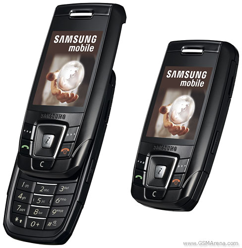

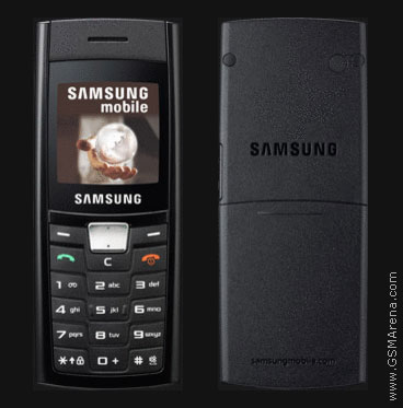

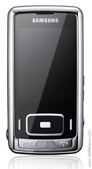

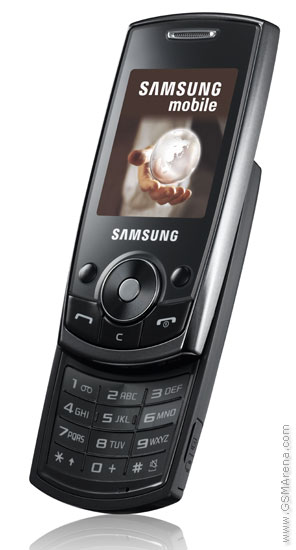

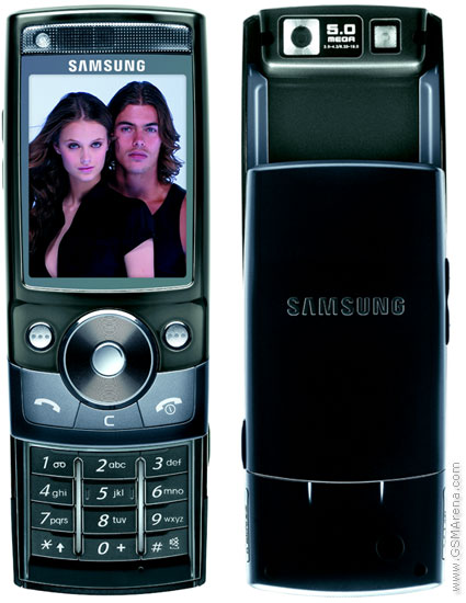

Just tested with new one J700 T429 F250 g600 and e250 e390 j700 c180 E250V from PL PLUS 100% WORKING !!
1-Turn on the phone without sim card .
2-Pull off the battery cover and insert any non-accepted sim card (without turning off the handset)
3-Do full reset *2767*3855# , phone will reboot and goes to Menu .
4-Customize Sp-lock code *7465625*638*00000000*00000000#
5-Unlock your phone with new SP code #7465625*638*00000000#
6-Enjoy G600 unlocked
Tested with few pieces
u can unlock
also with just simple typing code
#*7337#
no need other difficult procedure

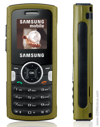

the same way have been tested on 2 SGH-M110 and the imei stayed the same.
My friend sayed that hi used the same code on a G800 and the imei stayed the same on that one to.
If you have more the one lock on the phone like it was on the M110 phones
then check what lock is active with *#7465625# and use this codes
*7465625*638*Code# = Enables Network lock
#7465625*638*Code# = Disables Network lock
*7465625*782*Code# = Enables Subset lock
#7465625*782*Code# = Disables Subset lock
*7465625*77*Code# = Enables SP lock
#7465625*77*Code# = Disables SP lock
*7465625*27*Code# = Enables CP lock
#7465625*27*Code# = Disables CP lock
*7465625*746*Code# = Enables SIM lock
#7465625*746*Code# = Disables SIM lock
you should have disabled your SP lock before you disabled your Network Lock. to fix this, in your case, do the following (no "*2767*3855# - Full e2p reset" required because you have already done one):
1. *7465625*638*00000000*00000000# - Relock Network lock & reset to 8 zeroes
2. *7465625*77*00000000*00000000# - Relock SP lock & reset to 8 zeroes
3. #7465625*77*00000000# - Disable your SP lock
4. #7465625*638*00000000# - Disable Network lock
5. phone should be ok and unlocked

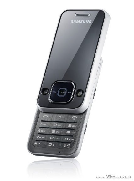

E2120
Unlock - ok
*2767*3855#
not done
+ input code
tested by me...
