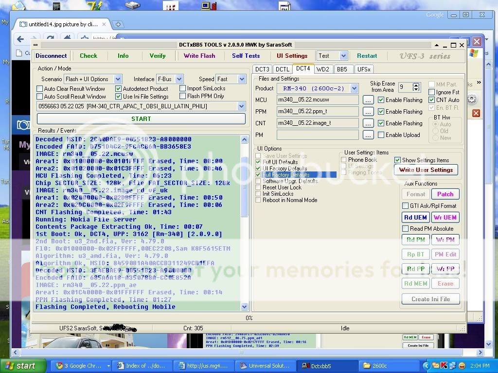

here in successfully flashing sl3 5310 by hwk via downgrade
Code:
1ST BOOT  : C0,07 [Rm-303] [2.0.9.0]
RAPx ID   : 000000010000022600010006010C192101013000
EM 1 ID   : 00000295
EM 2 ID   : 00000B22
RAPx PBID : 1EF0010FC58102549FA7C357A865D1D67D37FA1C
RAPx MODE : 00
RAPx HASH : BAF3A9C3DBFA8454937DB77F2B8852B1
RAPx ROID : 273F6D55DFAAF68F
CMT 1ST Boot OK
CMT FLID0 : 0001003F-00008A21, Amd 72NS512PD
CMT MCID0 : FFFF0000-00000000
CMT 2ND Boot OK
CMT ALGO  : RAP3Gv3_algo.fg, Ver: 9.17.0
CMT KSIG0 : 3E96DE4212587183E5E16BB2C79692A53C19875D
CMT VPP   : Internal
DUAL LINE : True
CMT ALG Boot OK
IMAGE : rm303__08.32.mcusw
CMT NOR Erase Area: 0x00140000-010DFFFF
CMT NOR Erase Area: 0x010E0000-0121FFFF
CMT FLASH ERASE OK, Time: 01:12
Written: 8 Certificate(s)
CMT FLASH WRITE OK, Time: 01:47
Chip SECTOR_SIZE: 128k
IMAGE : rm303__08.32.image_e_whitemica_silver
CMT NOR Erase Area: 0x018A0000-01B1FFFF
CMT NOR Erase Area: 0x01B20000-03FBFFFF
CNT FLASH ERASE OK, Time: 03:41
CNT FLASH WRITE OK, Time: 00:56
IMAGE : rm303__08.32.ppm_e
CMT NOR Erase Area: 0x01220000-0189FFFF
PPM FLASH ERASE OK, Time: 00:24
PPM FLASH WRITE OK, Time: 00:33
MCU SW  : V 08.32 23-07-08 RM-303 (c) Nokia
PPM SW  : V 08.32 23-07-08 RM-303 (c) Nokia E
Prd.Code: 0556858
Bpr.Code: 0544850
Prod.Sn : DUB376160
HW Vers : 1005
EM VILMA: 15
EM BETTY: 22
RFIC Ver: 064c0609
DSP Vers: ICPR71_08w22
LCD Type: SEIKO
IMEI    : 352072-**********
SL Serv : SIMLOCK SERVER
SL Conf : 244-07-00000000000
SL Prof : 0000000000000000
SL Count: 00 00
Provider: Nokia Test;Finland
UI Defaults Ok, Time: 00:10
Set Full Factory Defaults Ok, Time: 00:01
/CODE]
