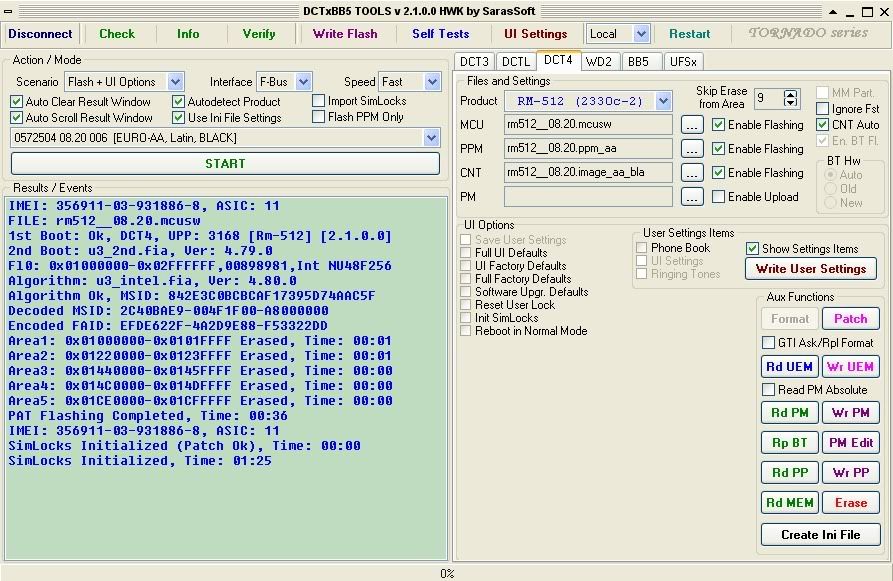

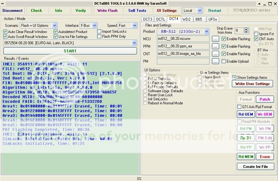

firt of all i would like to greet saras team, thank you for this great update
keep it up team!
same as usual unlocking patch procedure.
1. check version of phone example 8.20
2. just download same version of phone to support and then install
3. clicked check
4. clicked info for sure that this is properly connected
5. ticked unlock it is auto detect for patch unlock.
here is check log
1st Boot: Ok, DCT4, UPP: 3168 [] [2.1.0.0]
Fl0: 0x01000000-0x02FFFFFF,00898981,Int NU48F256
Rebooting Mobile
info log
MCU SW : V 08.20 30-06-09 RM-512 (c) Nokia
PPM SW : V 08.20 30-06-09 RM-512 (c) Nokia AE
Product : Nokia 2330c-2
Prd.Code: 0586120
Bpr.Code: 0569925
Prod.Sn : DSF242666
HW Vers : 1000
UEM : 4386
UPP : 12648 [3168]
RFIC Ver: 0500
DSP Vers: ICPR72_09w24_U
LCD Type: SUEZ
CAM Prim: GR0103D101260C213402_001007
PPM SW : V 08.20 30-06-09 RM-512 (c) Nokia AOR 2330c unlock done
Prd.Code: 0586777
Bpr.Code: 0569925
Prod.Sn : DUG236556
HW Vers : 1000
UEM : 4386
UPP : 12648 [3168]
RFIC Ver: 0500
LCD Type: SUEZ
IMEI : 357983-03-850589-3
SL Conf : 234-33-00000000000
SL Prof : 800000000003000-B
SL Var : 00553579830385058900
SL Aux : 000B5555
HW Sig : BD22B9B75B91AEBD
Box Id : FFFFFFFFFFFFFFFF
BLK1= L1: CLOS
BLK2= L1: CLOS
Provider: Orange;United Kingdom
IMEI: 357983-03-850589-3, ASIC: 11
FILE: rm512__08.20.mcusw
1st Boot: Ok, DCT4, UPP: 3168 [Rm-512] [2.1.0.0]
Algorithm Ok, MSID: 84E19406129FC5BC6A0BB0CD48
Decoded MSID: 2C40BAE9-004E97DC-A8000000
Encoded FAID: 1CB517F3-F03DF123-FBBB103E
Erasing: 0x01000000-0x0101FFFF ...
Erasing: 0x01220000-0x0123FFFF ...
Area2: 0x01220000-0x0123FFFF Erased, Time: 00:00
Erasing: 0x01440000-0x0145FFFF ...
Area3: 0x01440000-0x0145FFFF Erased, Time: 00:00
Erasing: 0x014C0000-0x014DFFFF ...
Area4: 0x014C0000-0x014DFFFF Erased, Time: 00:00
Erasing: 0x01CE0000-0x01CFFFFF ...
Area5: 0x01CE0000-0x01CFFFFF Erased, Time: 00:00
PAT Flashing Completed, Time: 00:36
Writing SimLocks ...
SimLocks Initialized, Time: 01:01
