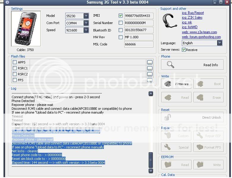

hi,
success unlock S5233s with simple procedure
unlock thru e210 combo cable ( rj45 and usb)
UNLOCKING NETWORK LOCK and RESET PHONE LOCK(00000000)
* with e210 rj45 connect cable to box port to phone without battery
*select model S5230
* click direct unlock button
*attach battery to the phone (phone will automatically power on and software detect phone/device
*wait a few second until phone restart then disconnect rj45 and after that connect data cable (usb e210) be sure drivers installed properly
>>>> Quote:
Disconnect RJ45 cable and connect data cable(APCBS10BBE or compatible) to phone
If see on phone "Upload data to PC" - reconnect phone manually
* wait and smile finished!
whehehehehehehe
