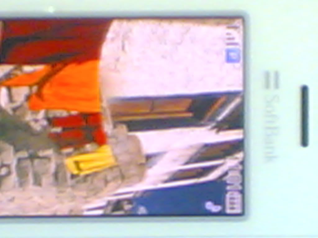

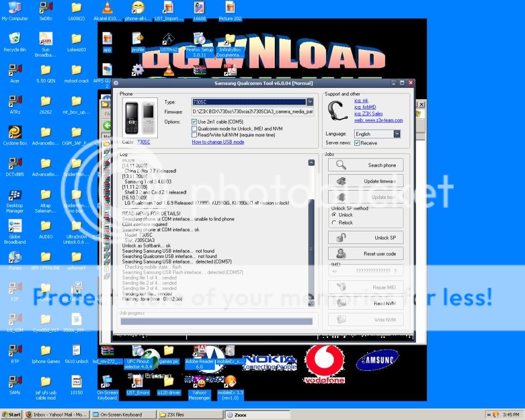

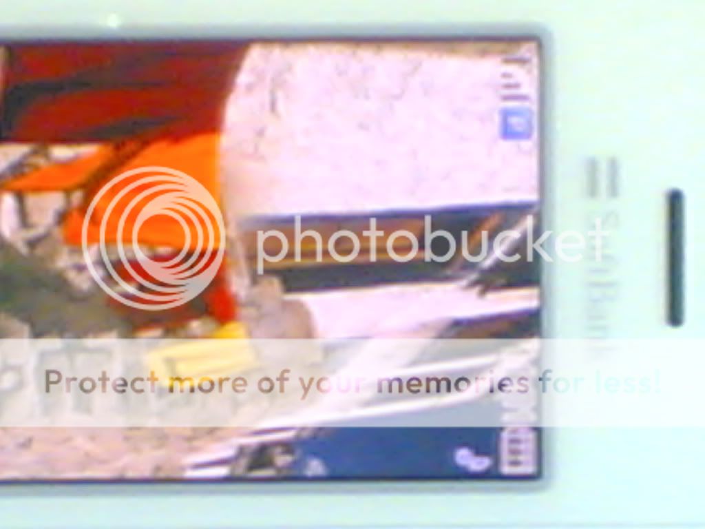

Searching Samsung USB interface... not found
Searching Qualcomm USB interface... not found
Searching phone at COM interface... ok
Model: 821SC
SW: 821SCID3
Reading file as 821SC... ok
Model: 821SC
Version: 821SCID3
Info: Camera, media and network patch
Searching Samsung USB interface... detected (COM9)
Checking mobile state... normal
Model: 821SC
SW: 821SCID3
IMEI: 359198013878003
Searching Samsung USB Flash interface... detected (COM14)
Sending file 1 of 4... sended
Sending file 2 of 4... sended
Sending file 3 of 4... sended
Sending last file... sended
Flashing done (time - 00:05:32)

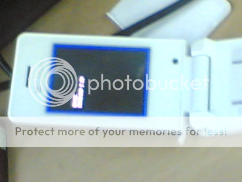

READ NEWS FOR DETAILS!
Checking ports... ok
Searching Samsung USB interface... detected (COM6)
Model: SGH-T929
SW: T929UVIA2
IMEI: 355881020224105
Model: T929
SW: T929UVIA2
Unlock as MSL2 Direct... OK (time - 00:00:04)
Searching Samsung USB interface... detected (COM27)
Model: 730SC
SW: 730SCII1
IMEI: 355400021981074
Model: 730SC
SW: 730SCII1
Model: 730SC
SW: 730SCII1
Unlock as Softbank... ok
Reading file as 730SC... ok
Model: 730SC
Version: 730SCII1
Info: Camera and media patch v2
Searching Samsung USB Flash interface... detected (COM30)
Flashing done (time - 00:02:32)

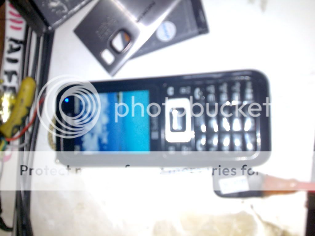

2 e1120 UNLOCKED
Last version on support: 2G tools v3.4.0009
Selected model: E1120
Selected com port: COM3
Selected speed port: 921600
Please, connect phone and press power button 3 seconds
Phone Detected
Use automatic parameters
Phone in TAT MODE
Phone IMEI: 35601303322988
Phone SW: E1120BVID1
Phone BT ADDR: 0000-00-000000
Phone SN: RT7S838036
Deactivated MSL - TRUE
Unlock - ok
Elapsed time: 16 second, sw ver: 3.4.0004
Phone Detected
Phone in TAT MODE
Phone IMEI: 35601303323075
Phone SN: RT7S838184
Unlock - ok
Elapsed time: 7 second, sw ver: 3.4.0004
