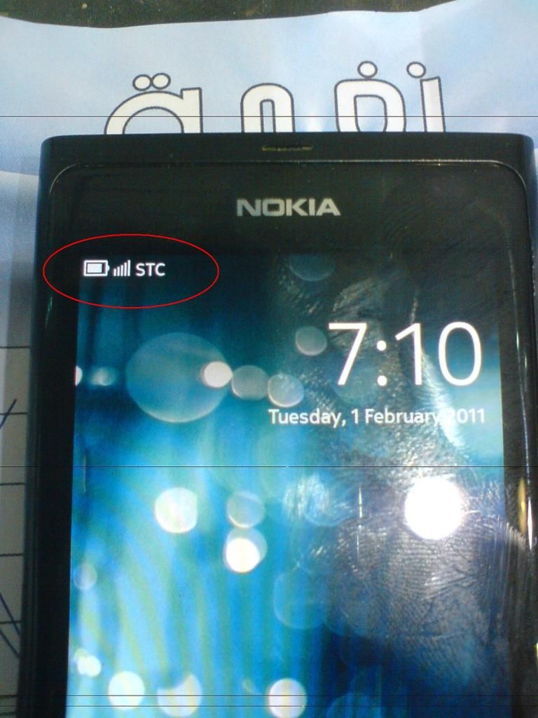

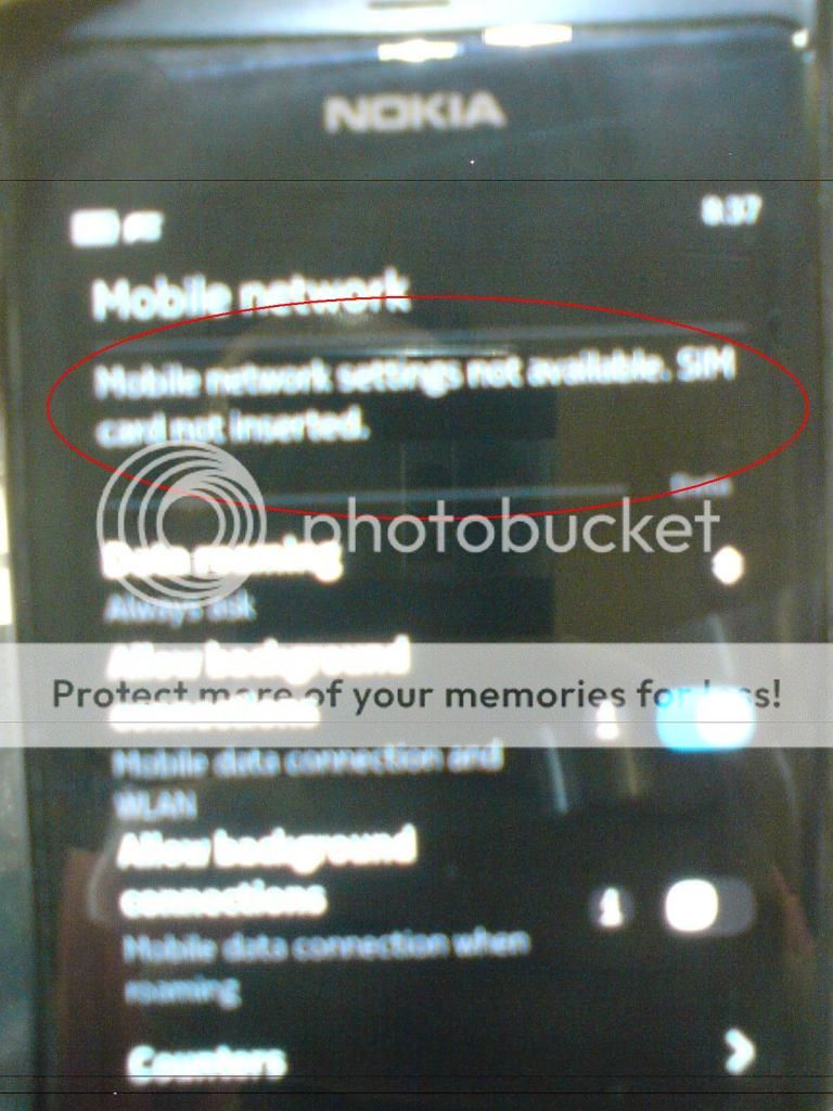

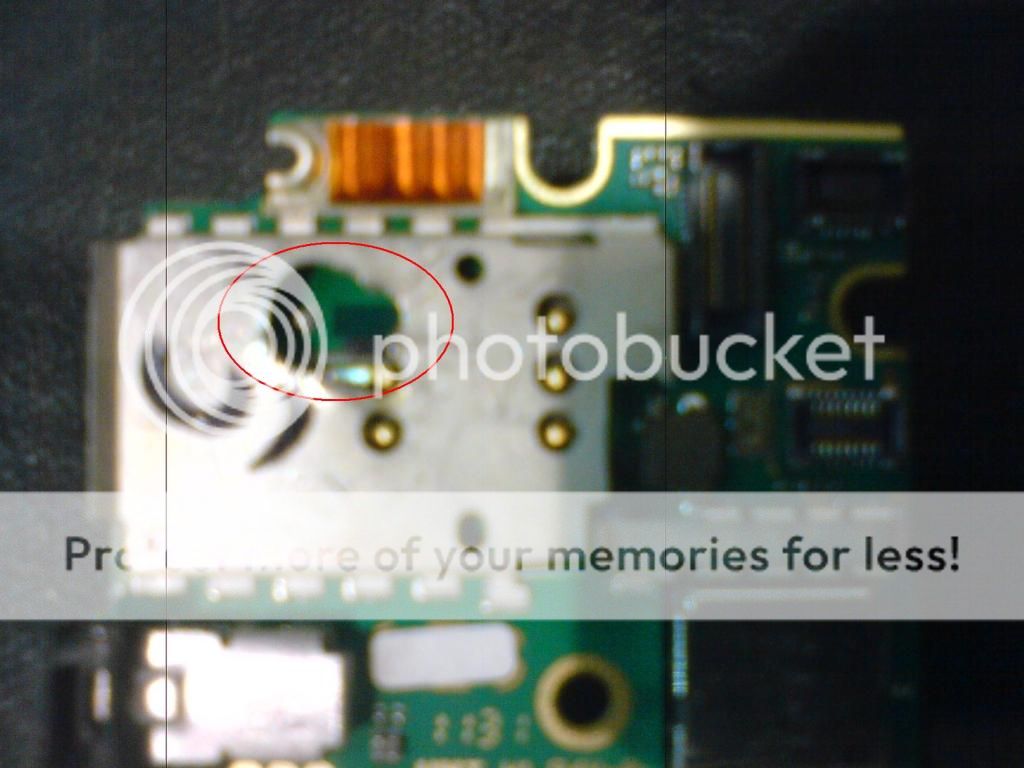

recieve this phone in insert sim status upon checking and this is what I noticed - see screenshot...
things done:
*tried change microsim same problem
*tried software same problem
things needed:
*small sidecutter
*nailcutter
*soldering
*any microsd card slot-mine i got on defective n95 - only pin needed
*disassembly guide -
Procedures - on screenshots....

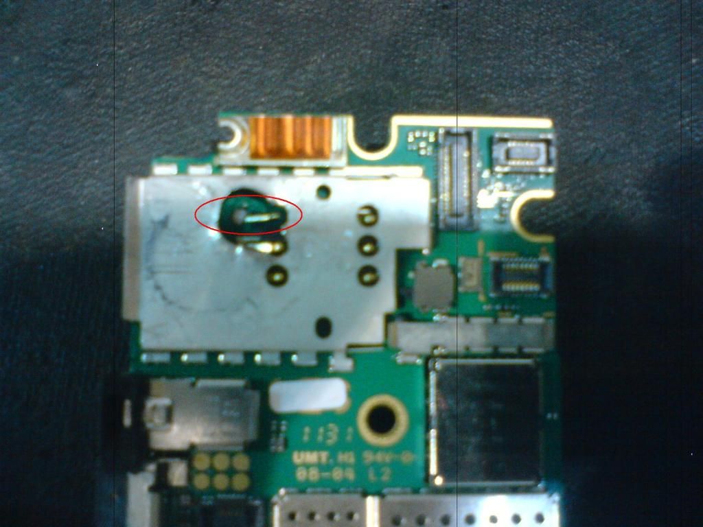

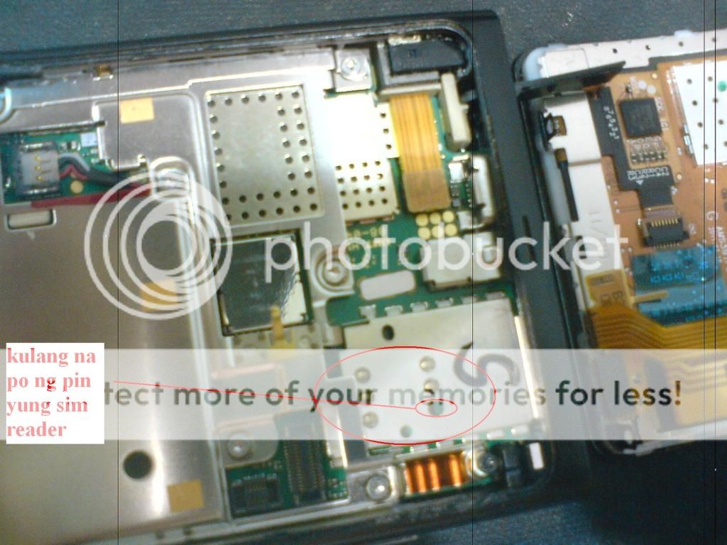

disassemble then ito po nakita ko, kulang na po yung pin ng simreader....
Now, instead na palitan ko na lang ng new sim reader try ko na lang repair kasi wala rin kami stock na buong piyesa...
assemble and check
Job done....

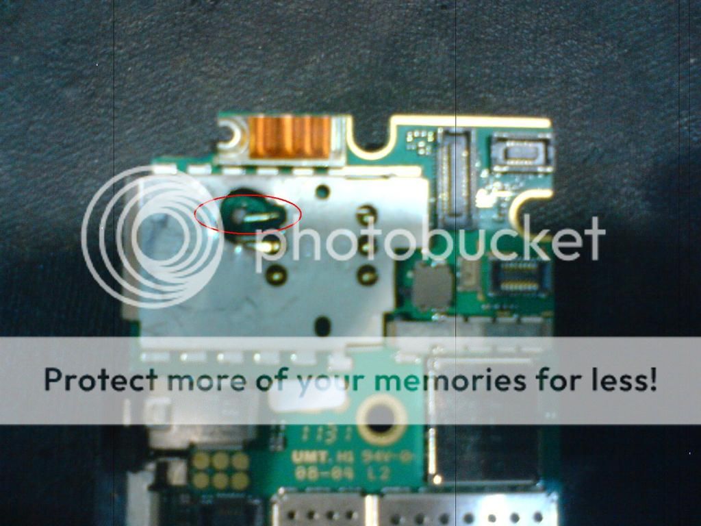

things done:
things needed:
*small sidecutter
*nailcutter
*soldering
assemble and check
Job done....
