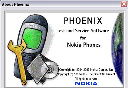

answer: NOKIA BB5 USB FLASH with Phoenix Software
How to Flash Nokia Phones Using Phoenix Service Software

[FONT=*quot]- Open Phoenix Service Software[/FONT][FONT=*quot] by double click on the icon from your desktop.[/FONT]
[FONT=*quot]- Connect your phone in PC Suite Mode.[/FONT]
[FONT=*quot]- In Phoenix, click File *gt; Manage Connections.[/FONT]
[FONT=*quot]- Now click New.[/FONT]
[FONT=*quot]- Now select the type of cable you are using. If you are using DKE-2, CA-53 [N-Series] cable, select USB.[/FONT]
[FONT=*quot]- Click Next. It will find your product and say FOUND. If it doesn't find any, you can try changing your cable type by clicking Back.[/FONT]
[FONT=*quot]- Click Next and then Finish.[/FONT]
[FONT=*quot]- Now your cable type (USB) appears in the connection list. Select it. Click APPLY and then CLOSE.[/FONT]
[FONT=*quot]- Now select File *gt; Open Product.[/FONT]
[FONT=*quot]- A list of RM code will open. Select your phone's RM code. Like RM-133 for Nokia N73 or RM-84 for Nokia N70 and other nokia's with there corresponding Rm Types but choose the one which corresponds to your phone! Click OK. At this steps if you receive an error its okay. Just ignore it.[/FONT]
[FONT=*quot]- Now select File *gt; Scan Product.[/FONT]
[FONT=*quot]- Your phone's firmware info will appear at the extreme bottom of the Phoenix window.[/FONT]
[FONT=*quot]- Now go to Flashing *gt; Firmware Update.[/FONT]
[FONT=*quot]- A window will open.[/FONT]
[FONT=*quot]- On that window click Browse button (the one with three dots)[/FONT]
[FONT=*quot]- A window will open with various products and various regions. Choose the region or country of your choice according to the language pack you want to install.[/FONT]
[FONT=*quot]- Click OK.[/FONT]
[FONT=*quot]- Click Refurbish.[/FONT]
[FONT=*quot]- Now your actual flashing has started.[/FONT]
