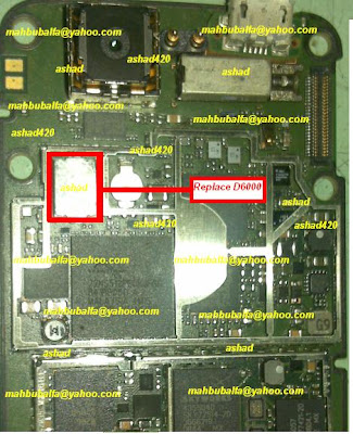

G gskhatni Product Supporter Joined Apr 15, 2011 Posts 959 Likes 11 Jun 18, 2011 #74 Nokia 5800 power on just variation tested solution Nokia 5800 5230 5233 5530 Just power on variation tested solution here Nokia 5800 power on just variation tested solution here. try this solution one by one. Step1:check bsi line.bsi line cut. apply this jumper. Step2.try flash same product code. step3.remove this N2121. Step1:check bsi line.bsi line cut. apply this jumper.
G gskhatni Product Supporter Joined Apr 15, 2011 Posts 959 Likes 11 Jun 18, 2011 #75 Nokia 5530 power on just variation tested solution try this solution one by one Step1:check bsi line.bsi line cut. apply this jumper. Step2.try flash same product code. step3.remove this N2121.
