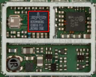

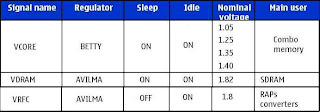

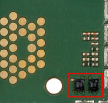

3) check vcore,vio,vdram vrfc volt
this 4 volt controlled by combo ic
vdram,vrfc,vio volt controlled by AVILMA
Vcore controlled by BETTY
this 4 volt is prefect???then one thing is conformed avilma betty working fine
