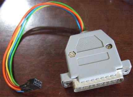

Step 1: You have to find a stem LPT port cable as shown:
Just like on the Jack LPT port to attach to the back of the computer.
And on what it has stated that Jack LPT number from 1 to 25 feet (see wealth in'll see). And we only care about 4 feet.
No. 6 feet ..........( called SCK)
No. 7 foot ..............( called Mosi)
No. 9 feet ..............( called reset)
foot No. 10 ............( called miso)
As shown below:
