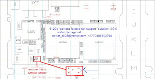

N NANAIU Well-known Member Joined Oct 15, 2010 Posts 2,734 Likes 63 Location BD Oct 15, 2010 #151 6120c Camera feature not supported

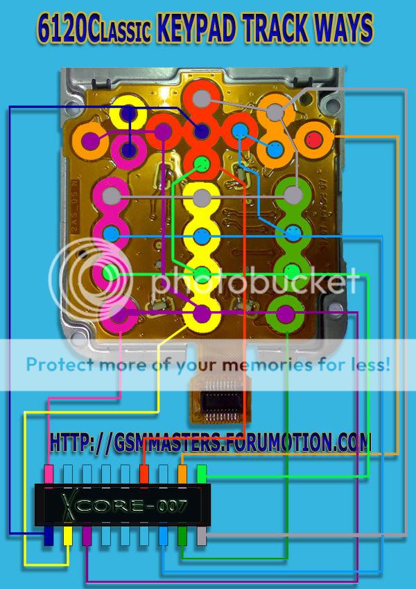

N NANAIU Well-known Member Joined Oct 15, 2010 Posts 2,734 Likes 63 Location BD Oct 15, 2010 #153 6120c keypad ways

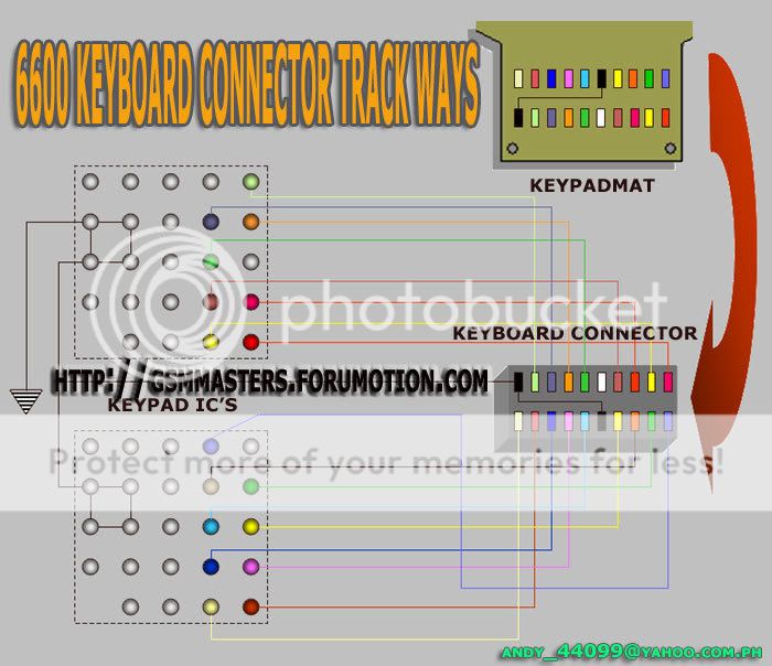

N NANAIU Well-known Member Joined Oct 15, 2010 Posts 2,734 Likes 63 Location BD Oct 15, 2010 #154 6600 keypad connector

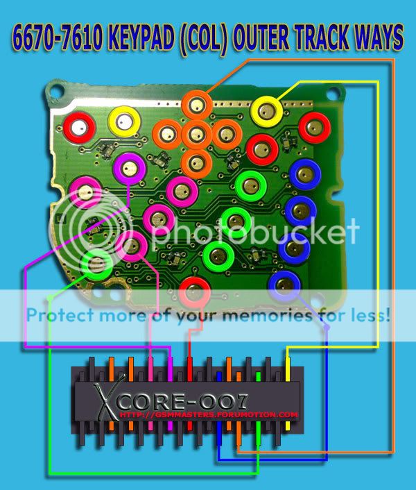

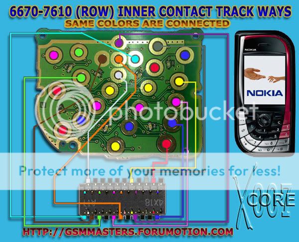

N NANAIU Well-known Member Joined Oct 15, 2010 Posts 2,734 Likes 63 Location BD Oct 15, 2010 #155 6670 - 7610 keypad ways

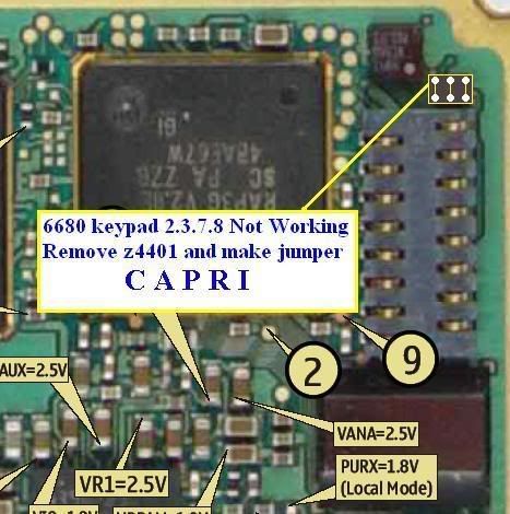

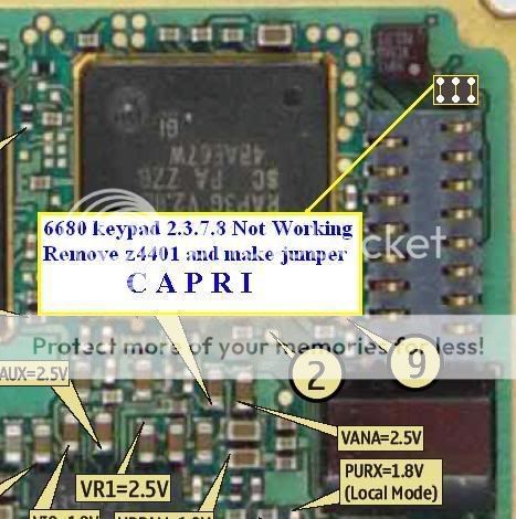

N NANAIU Well-known Member Joined Oct 15, 2010 Posts 2,734 Likes 63 Location BD Oct 15, 2010 #156 6680 keypad ways

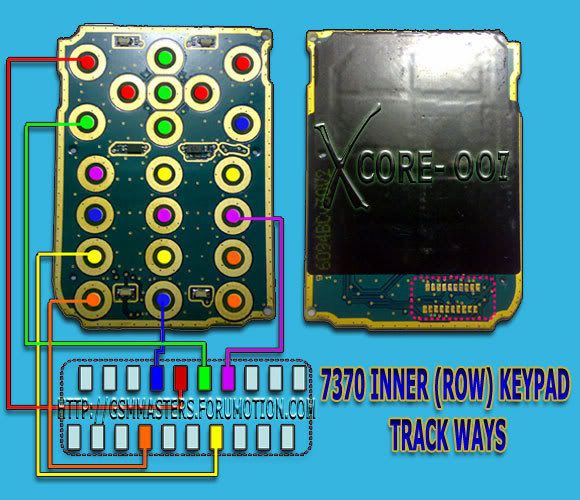

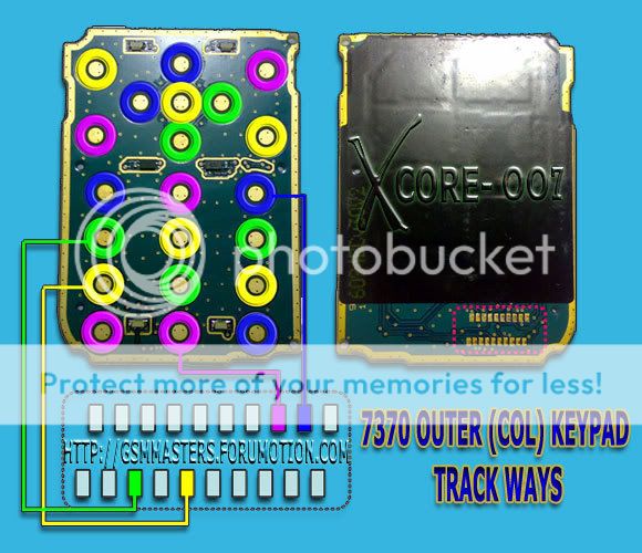

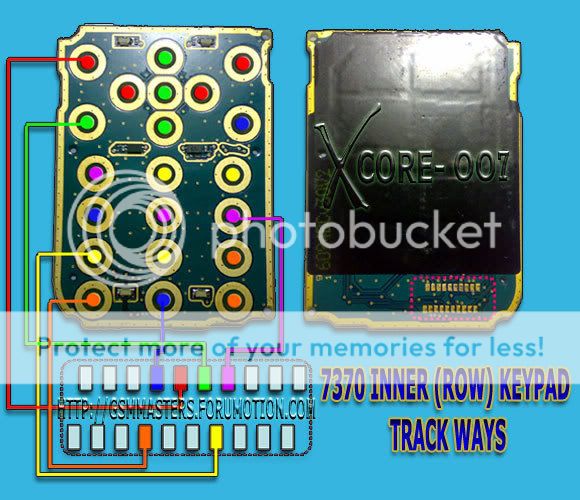

N NANAIU Well-known Member Joined Oct 15, 2010 Posts 2,734 Likes 63 Location BD Oct 15, 2010 #157 7370 keypad ways
