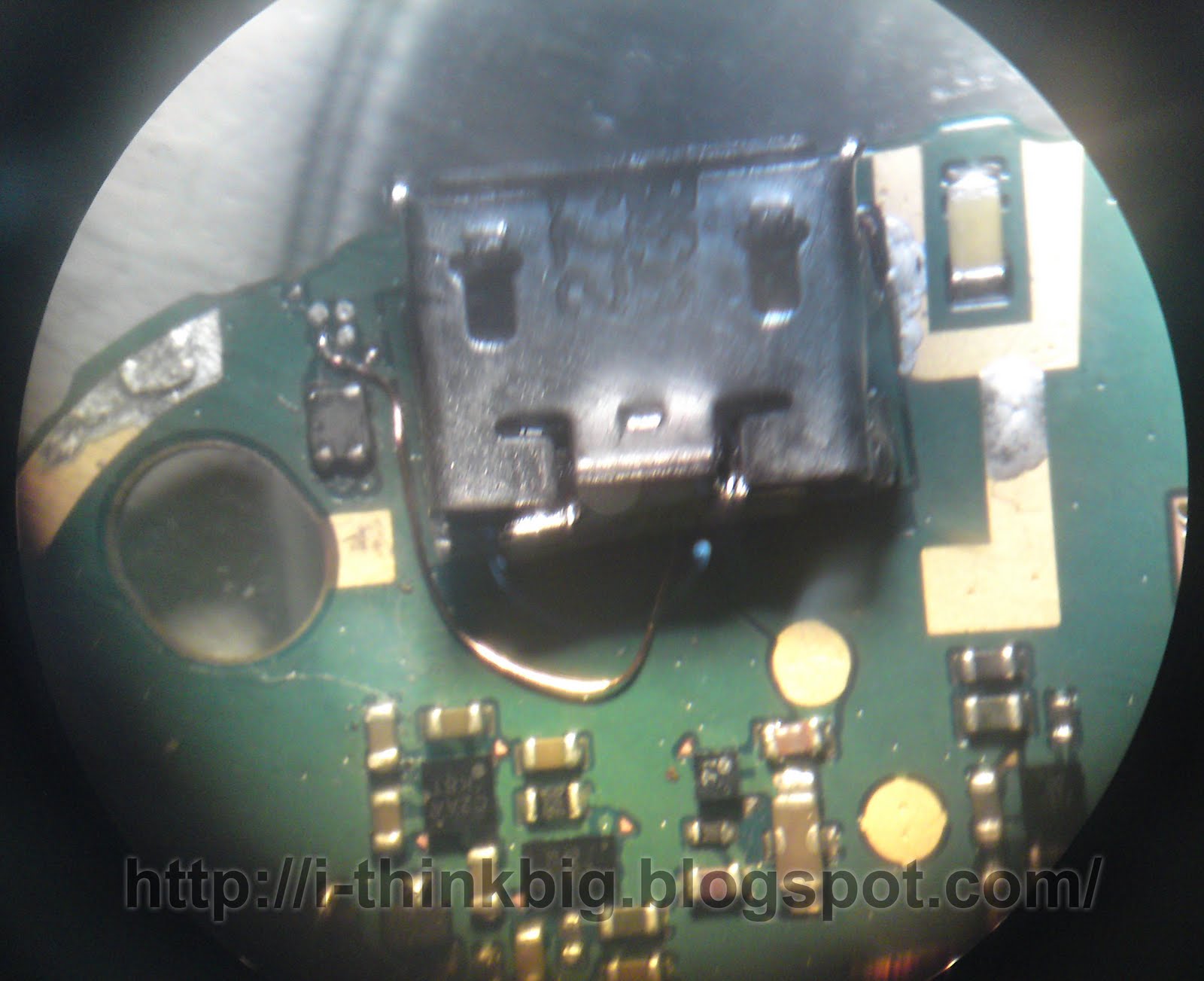

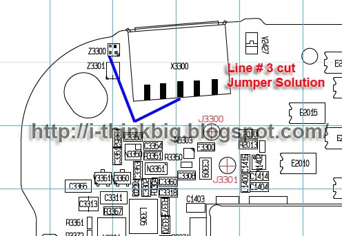

Remove the parts Z3300 then jump to pin # 3 as shown in the picture
M .::MEGATRON::. Member Joined Oct 20, 2010 Posts 175 Likes 0 Oct 26, 2010 #1 Remove the parts Z3300 then jump to pin # 3 as shown in the picture

F faysal1981 Member Joined Dec 19, 2011 Posts 132 Likes 2 Jan 8, 2012 #4 answer: N86 CHARGING problem ( jumper solution ) still same problem................. not charging.............. plz hlp

F faysal1981 Member Joined Dec 19, 2011 Posts 132 Likes 2 Jan 8, 2012 #6 answer: N86 CHARGING problem ( jumper solution ) i did it, but same problem

F faysal1981 Member Joined Dec 19, 2011 Posts 132 Likes 2 Jan 8, 2012 #8 answer: N86 CHARGING problem ( jumper solution ) Gsmideazone said: try Click to expand... sdsffsf still same problem

F faysal1981 Member Joined Dec 19, 2011 Posts 132 Likes 2 Jan 8, 2012 #9 answer: N86 CHARGING problem ( jumper solution ) ok im trying with this
N nadim Newbie Joined Mar 12, 2012 Posts 1 Likes 0 Mar 12, 2012 #10 answer: N86 CHARGING problem ( jumper solution ) hi all where is the Pic ???????? jot veran
