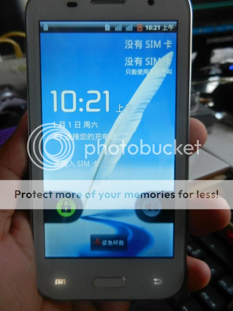

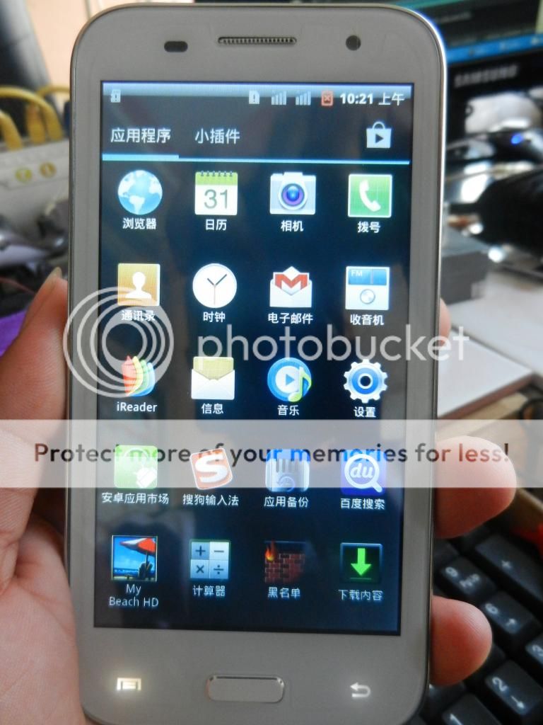

N7100 (cpu type sc6820) android format success

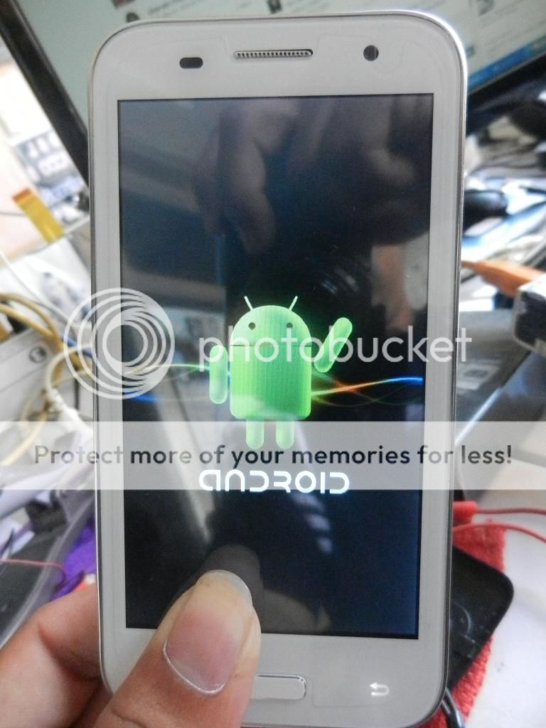

PROBLEM HANG LOGO & RESTART

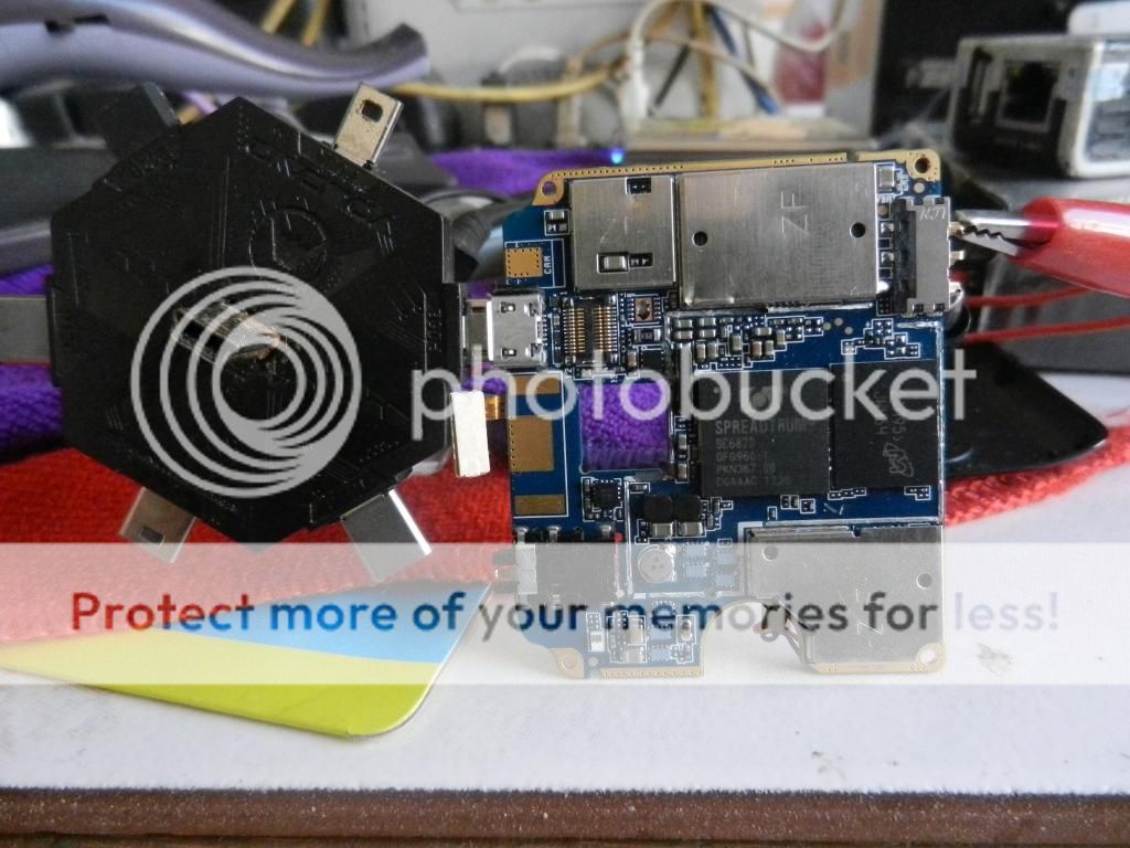

Connecting...
Connection successful,connected state!
Version: V3.8
SN:001-649-534
Port:COM10
After format or Flash you have to press & hold power button for at least 1.30 mins.
Available Ports:COM1 COM10 COM25 COM81 COM117
Detection initiated...
Vcc: null
Gnd: 5
Analyzing D+ and D-...
D+ = 3, D- = 2
Detection D+/D- with 3.50 seconds!
Analyzing USB device, please wait...
Found [SPD] USB device: SCI USB2Serial,(VID_1782&PID_4D00)
Setting...
Find USB device:SCI USB2Serial (COM21), (VID_1782&PID_4D00)
Pinouts setting complete!
Internal version: SPRD3
Boot downloaded.
Start boot please wait a moment....
Spreadtrum Boot Block version 1.1
Boot downloaded.
Set to Factory successfully.
C:\Program Files\Volcano Team\VolcanoBox\PrtScn\PIC_2013_02_12_14_49_26.jpg saved.
>>C:\Program Files\Volcano Team\VolcanoBox\PrtScn\PIC_2013_02_12_15_16_33.jpg saved.
DONE
