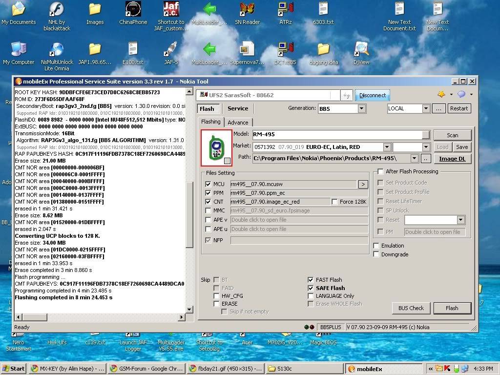

5130 sl3 nokia logo done in mx key Version from phone: 07.90
Version from file: 07.90
Library version: 1.0.0.7931(21-03-2010), 1.0.0.12676(21-03-2010)
RAP Data :
SYSTEM ASIC ID: 000000010000022600010006030C192101033000 [RAP3G ver: PA 3.x]
EM0 ID: 00000296
EM1 ID: 00000B22
PUBLIC ID: 298001149A397F562894746936FAF520617CCED0
ASIC MODE ID: 00
ROOT KEY HASH: 9DDBFCFE6E73CED7D8C6268C8EB85723
ROM ID: 273F6D55DFAAF68F
SecondaryBoot: rap3gv3_2nd.fg [BB5] version: 1.30.0 revision: 0.0 size: 0x3C00
Supported RAP Ids: 0103192101003000, 010C192101003000, 0103192101013000, 010C192101013000, 0103192101003100, 010C192101003100, 0303192101023000, 030C192101023000, 0303192101033000, 030C192101033000, 0103192101001101, 010C192101001101, 0003192101001002, 000C192101001002, 0013192101001002, 001C192101001002
FlashID0: 0089 8982 - 0000 0000 [Intel NU48F512,512 Mbits] type: NOR,RAP
ExtBUSC: 0000 0000 0000 0000 0000 0000 0000 0000
TransmissionMode: 16Bit
Algorithm: RAP3Gv3_algo_131.fg [BB5 ALGORITHM] version: 1.31.0 revision: 0.0 size: 0x297E0
Supported RAP Ids: 0103192101003000, 010C192101003000, 0103192101013000, 010C192101013000, 0103192101003100, 010C192101003100, 0303192101023000, 030C192101023000, 0303192101033000, 030C192101033000, 0003192101002000, 000C192101002000, 0003192101002100, 000C192101002100, 0003192101002200, 000C192101002200, 0003192101012200, 000C192101012200, 0103192101001101, 010C192101001101, 0003192101001002, 000C192101001002, 0013192101001002, 001C192101001002
RAP PAPUBKEYS HASH: 0C917F11196FDB7378C18EF7260698CA4489DCA0
Reading RAP NPC (0x168 bytes).
Reading RAP VARIANT (0x0 bytes).
Reading RAP CCC (0x160 bytes).
Reading RAP HWC (0xD4 bytes).
Flash Imei: 3552120****8
NPC_DATA saved OK
CCC_DATA saved OK
HWC_DATA saved OK
SIMLOCK_DATA saved OK
SIMLOCK_KEY_DATA saved OK
WMDRM_PD_DATA saved OK
RF_DATA saved OK
WARRANTY_DATA saved OK
PROD_DATA saved OK
BT_DATA saved OK
LOCK_DATA saved OK
LOCK120_DATA saved OK
BB_DATA saved OK
RPL saved to "C:\mobileEx\3.3\data\backup\BB5_355212038**** *_BA CK.rpl"
RAP Data :
EM0 ID: 00000296
EM1 ID: 00000B22
ASIC MODE ID: 00
Erase size: 21.00 MB
CMT NOR area [00000000-000006BF]
CMT NOR area [000006C0-0001FFFF]
CMT NOR area [00040000-000BFFFF]
CMT NOR area [000C0000-0013FFFF]
CMT NOR area [00140000-0137FFFF]
CMT NOR area [01380000-0151FFFF]
erased in 1 min 31.421 s
Erase size: 8.62 MB
CMT NOR area [01520000-01DBFFFF]
erased in 2.047 s
Converting UCP blocks to 128 K.
Erase size: 34.00 MB
CMT NOR area [01DC0000-0215FFFF]
CMT NOR area [02160000-03FBFFFF]
erased in 1 min 33.953 s
Erase completed in 3 min 8.860 s
Flash programming ...
CMT PAPUBKEYS: 0C917F11196FDB7378C18EF7260698CA4489DCA0 (RAP Certificate 164 v.1) written.
Programming completed in 4 min 23.485 s
Flashing completed in 8 min 24.453 s
Phone Type: RM-495 (Nokia 5130c-2)
SW Version: V 07.90 23-09-09 RM-495 (c) Nokia
Imei plain: 355212*********
Product Code: 0579013
Language Pack:
- not available.
This phone have PM308 protected, SD security in not restorable.
This is SL3 phone(Simlock2 format).
- Avoid SW Downgrade & manual erase to this phone !
Imei net: 35521203*********
Version: SIMLOCK SERVER
Provider: Nokia Test, Country: Finland
Counter: 0/3, 0/10
CONFIG_DATA: 2440700000000000
BLOCK 1: 1=OPEN 2=OPEN 3=OPEN 4=OPEN 5=OPEN, DATA=FFFFFF
BLOCK 2: 1=OPEN 2=OPEN 3=OPEN 4=OPEN 5=OPEN, DATA=FFFFFF
BLOCK 3: 1=OPEN 2=OPEN 3=OPEN 4=OPEN 5=OPEN, DATA=FFFFFF
BLOCK 4: 1=OPEN 2=OPEN 3=OPEN 4=OPEN 5=OPEN, DATA=FFFFFF
BLOCK 5: 1=OPEN 2=OPEN 3=OPEN 4=OPEN 5=OPEN, DATA=FFFFFF
BLOCK 6: 1=OPEN 2=OPEN 3=OPEN 4=OPEN 5=OPEN, DATA=FFFFFF
BLOCK 7: 1=OPEN 2=OPEN 3=OPEN 4=OPEN 5=OPEN, DATA=FFFFFF
Total time to process is 8 min 53.062 s

APE PAPUBKEYS HASH: 25129A39D9A3B031CA0124E1E90F5A17ED3EFC89
Original Imei: 35699601004491
Original Product code: 0551192
Bluetooth ID: 001CD43F01B7
WLAN ID: 001CD44E43EB
Phone Type: RM-159 (Nokia N95)
SW Version: V 06wk41v23.4 17-04-07 RM-159 (c) Nokia
Imei plain: 35699601004491-4
Product Code: 0551192
Language Pack:
- not available.
SIMLOCK seems to be valid
SUPERDONGLE_KEY seems to be valid
CMLA_KEY seems to be valid
WMDRM_PD seems to be valid
SIMLOCK_TEST passed
SECURITY_TEST passed
Imei net: 356996010044914
Provider: Orange, Country: United Kingdom
Counter: 1/3, 0/10
CONFIG_DATA: 2343300000000000
BLOCK 1: 1=OPEN, DATA=23433F
BLOCK 2: 1=OPEN, DATA=23486F
BLOCK 3: 1=OPEN, DATA=23433F
BLOCK 4: 1=OPEN, DATA=23486
