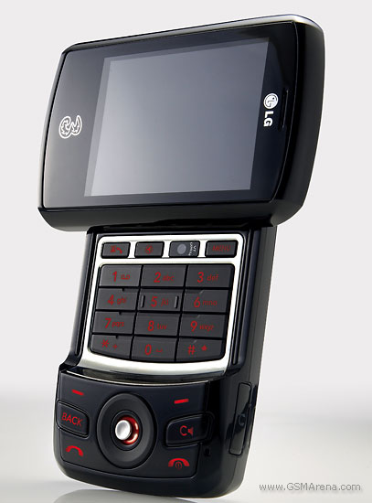

U890 UNLOCK WITH 64K SIM
HI
free gift for furious gold owners
download flash file from support and flash phone.NO DIODE NEEDED.
after flashing phone using usb data cable and QFG module you need to power on phone with original USIM card 128k
plug in the usb data cable, remember that phone must be conected to usb data cable and to PC.
after that you will go in phone menu in UNIT CONVERTER , after that phone will restart,
in this moment you will need to take out battery from phone, remove USIM card and insert new sim card 64k or 128k
and put battery back on phone.
remember that you must be fast..so quickly change sim's
AFTER FLASHING PHONE REMEMBER TO WRITE NV FILE!
that is all enjoy unlocking with furious gold.
thx to HACK3R2K for patch file and thx idaadi for doing video tutorial.
i attached here link to video tutorial with how to change sim cards fast.
here is link for tutorial:
http://rapidshare.com/files/34474193/MOV04285.rar
