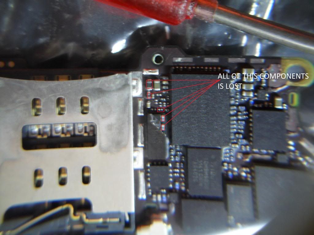

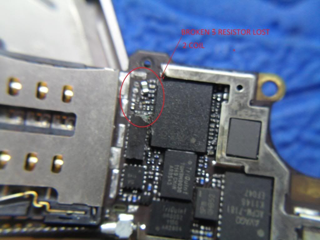

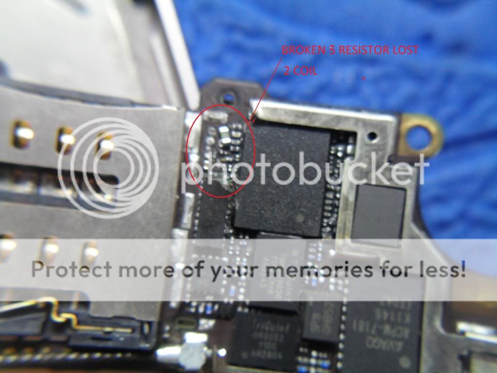

open again the phone and check all hide parts near to the signal components and i discover this.

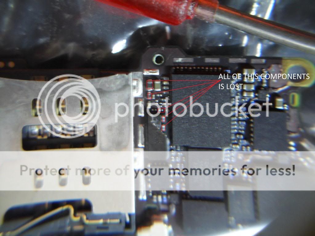

imediatly get another board and look the missing parts.

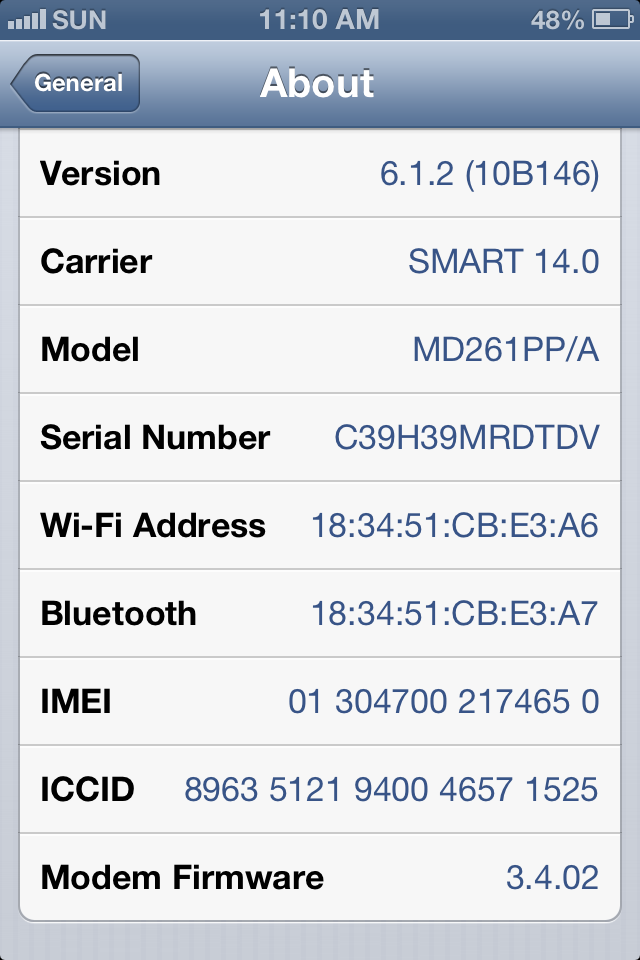

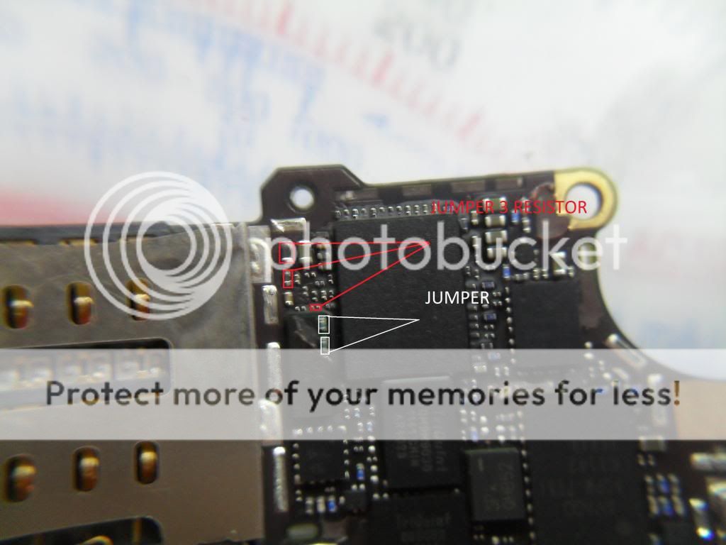

since not easy to replace this parts by using hot air. i try to jumper and it works
