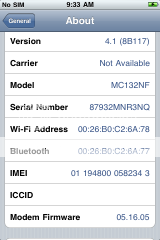

this MC model but safe po sya i downgrade kasi year 2009 at week 32 po..kaya no need to worry mga unlockers,
d kasi factory unlock kaya need talaga i update ang baseband nya pra magkasignal.
ito po ang version nya..
check the image,

yan na version 4.1 na kasu wala pang signal kasi 5.16 ang baseband

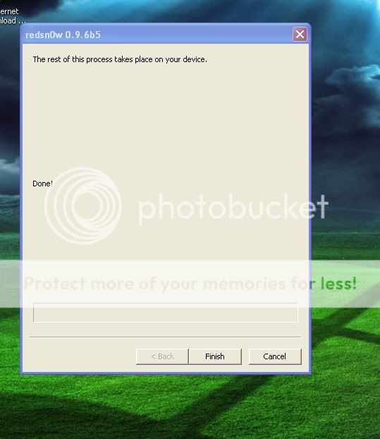

so update kuna baseband nya using redsnow.
after update baseband
finish na..check ko ang wifi bluetooth at baseband andyan pa,.ayus,.
