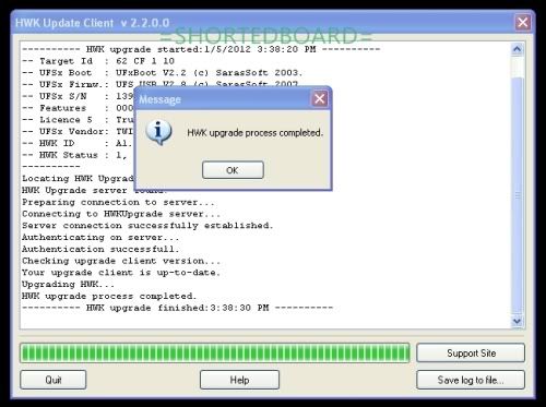

HWK CHip error 45 FIXED by AVATOR BOX
Here is the pin out guide. .
- Pinahinang ko sa kanya.
- Then after that sinaksak ko na sya sa avator.
- SET PINOUTS. From Avator SW, click PINOUT.
*Here is the step procedure on hwk repair ver 2.0.0
Quote:
- run "Avator!! HWK Repair.exe"
- Click on setting and do select setting as shown
"Avator!! HWK Repair ver 2.0.0 CONFIG" then press ok
- Select MSP430F11X1
- Click on erase
- Then open the file "AVATOR_REPAIR_HWK_3.08 HWL Flash File.bin" and click on prog
SEE SCREENSHOTS:
