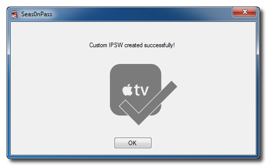

Seas0nPass will create a custom IPSW file for you.

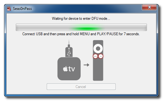

Once your custom IPSW file has been created, Seas0nPass will ask you to connect the Apple TV to your computer via a micro-USB cable and use the remote to put it into DFU mode by holding MENU and PLAY/PAUSE for 7 seconds. The power cable should be unplcrapcrapcraped during this process. Tip: Connect the usb cable and press the buttons down at the exact same time.

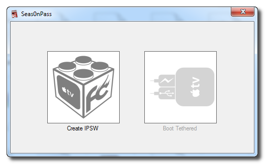

Step Three
Click the Create IPSW button from the main screen.

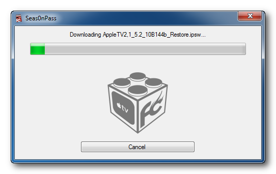

Step Four
Seas0nPass will now download the latest Apple TV firmware file

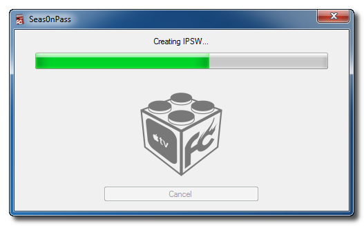

Step Five

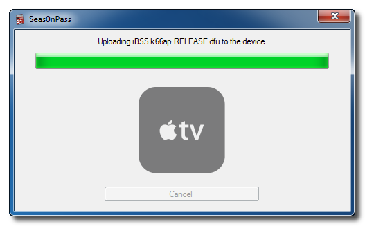

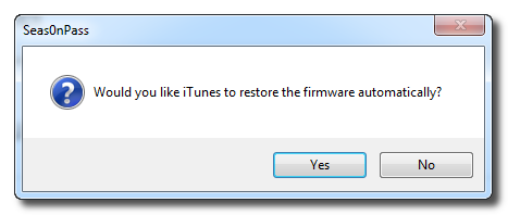

Step Seven
Once your Apple TV has been detected in DFU mode, Seas0nPass will upload some files, ask you if its okay to automatically restore firmware, and then beginning restoring to the new firmware.
