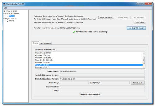

Step Three
Launch TinyUmbrella by double clicking its icon.
Step Four
Connect your device and make sure it lists saved SHSH Blobs for the firmware you are restoring to. You may need to click Save SHSH to restore your blobs from Cydia if you don't see any listed.
Step Five
Click the Start TSS Server button.
*Do not continue if TinyUmbrella's TSS server is not started successfully.

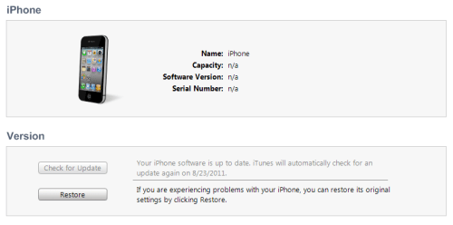

Step Seven
Select your iPhone from the list of devices on the left, hold down the Shift key and click Restore.

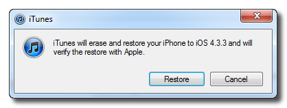

Step Eight
Navigate to the Pwnage folder on your desktop, select the ipsw file you downloaded and click the Open button.
Step Nine
iTunes will now restore to the lower firmware version.

Step Three
Step Four
Step Five

Step Seven
Step Eight
Step Nine
